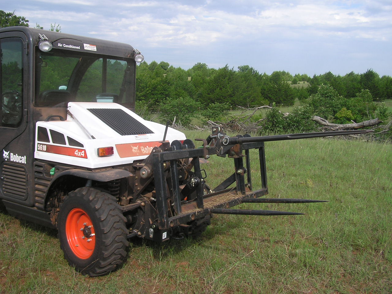

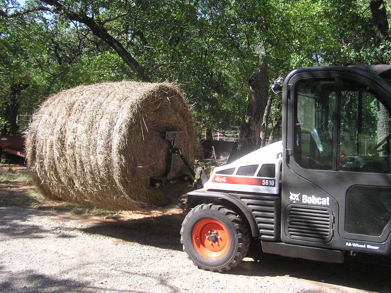

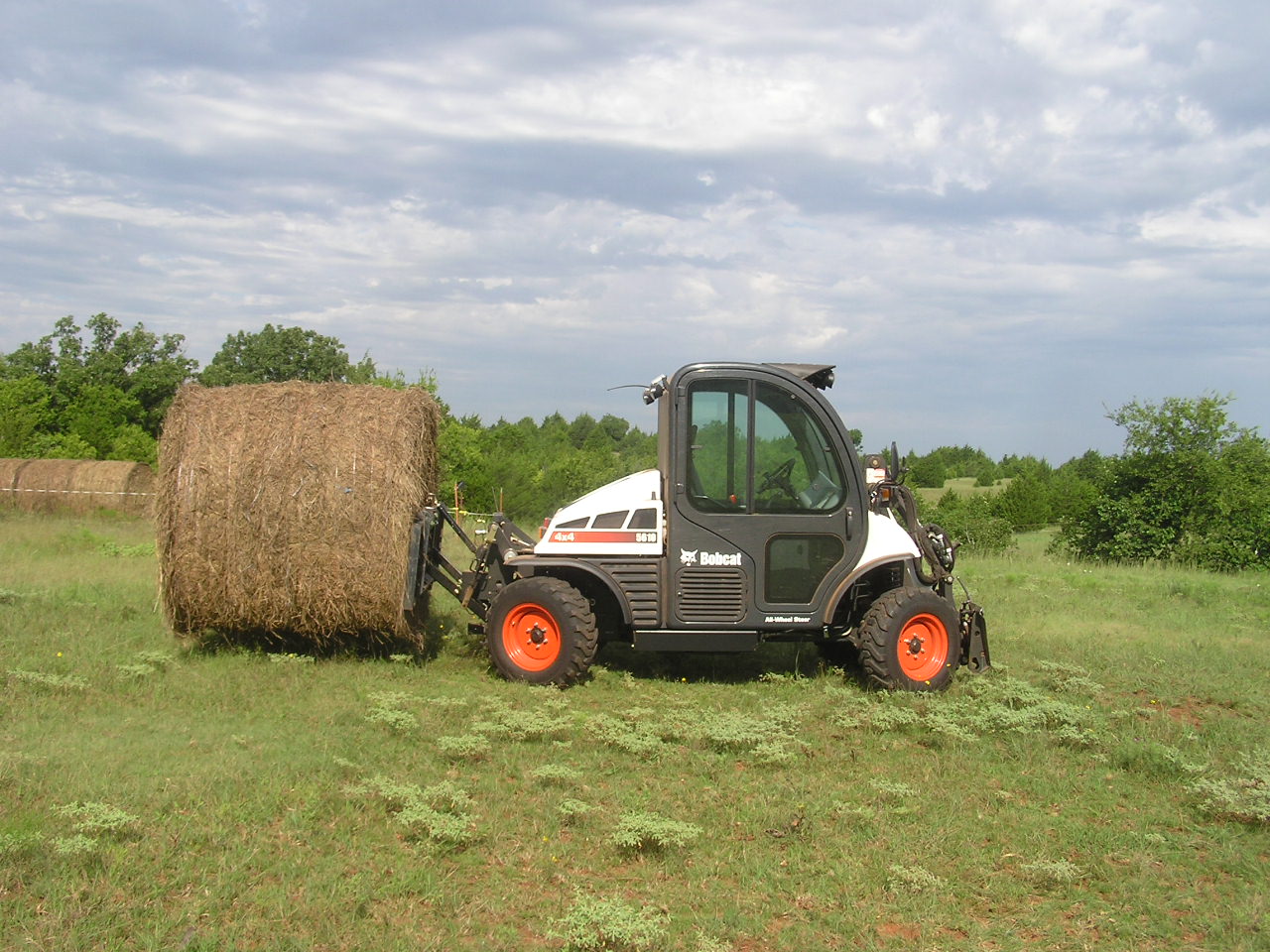

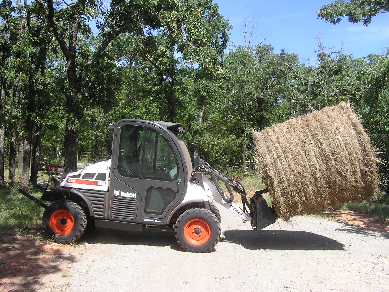

Aug 24, 2018 / Toolcat 5610 F and 5610 G Series Pictures Thread Starter #133 OP Xfaxman Super Star Member Joined Feb 8, 2013 Messages 13,286 Location Guthrie, OK Tractor Toolcat 5610 G - Bobcat V417 - TORO+Loader First time using the modified Speeco Ultra fork on the 3 point on the G Series: First time hauling two bales at once:

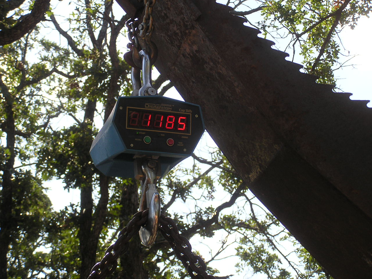

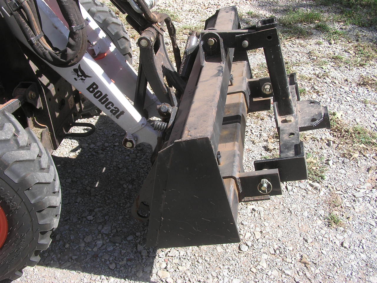

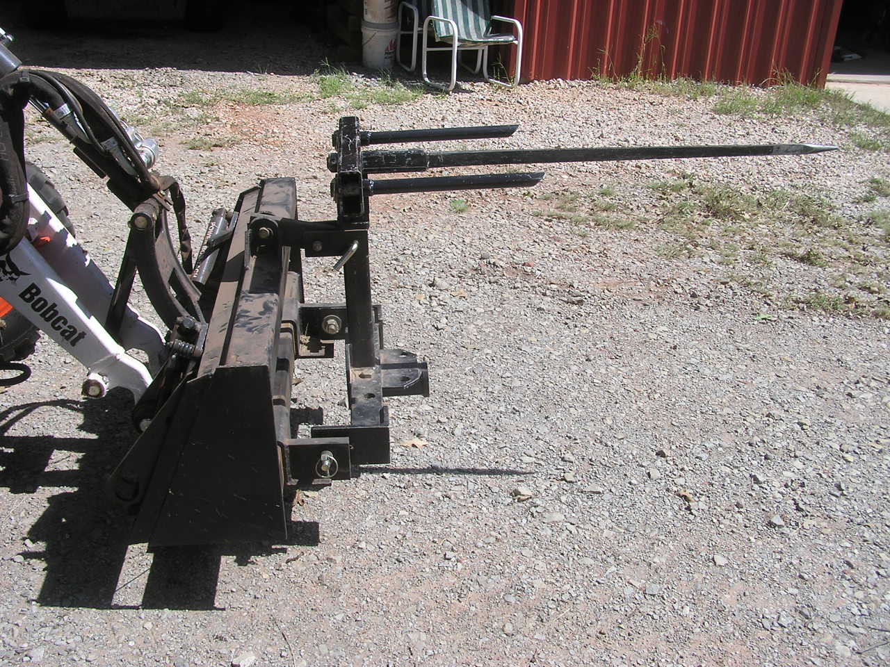

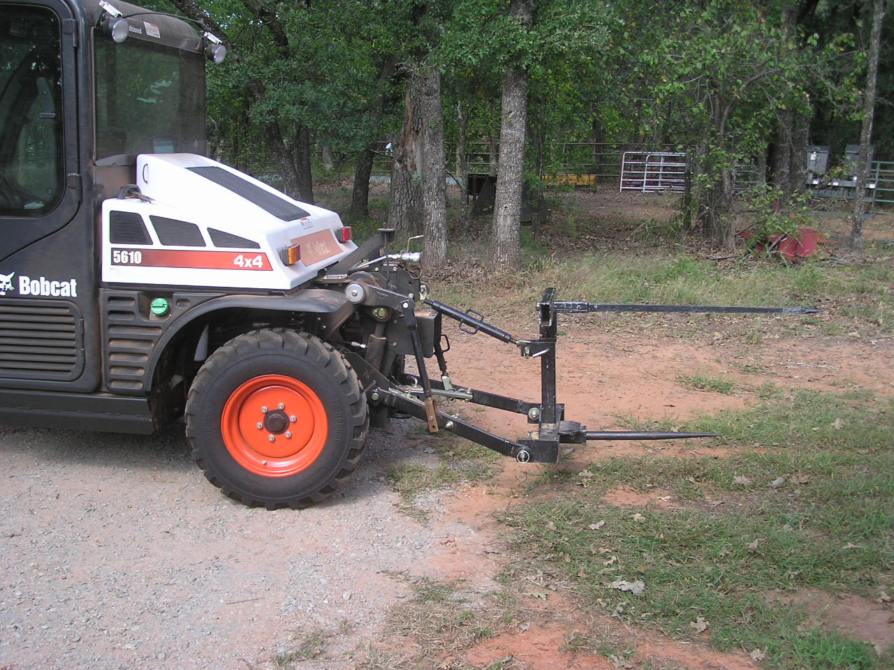

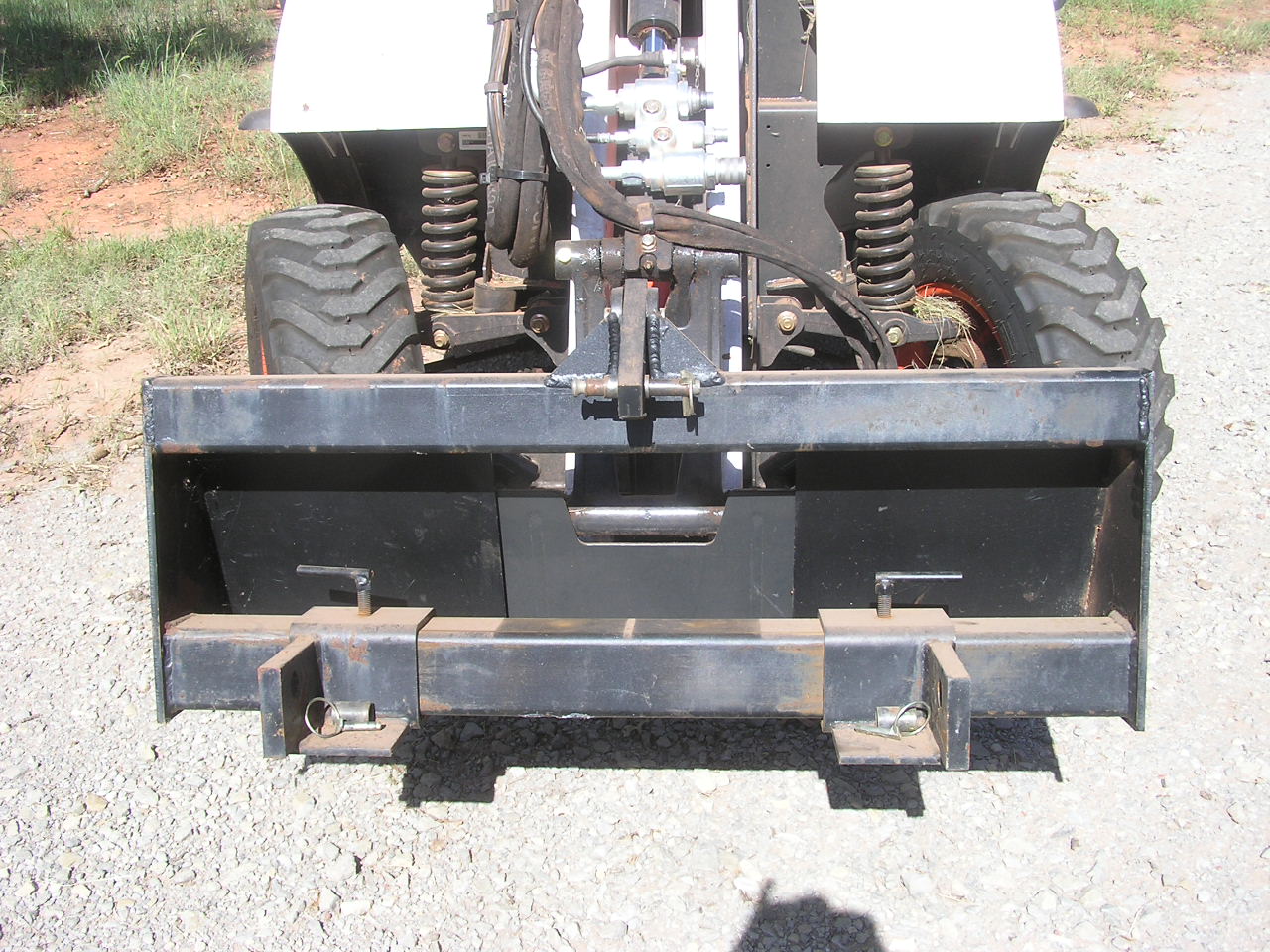

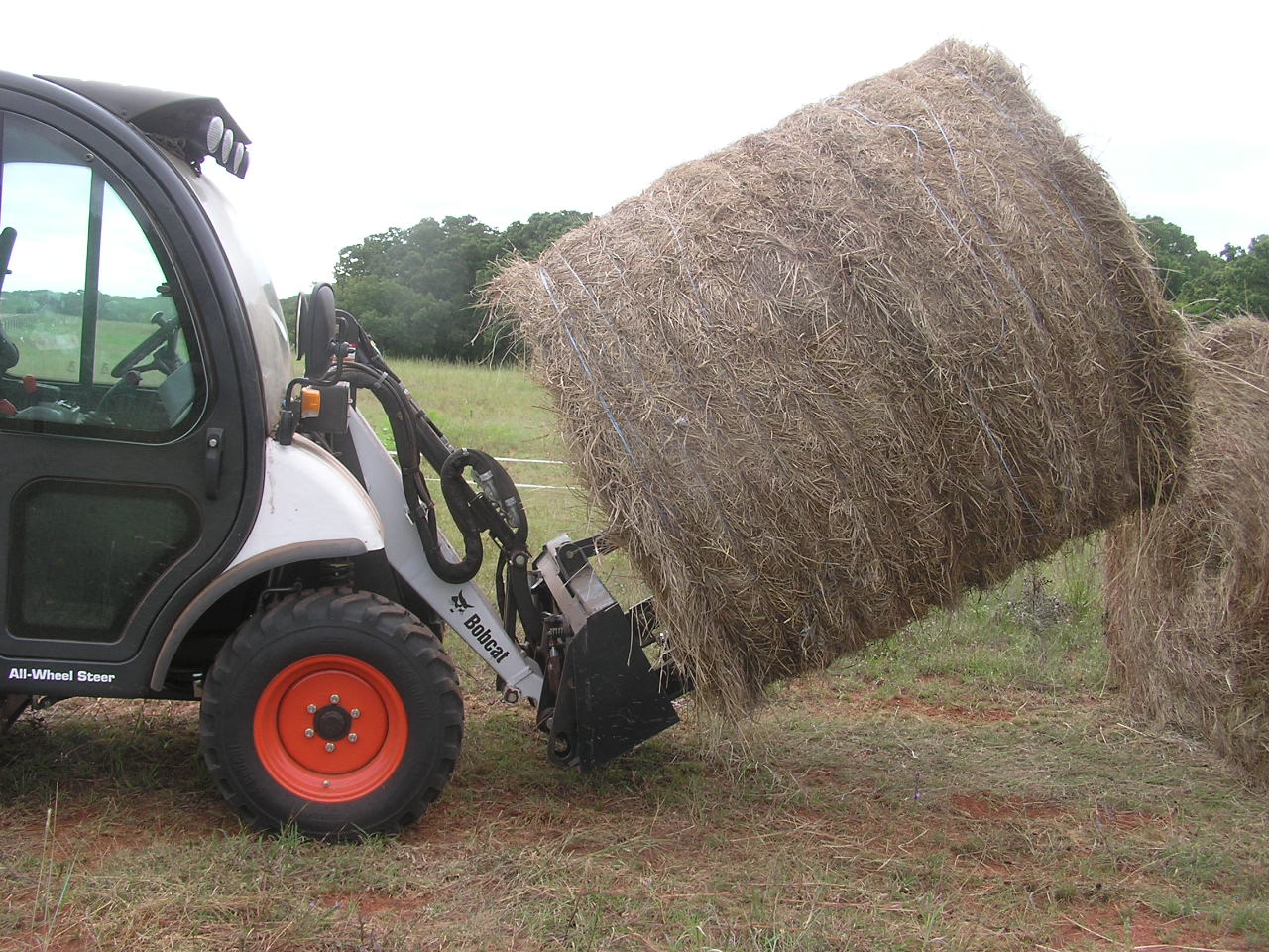

Aug 31, 2018 / Toolcat 5610 F and 5610 G Series Pictures Thread Starter #135 OP Xfaxman Super Star Member Joined Feb 8, 2013 Messages 13,286 Location Guthrie, OK Tractor Toolcat 5610 G - Bobcat V417 - TORO+Loader The guy we buy hay from still owed us two bales. He dropped one off this week, weighed it today: Going to try the bale spear that Omni MFG made for their Transformer 3 point receiver hitch: But I want it on the front, so got the SSQA to 3 point adapter: Put the Transformer hitch on it: Put the bale spear in the vertical receiver: Speared the bale: And took it to the bale storage area, but didn't take a picture. :ashamed: . Last edited: Sep 26, 2021

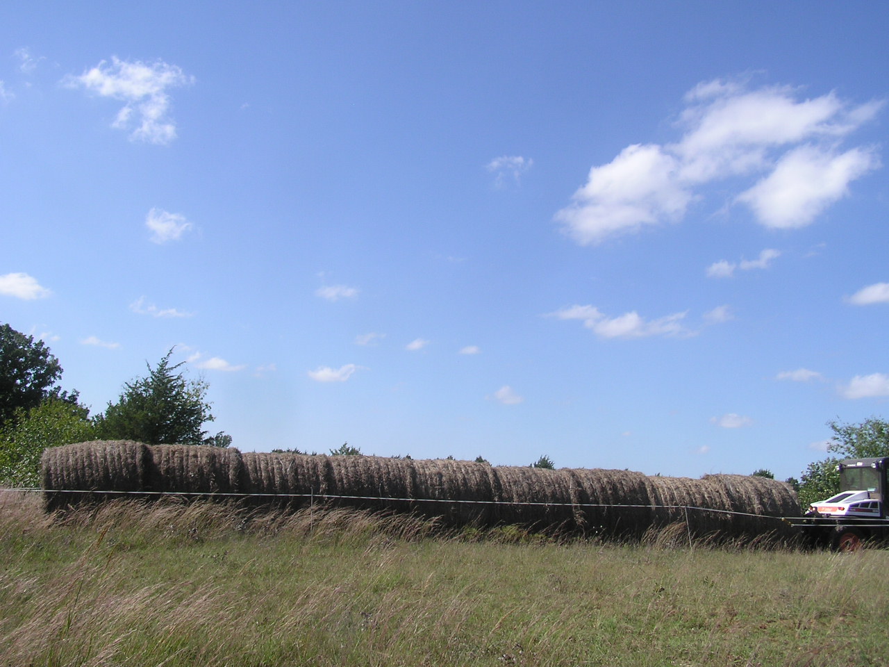

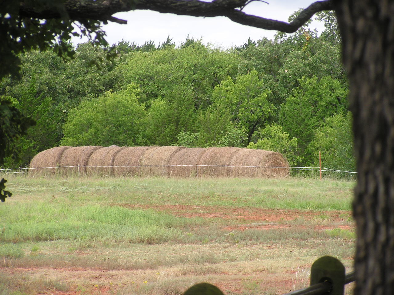

Sep 4, 2018 / Toolcat 5610 F and 5610 G Series Pictures Thread Starter #136 OP Xfaxman Super Star Member Joined Feb 8, 2013 Messages 13,286 Location Guthrie, OK Tractor Toolcat 5610 G - Bobcat V417 - TORO+Loader Took a picture to prove it happened. There are now 8 bales in the new row:

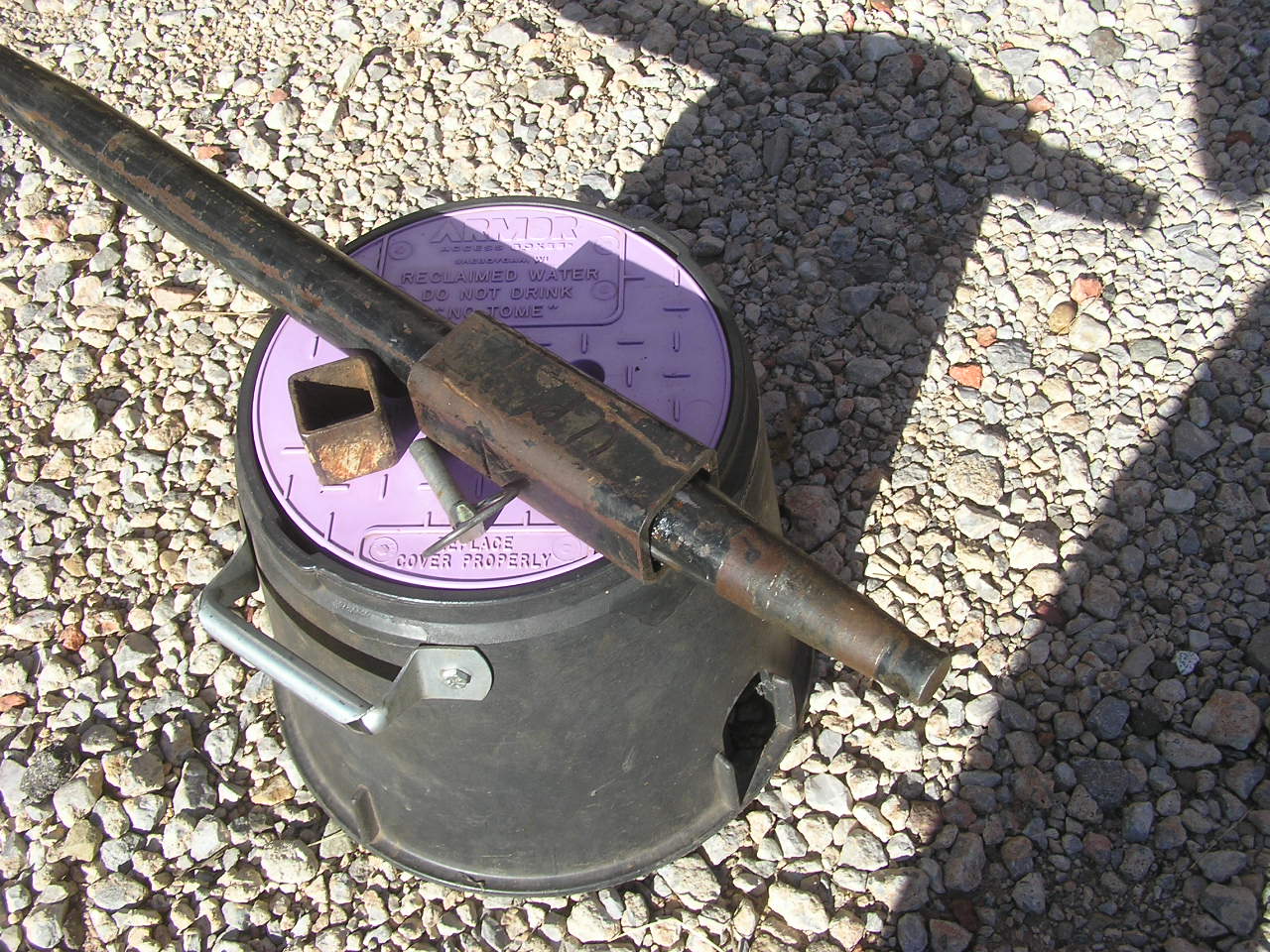

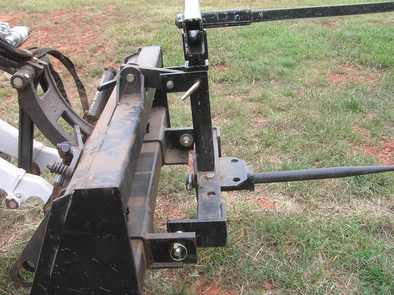

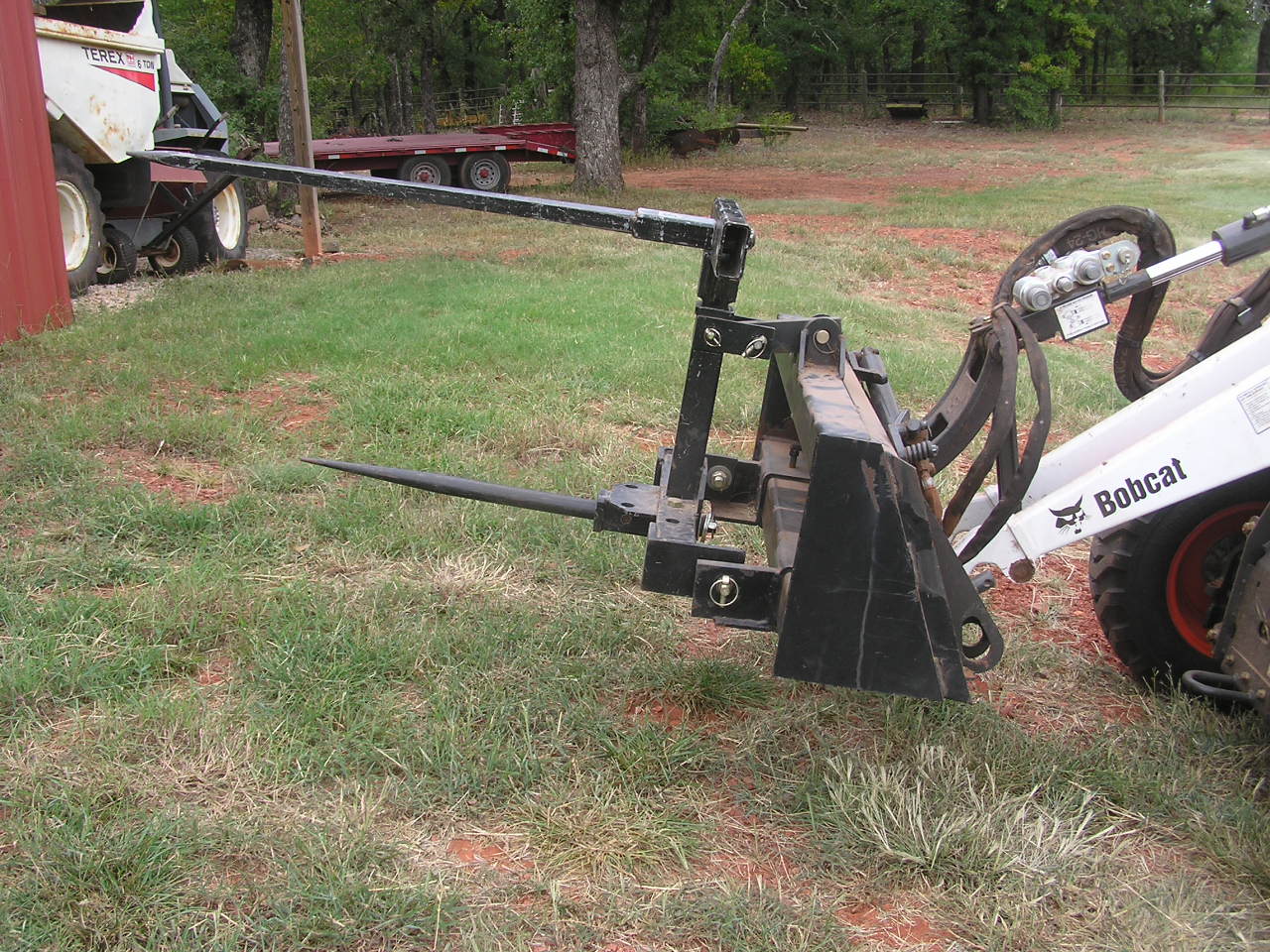

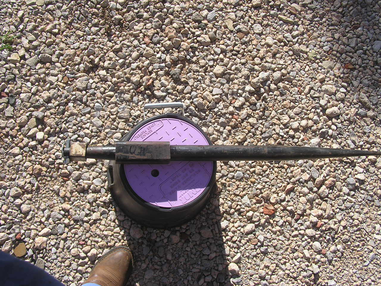

Sep 21, 2018 / Toolcat 5610 F and 5610 G Series Pictures Thread Starter #137 OP Xfaxman Super Star Member Joined Feb 8, 2013 Messages 13,286 Location Guthrie, OK Tractor Toolcat 5610 G - Bobcat V417 - TORO+Loader Subtitle: Modification to the Omni Bale Spear. This is the 48 inch spear in the vertical receiver on the 3 point hitch that I used in a previous post: The stabilizers are short and difficult to penetrate the bale, so I removed them. I had an extra 34 inch sharp pointed spear from the Speco UltraFork. I cut a piece of 2x2 thick wall square tubing, filed 4 flats on the round spear and used the press to slide it in place: Pinned it in place in the horizontal receiver hitch: Works good, like a modified bale spear should: :thumbsup: Of course it works in the 3 point, so I can carry 2 bales at the same time. .

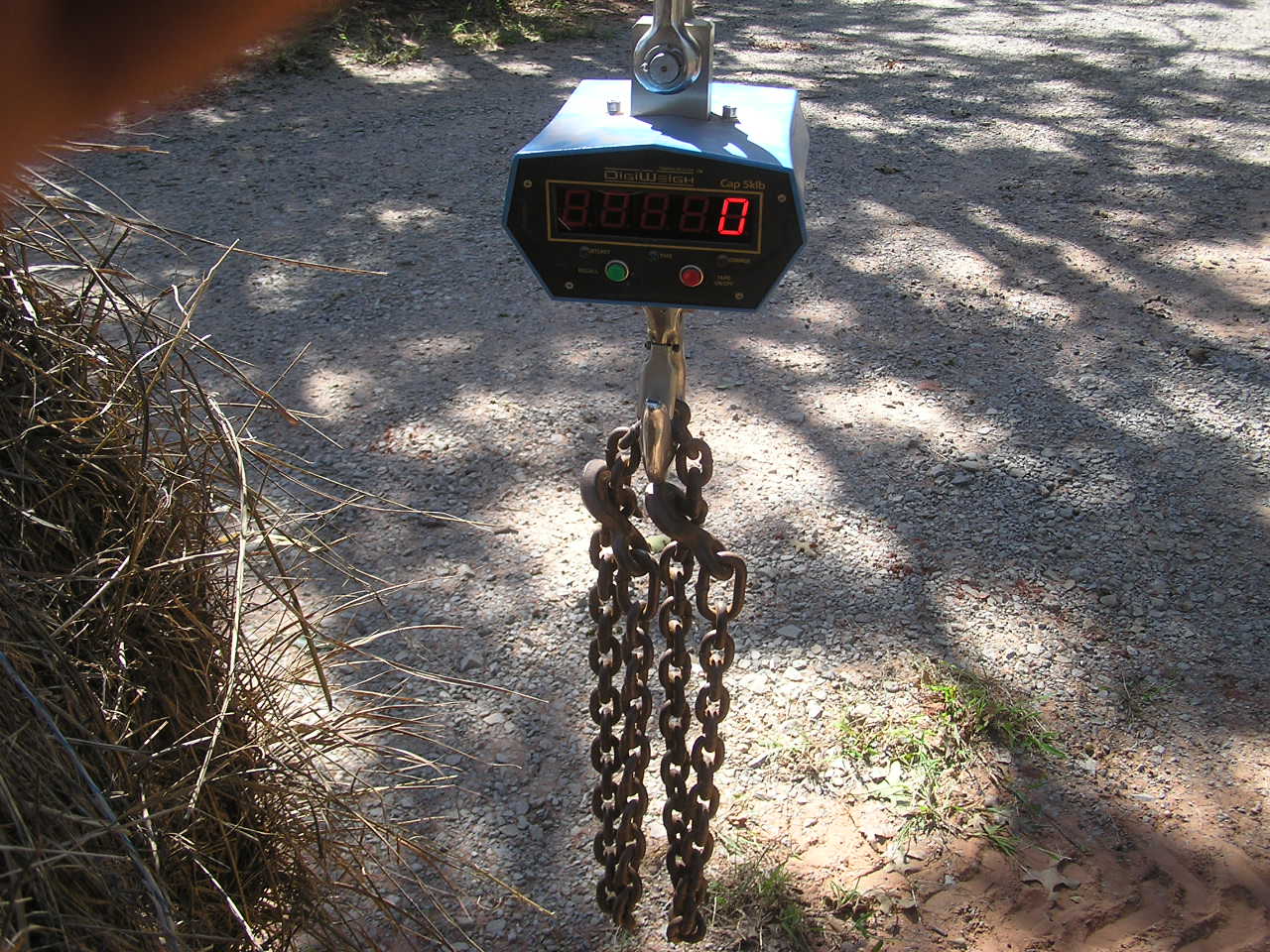

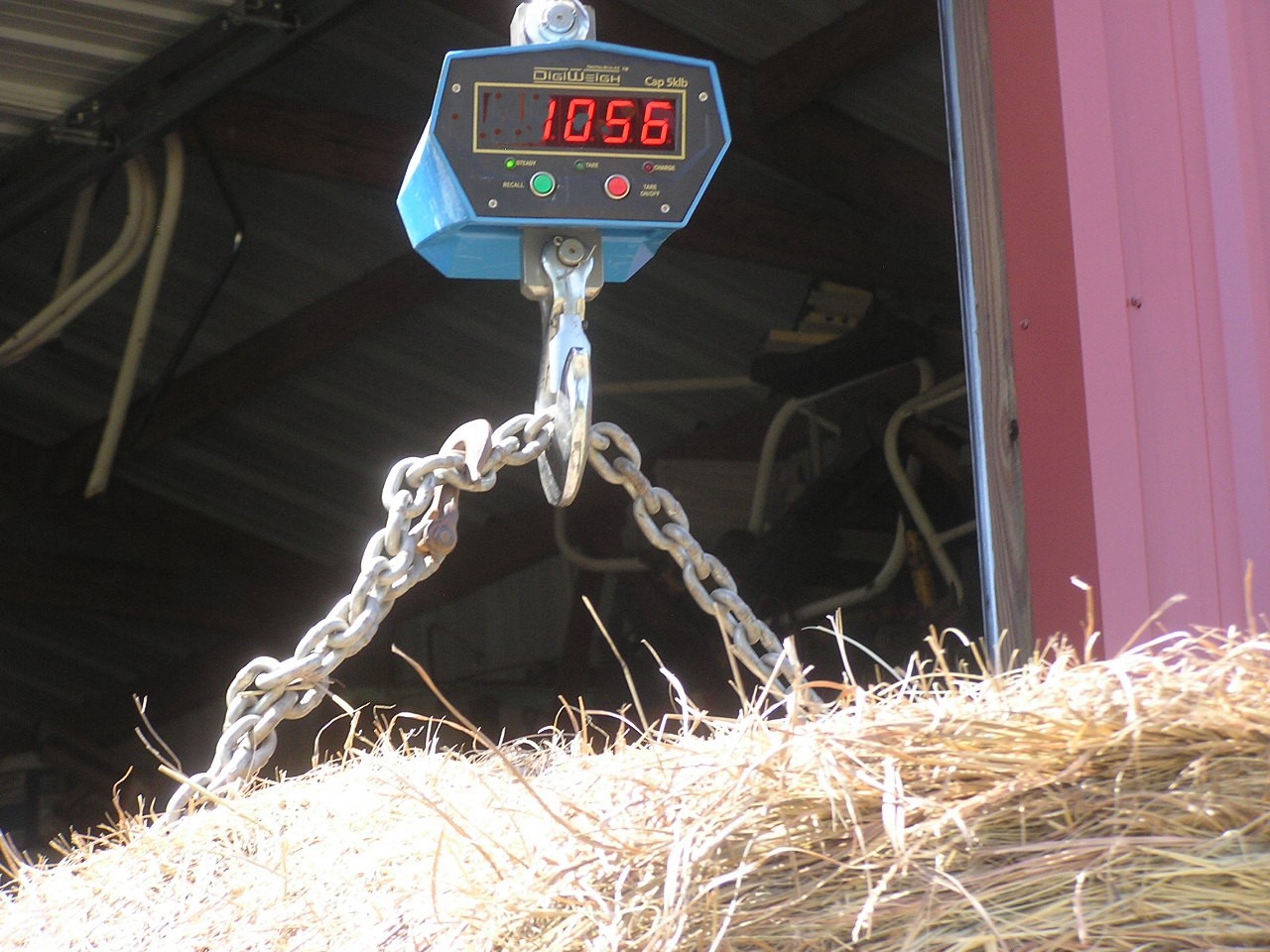

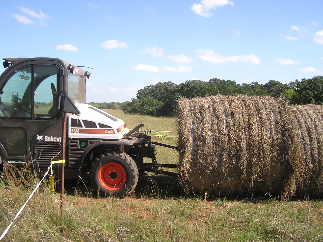

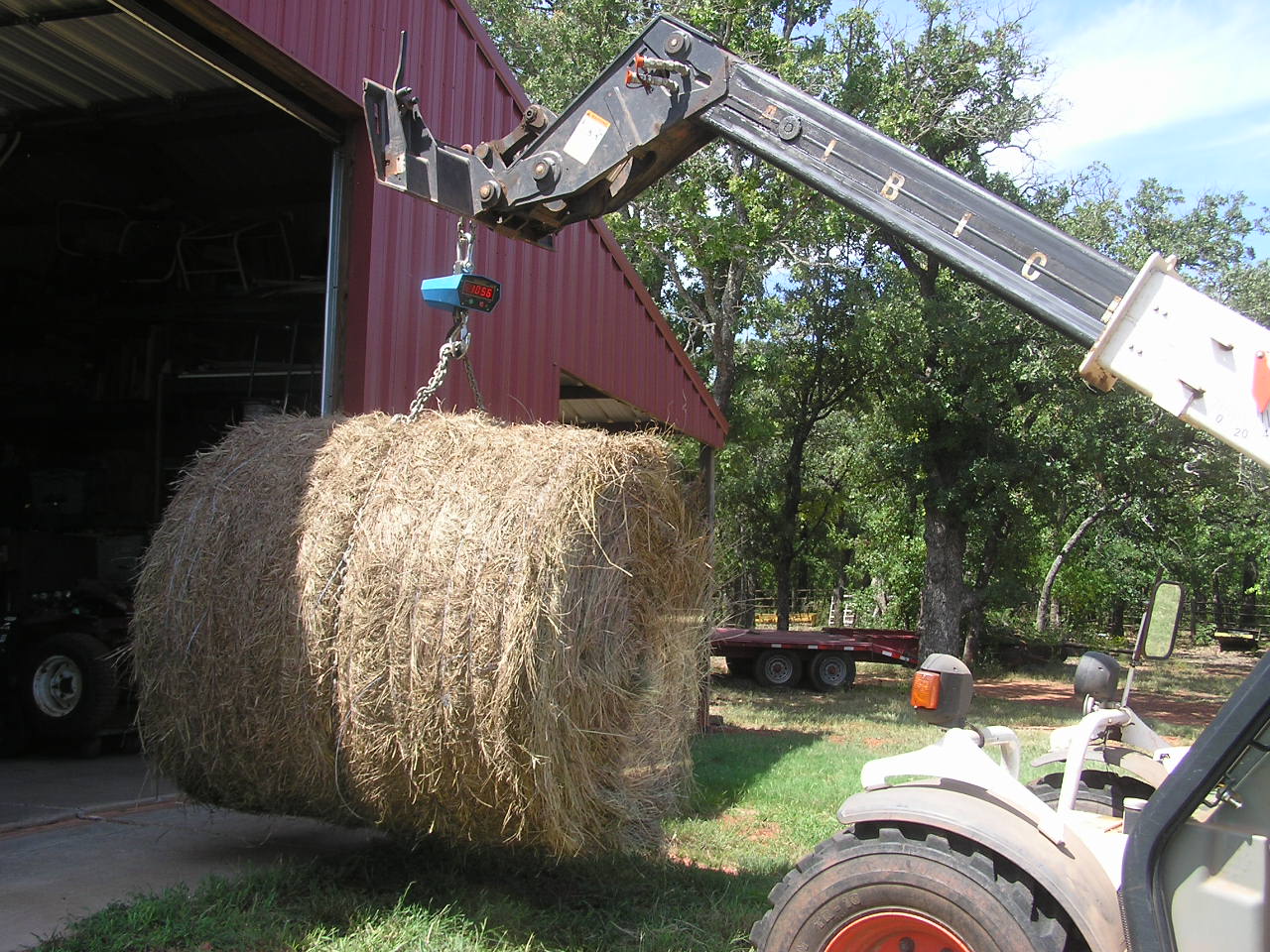

Oct 3, 2018 / Toolcat 5610 F and 5610 G Series Pictures Thread Starter #138 OP Xfaxman Super Star Member Joined Feb 8, 2013 Messages 13,286 Location Guthrie, OK Tractor Toolcat 5610 G - Bobcat V417 - TORO+Loader As mentioned in the previous post, "it works in the 3 point". Here is proof: Hung the crane scale on the stump bucket, zeroed the scale with the chain on it and weighed the bale: Then took it to the bale storage area: There are now 9 bales in the new row:

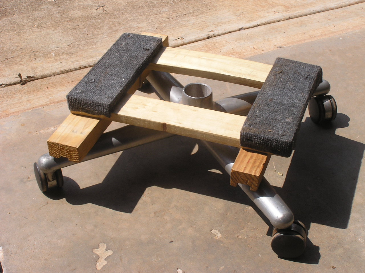

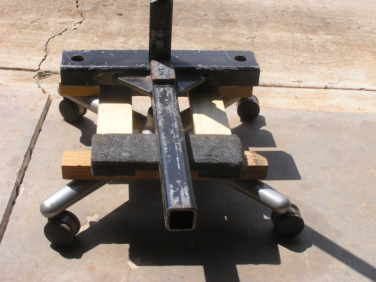

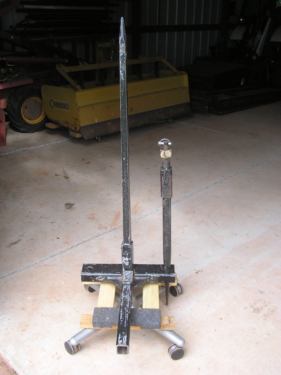

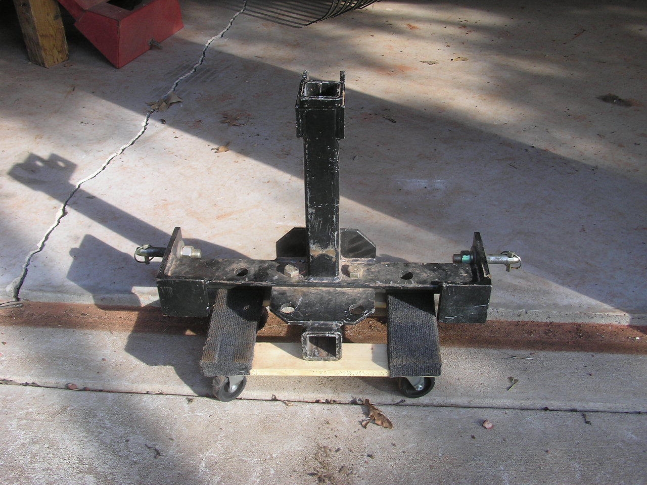

Oct 21, 2018 / Toolcat 5610 F and 5610 G Series Pictures Thread Starter #139 OP Xfaxman Super Star Member Joined Feb 8, 2013 Messages 13,286 Location Guthrie, OK Tractor Toolcat 5610 G - Bobcat V417 - TORO+Loader Posting pictures of the dollies for the modified Omni MFG. bale spear that fits on the Omni Transformer 3 point hitch: The spears set on a mini furniture dolly with the casters stolen for a bigger dolly, two 2 by scraps and an old office chair base : The Speeco spear clears the floor :thumbsup: .

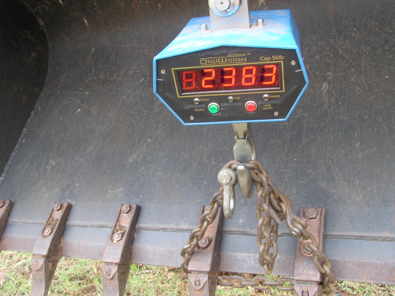

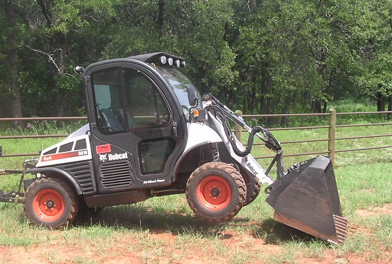

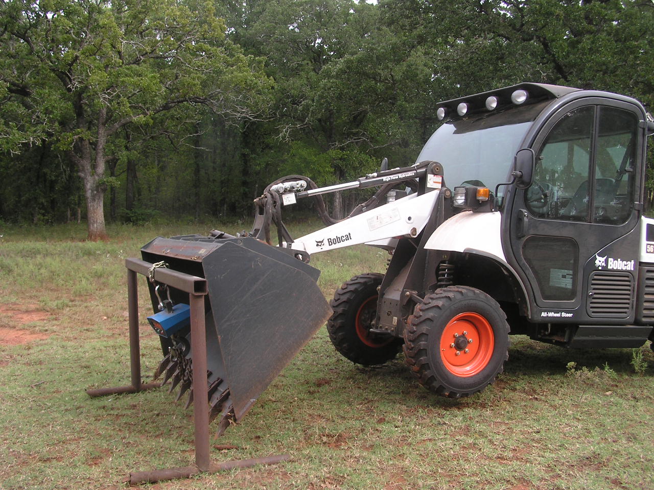

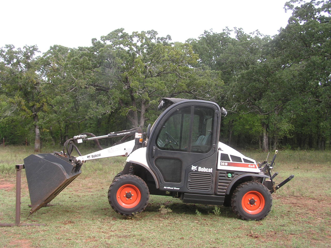

Oct 24, 2018 / Toolcat 5610 F and 5610 G Series Pictures Thread Starter #140 OP Xfaxman Super Star Member Joined Feb 8, 2013 Messages 13,286 Location Guthrie, OK Tractor Toolcat 5610 G - Bobcat V417 - TORO+Loader The question of how much pressure is on the bucket teeth came up on another thread. So I decided to find out: 2,383 pounds, not as much as I expected since the bucket weighs a little over 800 pounds and the Toolcat weight according to Bobcat is 5835 pounds.
