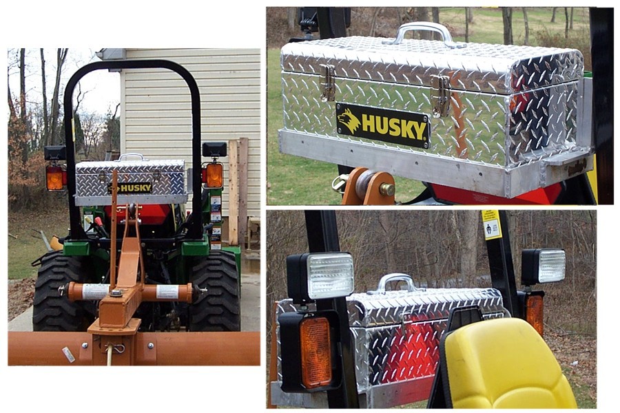

Been working on this project for a few weeks - fits and starts.
My neighbor is helping with the welding, fabrication, and hashing out of ideas.
The toolbox is mounted to 1 1/2 in aluminum angle. This was a bit of pain to mount. The 4100 does not have much room to mount a toolbox. I was going to use a 50 cal ammo box hanging off the side, but saw this husky box and couldn't resist. I want to carry chains, pins, some wrenches to make field adjustments, gloves, etc, etc, so it should suit my needs. I bought the JD brushguard kit and lights. They are 50 watt trapozoidal so I should have plenty of light. Next is to fabricate a bracket for the implement light and then finish off the switches and wiring.
Terry
Has anyone with a 4100 attached any extra lights? Where's a good place to tap into? There are two plastic connectors and they are tied into the headlights. Sounds like a dumb question, but is that the best place??

With that box on the back, how do you see what you are doing when using the rear blade? Hopefully it is no problem, but the box looks like it is in the direct line of sight for the operator in the tractor seat. The box looks great.

Love the looks of that deck plate toolbox. /w3tcompact/icons/cool.gif Can't quite see how the whole thing is attached to the tractor/ROPS. Howdja do it? Nice professional job on the lights, too.
Pardon my welding ignorance, but I know you can weld aluminum with a TIG unit -- can you do the same with MIG? Never thought to ask before. /w3tcompact/icons/crazy.gif

I too once had a tool box mounted in a similar position. The tool box was smaller in size and mounted lower, but the box was still partly blocking my view of any 3pt mounted equipment. Ended up removing it from that position. By the way, that does look like a professional job.

Yes, I'm a little concerned about losing sight of the rear implement. I've been thinking and rethinking and kicking ideas around for several months before deciding on this solution.

I believe my neighbor used a TIG welder. Uses separate welding aluminum rods with a tip that uses a gas - can't remember what kind exactly. John, my neighbor, works for an aircraft company and they design, fabricate, and repair aircraft systems. So, he is used to working with all of these different materials. He has five garage bays and has tons of machine tools.
As far as the lights, the JD brush guards fit any JD compact model, I believe. JD was kind enough to drill holes on the top side of the brush guard for the extra lights.
What John and I did, was to design the toolbox mounting bracket so that it would take advantage of the two bolts that hold on the warning lights. The bolts are long enough to hold the bracket, the brush guards, and of couse the lights.

Will there be a problem with hiding the SMV sign?

I'm mulling over how to display the SMV. Sounds like a job for some strong magnets.
If there was one complaint that I have about the 4100, it's the lack of space to put a decent toolbox. Make's me crazy to have to run to the house or shed to get tools, chains, clevis', or whatever.

Very nice job Terry... the only issue I would have is rear visibility... but it looks like you can "pop" the box out of it's holder if it becomes a major issue...

In fact, I was going to screw or rivet it in to the bracket, but now I think I'll use pins. Voila!! /w3tcompact/icons/cool.gif
