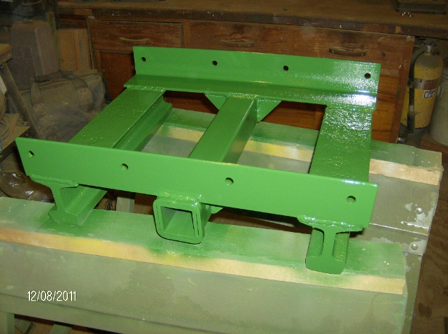

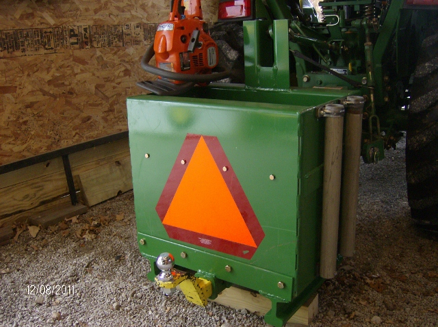

   / Tool rack ideas #5

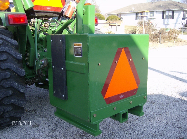

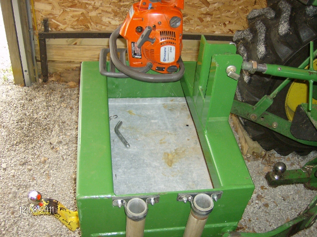

I use plastic conduit on the outside of my weight box, plastic chainsaw sleeve on the other side & a metal tray inside for smaller tools & chains. Weight box has scrap iron in it & RR rail legs for a total of over 600#. ~~ grnspot
I've currently got 2/3 Of an oil drum with a drawbar through it filled with a mixture of scrap steel and concrete. Unfortunately it's difficult to get a solid connection to it, due in part to its shape and the thin metal. I guess I could always drill it and put some tapcon studs in it to bolt to, as long as I don't run my bit into any steel. I may just have to buy a spanky new official box to start fresh;-)
