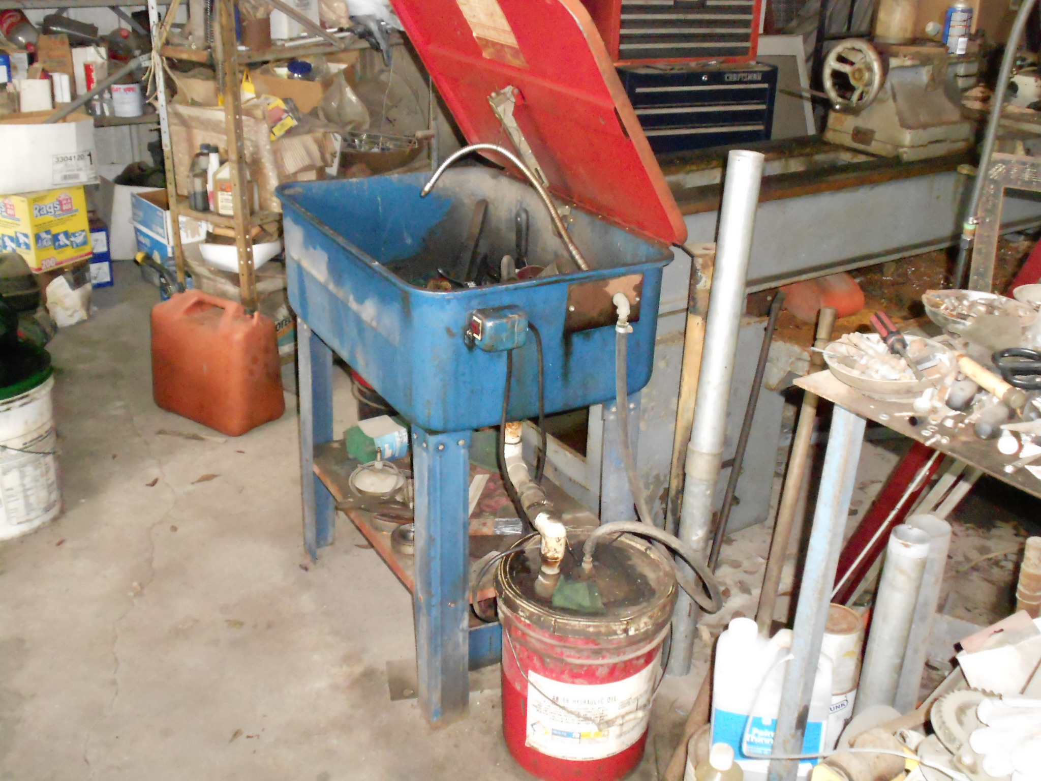

I bought the cheapo HF washer that just circulates the fluid in the basin.
I brazed a fitting in the bottom and plumbed drain to the side into a 5 gal. bucket. (must use hyd oil or grease bucket with lid that has gasket)
I mounted the pump to the bucket lid off of the bottom of the bucket and ran wires to original washer switch and hose to original fluid sprayer mounted to side of basin.
I run mineral spirits in it and get by filling it with 3 gallons. (about $10. a gal)
Turn on pump, fluid comes out and drains back into bucket. Crud settles out in bottom of bucket.
I can get 2-3 months out of a fill with regular every other day average use.

Good ideal!!! Thanks! I think my parts washer pump would fit in the bottom of a 5gal bucket. Shouldnt be hard to rig up a return drain from the plumbing section of the hardware store. No more than I use the washer, a bucket of spirits should last a pretty long time.
/ Tool question (Parts washer) #15
On a parts washer the pump is the important part. I made my own cabinet out of steel and bought a good, little giant HD washer pump. Then I added LocLine for the spray nozzle. It works well. As to fluid, Mineral spirits is what I use.

I got around to taking pics today. This parts washer is at least 20 years old.
I did have to replace the pump a few years ago. I bought on at Northern Tool, $29.00 IIRC.
