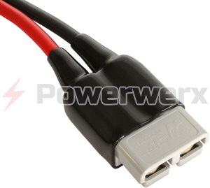

If I had to take out the battery frequently without tools, I’d install Powerpole connectors on the cables.
