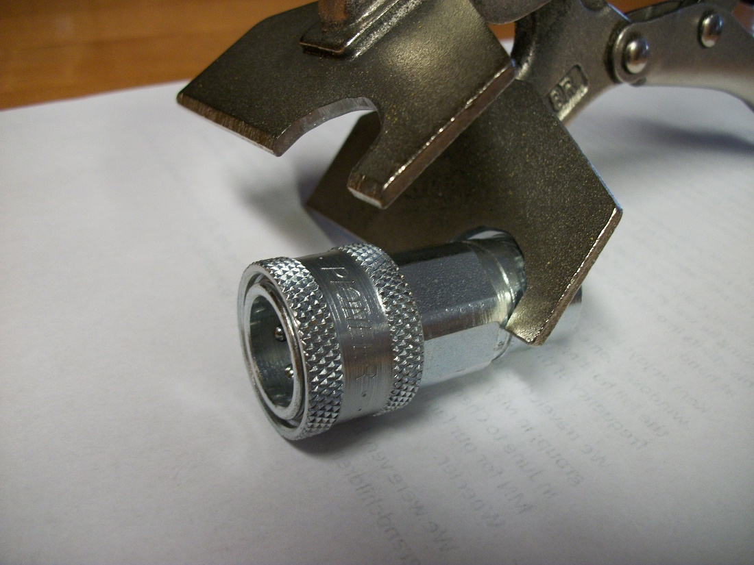

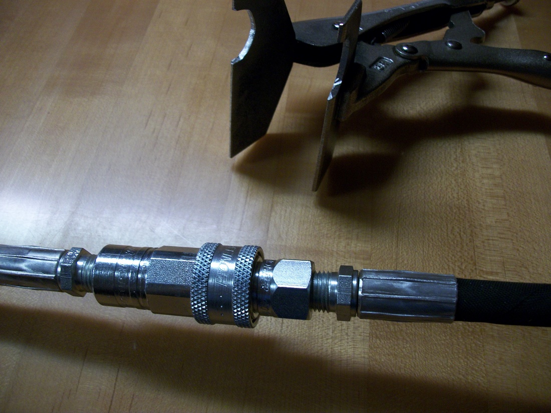

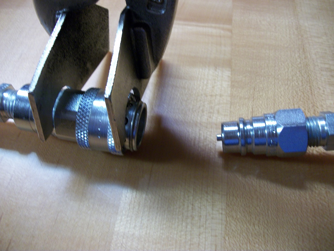

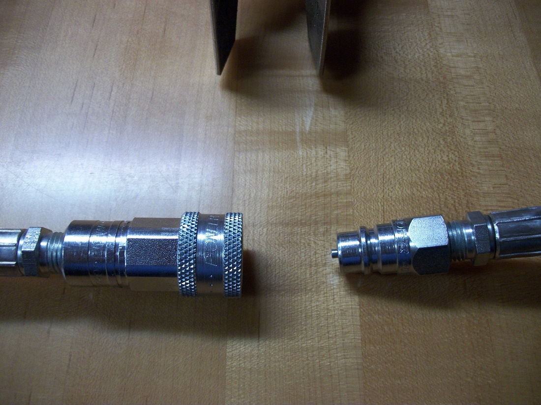

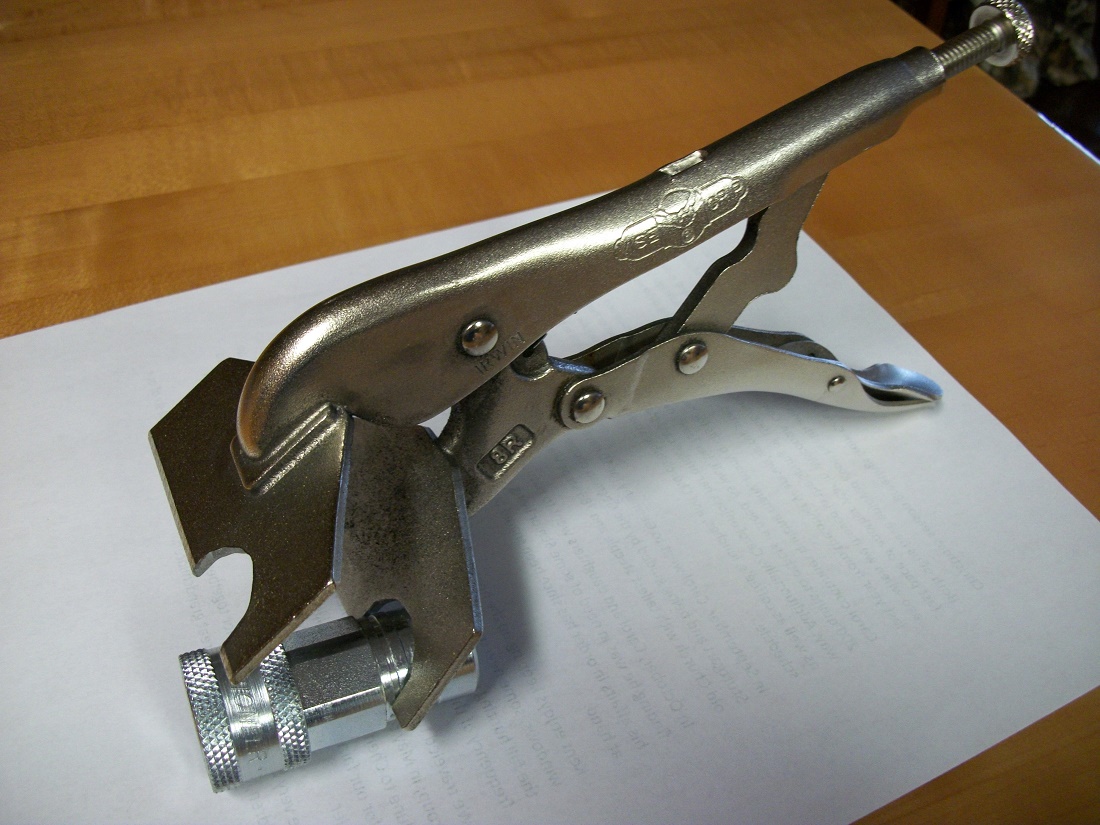

Have modified a ViceGrip pliers (model 8R) to aid in sliding female coupler sleeve back for ease of engaging male component.
With unsecured couplings on dual hoses running from rear 3rd SCV to grapple thumb on FEL forks, difficult to slide the sleeve back while pushing the male into the female coupling.
Decided to try modifying the VG pliers designed with flats for sheet metal work, by filing out the flats to just fit the female coupling so closing the pliers to "lock" allows holding it in the open position to engage the male end. This fits the 1/4" Pioneer coupling.

Sometimes I have a difficult time connecting the two because of too much pressure in the lines. I know I have seen a tool to press the end button to release the pressure too. Good job making a tool to help your work go easier.

Besides relieving pressure, make sure you are using your other hand to push in on the male end as you squeeze the pliers.

I've not found a tool to press in on that end button, but have wondered about making something. Presently I have a dummy female connector that I leave on the male coupling of one of the FEL loader lines. It has a plug in the hose end that I can loosen if there is pressure in the line (and usually is the case in the spring after the FEL sits over the winter while the snowplow is in its place).
But now you've given me the thought that the other side of this ViceGrip tool maybe be able to use that tool to also release pressure. Will look into that.. prolly today yet.. :)

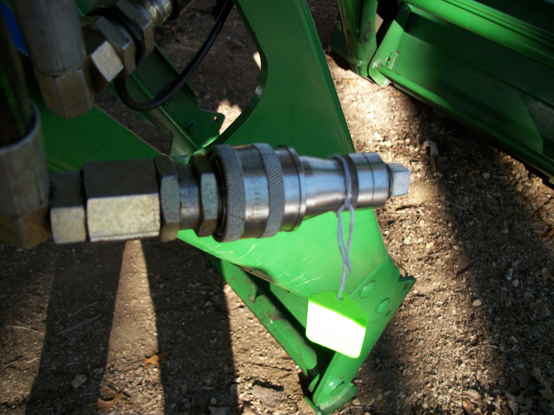

Here is a pic of the one I hang on my FEL while it is in storage.. then just back off the plug and be wary of oil coming out at the moment..

I just tap the ball with a piece of wood. I've had to use a dowel or unsharpened pencil a couple of times for the one in the female coupler.

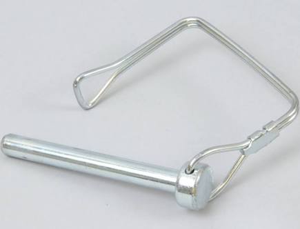

Always one around, hangs nicely on the tractor doesn't cause damage... Like a screwdriver would.
Wrap it in a rag, push it or tap if necessary.

Like others, I just take a flat punch, or a piece of wood, stick it agains the ball, wrap a rag around it to control and splash that may occur, and hit it with a hammer. A drop or two of oil will come out, and that's all it takes to relieve the pressure. Works on both male and female connectors.

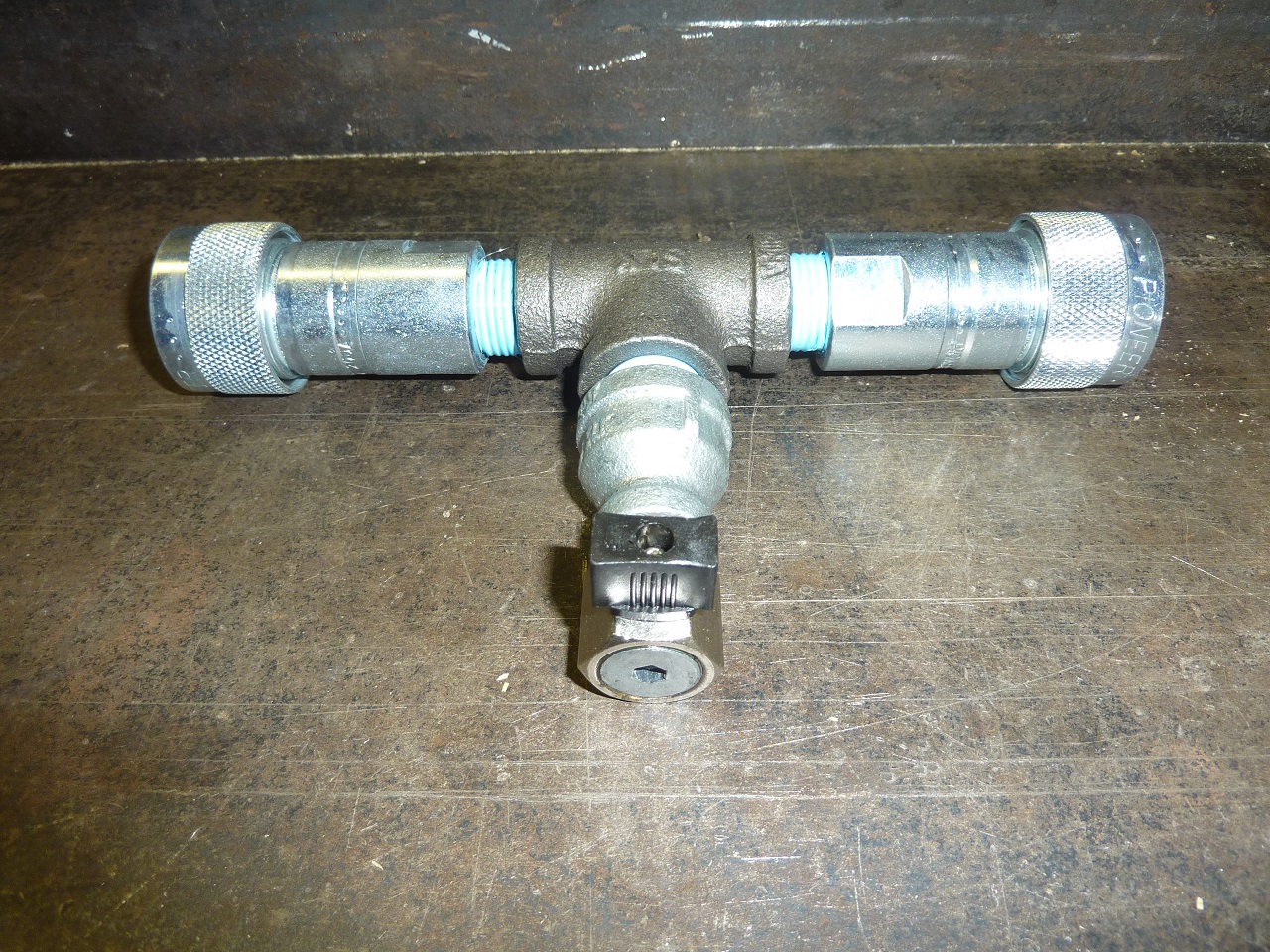

I use a simple manifold for all my hydraulic implements.
Any built up pressure is relieved by using the valve to drain excess oil into a container
