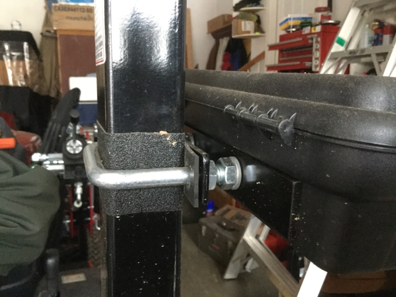

I attached a small tool box to the ROPS using a square U-bolt from tractor supply
That right there may be so simple that I never thought of it. I take it that you have no issues with it being in the way of anything?
   / Tool box on new 2538? #4
It's a small box mounted on the right side so it's out of the way. I was considering to an ammo can painted to match tractor but went with the plastic box because it held all the items i needed. It doesn't interfere with using backhoe. By using the clamp I avoided drilling holes in the ROPS.
Appears it is mounted above the rops pivot point?
   / Tool box on new 2538? #6
It's mounted below the pivot point

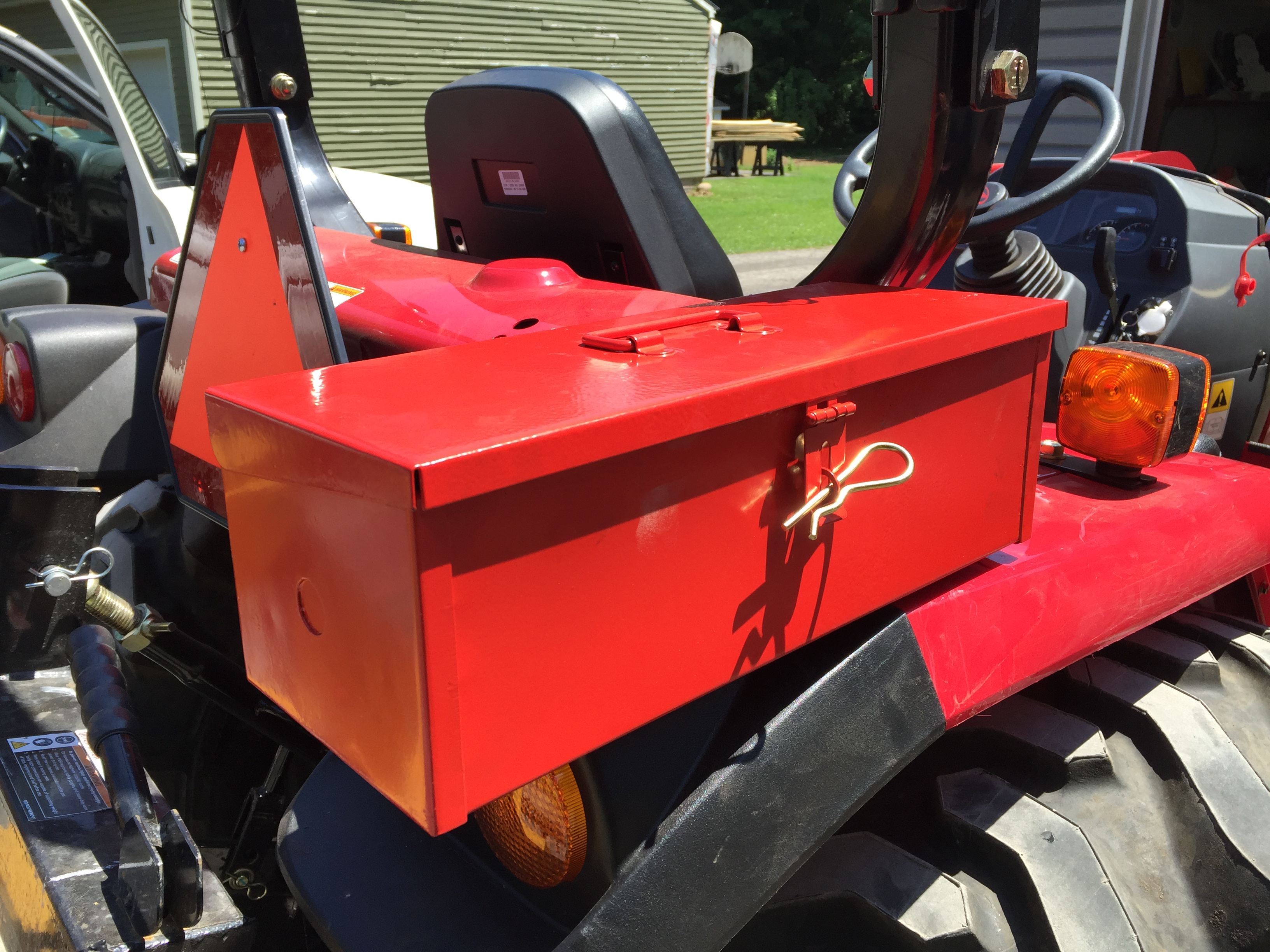

Picked up a small steel tool box at runnings today for I think it was 17 bucks. Bolted it to the two fender mounts and let it rest on the plastic of the fender. Have to see how it works out.IMG_5693.JPG
