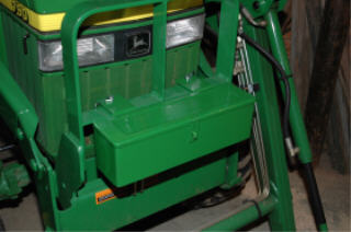

Hi All
I took a look at the front of the 790 as suggested by BTDT. I have a loader on it with a brush guard. I have the tool box mounted on the brush guard . It worked out real well.

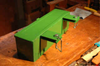

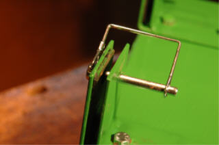

Hi All
As I said in my last post I have the toolbox mounted on my JD790.
I made a couple of simple brackets that will allow removal of the box when wanting to service the front end of the tractor. Also it allows taking the whole tool box off to take it to where you are working.
My 790 has the brush guard on front, part of the 419 loader package. The brackets slip over the center crossmember and the box is locked in place with a couple of 5/16 " implement pins. I epoxied a peice of 1/8" Rubber inside the brackets to keep the box from bouncing.
Hopefully these pictures will post.
Thanks to all who contributed to this project. I like this site.
Ray

   / Tool Box on John Deere 790 #17
Some rubber might be a good idea to put 'tween the mounting brackets to keep paint scuffing to a minimum.
David from jax
#18
Thanks David
I took your advice and epoxied a second peice of rubber inside the bracket.
After I did that I had a thought that perhaps moisture could now be wicked in between the rubber and the cross member and possibly could damage the paint. What do you think?
Ray
