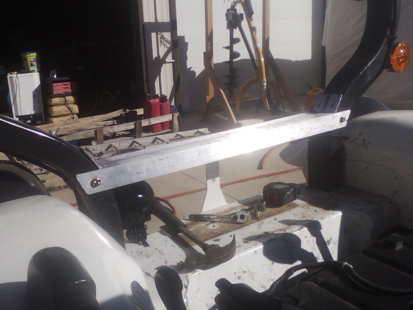

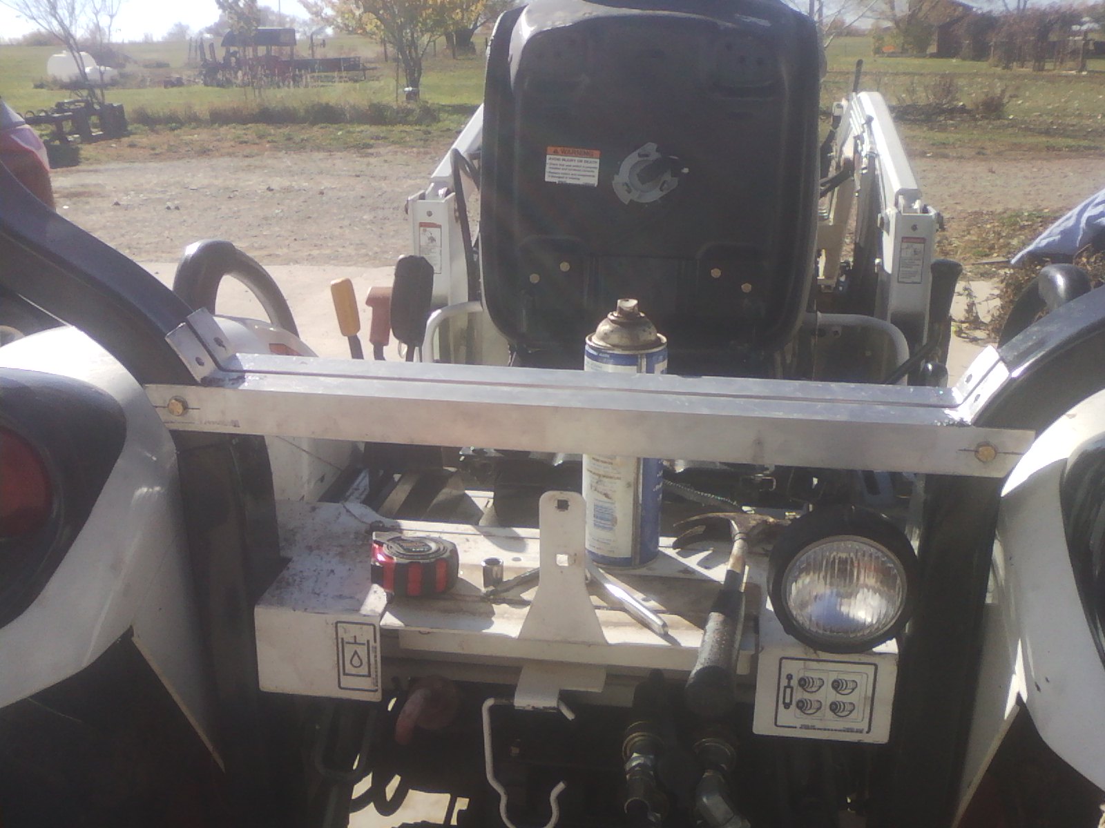

Well plan B

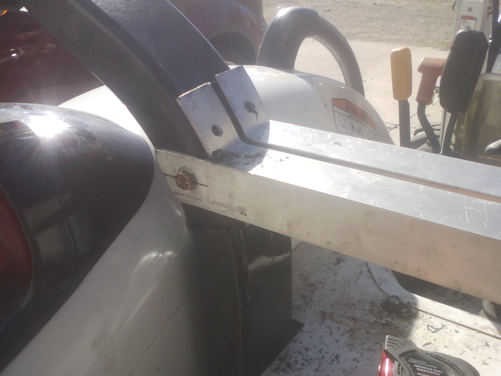

I got some 1.5 inch aluminum angle iron and fabricated up mounting brackets for the can. I set them high enough so I could still use the original small tool box for little things like key storage and such. Got them rough fit today on each side of the ROPS. I drilled and tapped 5/16 holes into the ROPS and will be using grade 8 hardware (what I had on hand). I will be painting the cross pieces white (also what I had on hand). I decided to split and bend the top of the angle to get a better connection on the ROPS. I also left room to get at the light switch.
After the rough fit I decided to get another tool box - a little longer and not quite as tall. Don't tell the BOSS unit. :eek::eek::eek::D Wall-mart carried the perfect size for my needs. Having it shipped free to my local store or the Zoo as I call it. I will add seals to make it water tight, but it should be pretty good as is. https://www.walmart.com/ip/Stack-On-19-Hip-Roof-Tool-Box-2-Pack/14958228
Photos of the rough fit;

   / Tool Box for CT 235 - 40MM ammo Can? #13
Bracket looks great so far, and box will be much better supported there

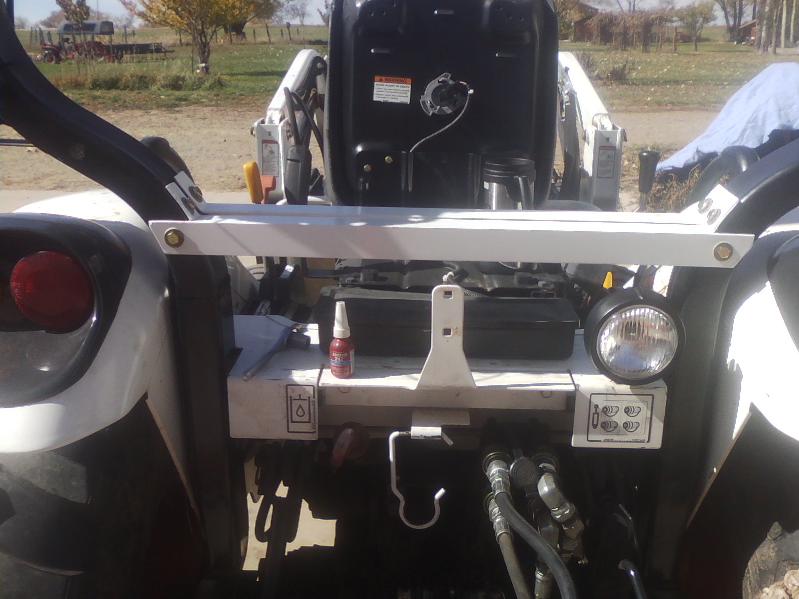

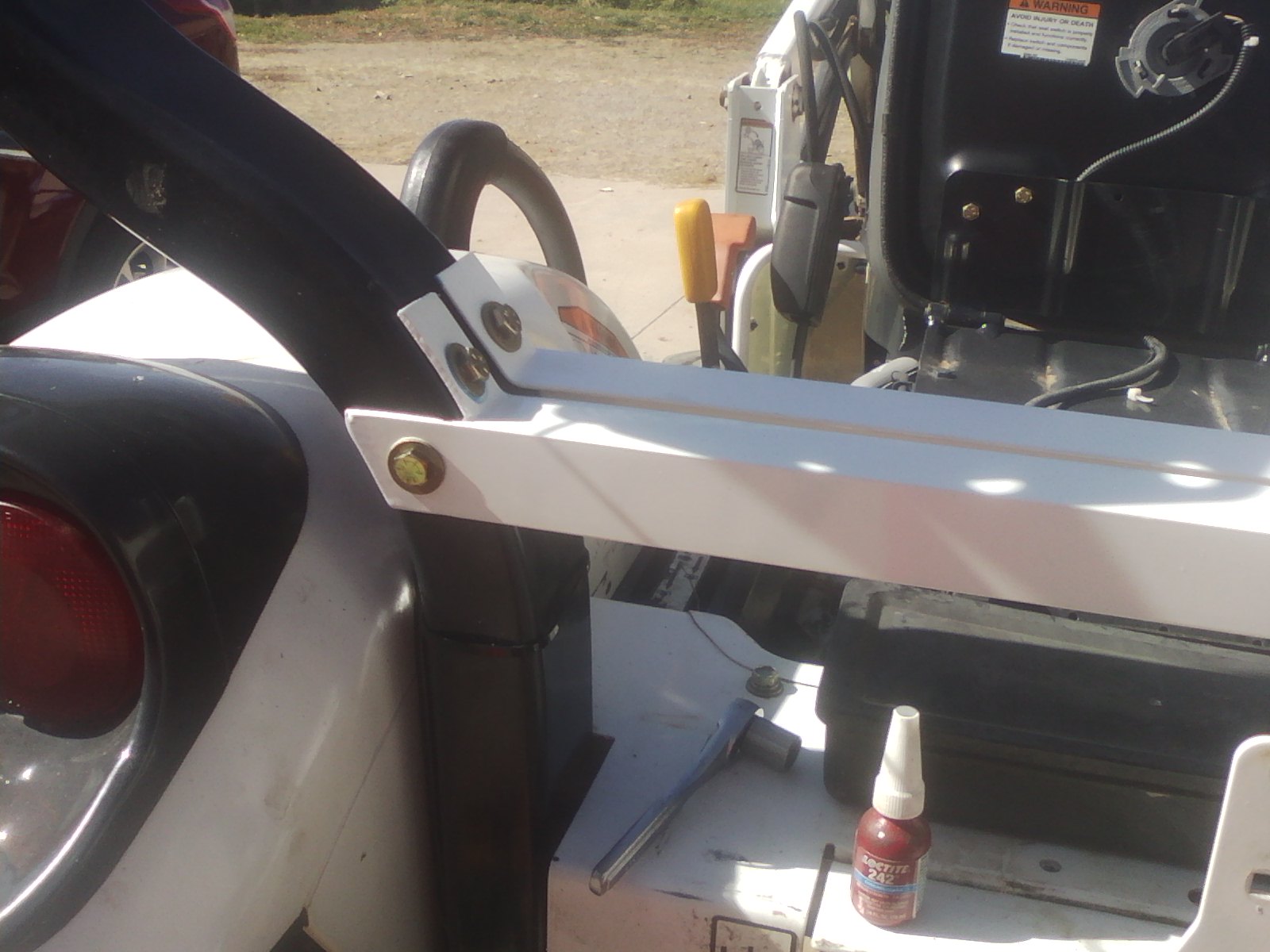

Here are a few pictures of the completed frame. I did use locktite.

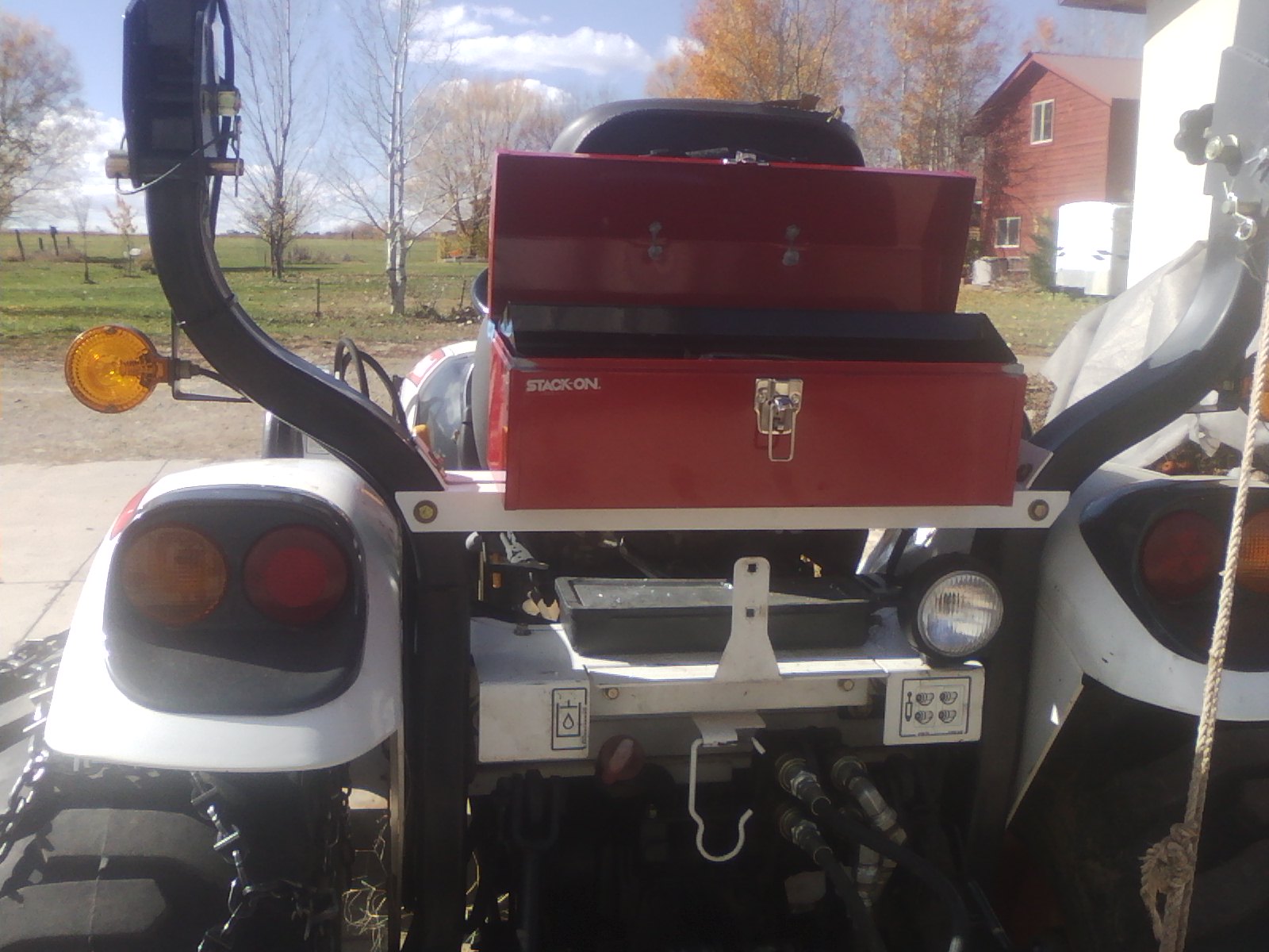

Well completed the install and sealed the unit up using urethane rubber. There were gaps at the corners and along the piano hinge. I also drilled two drain holes in the bottom, just in case. It the perfect size. I set it so I can open it without having to tilt the seat forward. To do so I had to remove the slow vehicle warning sign, but I have flashers and do not get out on the road. Ill look into another mounting point if folks think I need it.
