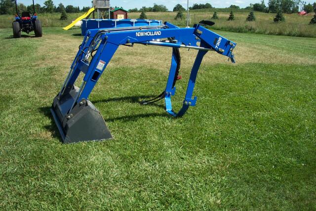

Here is a picture of Mrwurm's idea. It is not a picture of my loader but this is how I unload mine. This way the bucket can't move.
Now maybe with your set up you won't be able to do this? Not sure.
Murph

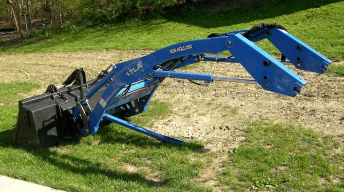

Murph, on a curved-arm loader like the 16LA that ACMan has on his TC40, you have to curl the bucket up to get the arms to lift out of the adapter on the tractor. You can't roll the bucket all the way down because these loaders don't have the yoke to sit on. I'm attaching a picture of my loader removed. You can see the bucket is curled all the way up. The post-hole digger is sitting there to show that the loader doesn't move forward during removal.

   / Too Much Pressure To Connect Hydraulics? Need Help #9
Jim,
I guess I didn't read what loader he had. And I am not familiar with the LA series on they come off. So I wasn't sure. With mine setting it on ground the back of the bucket was heavier than the front for the back would settle in more there for raising the front, putting unwanted pressure in the lines.
But I can see on the LA then that my way of doing things won't work.
murph

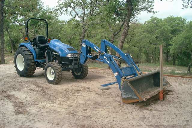

Jim I know you wrote the book on loaders but we have always treated our 17LA loader a bit different and it has worked well for us.
We set the jack-stand down, tilt the bucket slightly down to lift the front tires, pull both locking pins, level the bucket, put the tractor in neutral, take our foot off the brake and pull the joystick backward. The TC-40D is moved in reverse by the cylinders as they extend. Once we are clear we shut off the engine move the joystick to equalize the pressure and disconnect the hydraulic lines including the grapple. See picture.
Hooking it up is just as easy as taking it off.
Different strokes for different folks.....
