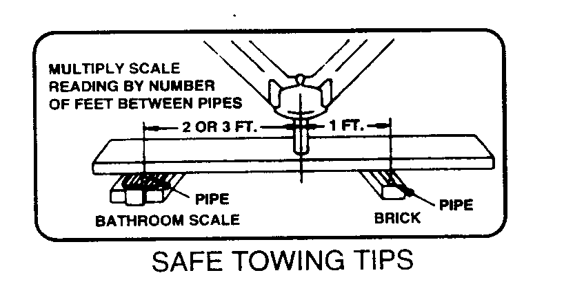

Seriously, a lot of us don't live near elevators or scales. But probably more of us have bathroom scales and a board.
