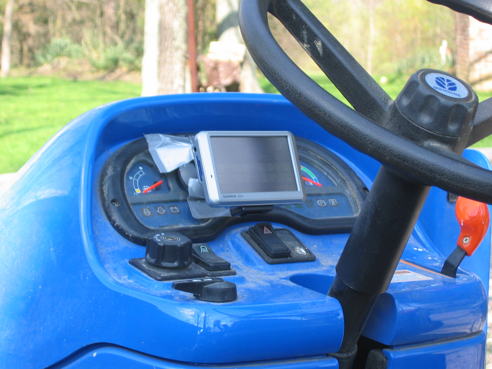

A friend loaned me his high-end Garmin nuvi 750 to try. This unit has a dashboard screen with a large speedometer in the center. He had also given me the car mount witch has suction cup and I stuck it in the middle of the instrument cluster. I made a couple of trips up and down the field. Worked perfectly. It was reading in tenths of MPH. I just set the cruise and the speed didn't vary more than a couple of tenths.
I may just ask if I can keep this unit for my spray job :). I was/am a little worried about it bouncing off in the field, but the holder didn't come off the glass easily. I'd still like to know if the TomTom (at half the price) has a similar feature.
