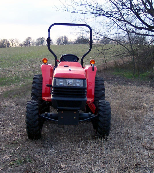

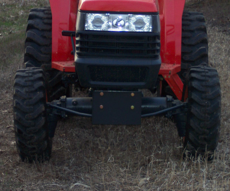

I have a new L3400 HST with about 20 hours on it. The right front tire(sitting in seat) angles outward that is the top of the tire is out more than the bottom the left side looks straight. I see the adjustment in the manual but will that only adjust the right side tire. The tie rods I guess they are the tie rods do not seem to be damaged only a very small bent but it looks like a factory bend as it in the same spot on both rods. The tire is not out that much but you can tell if you look at it staight on.

Here a couple of pics about as straight on as I could get. You should be able to see the left side is out.

Park it on concrete and then take a picture!!! If you look closely you will note that the rear of the tractor is not setting level.

interesting photos. It almost looks like the toe on the left side (right if sitting) it in a bit to far. this may make the camber look like it;s off more. i'd toe out the left side and take a look. as others mentioned, no other adjustments.
good luck,
rob
   / Toe In on L3400 HST
I happened to be in the area of a Kubota dealer so I stopped in and looked at all the L3400 and L2800 to check. It seem that all of them had a tilt to them. Mine might be out a tad more but not much. Oh by the way I have no pavement out here and don't want to drive down to the street and get hit looking at my tractor. :D
