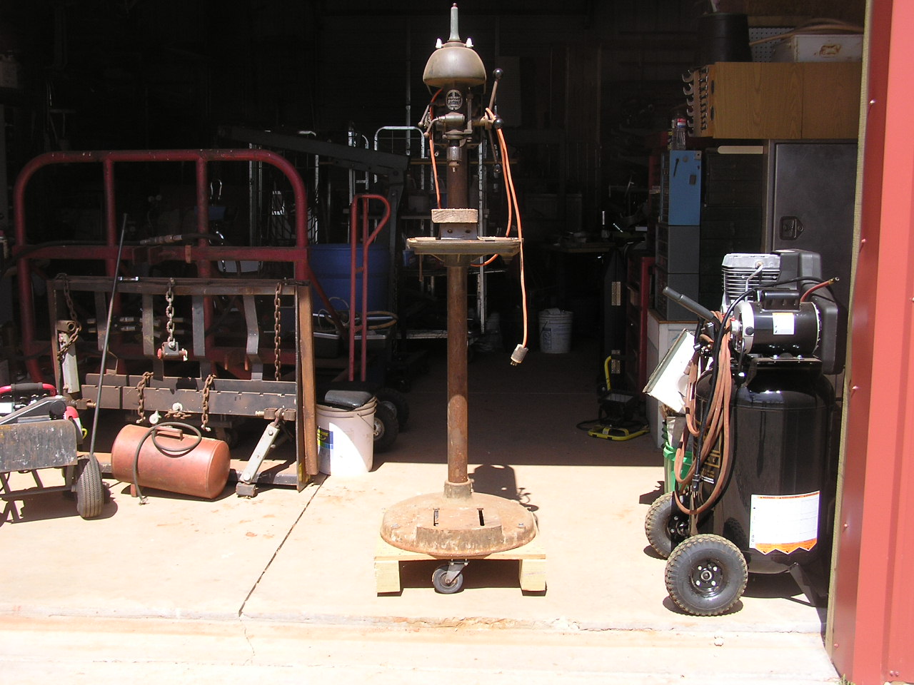

I just paid $120 for a 50 year old Rockwell 17" drill press. The only thing wrong with it is the switch, and it's missing the nut that sets the depth stop. There are instructions for wiring the motor for 220v on the motor plate, and for reversing the motor, so that will happen soon. The bearings and chuck are good, with no detectable play in the spindle.
I'm thinking of wiring the motor to a wall switch that will let me reverse the motor and start/stop the tool. What do you guys think of that?

I don't have a drill press, but have a 9x30 milling machine so use it in place of a drill press often. I would absolutely hate a wall switch to start/stop it. Mine has a 3-way switch. Center is off, left is forward, right is reverse. But it's right there and easy to reach. Taking a step to from a wall switch would be very irritating to me.

Why would you ever want to reverse a drill press? As for the rest, the missing parts are probably available. Rockwell then Rockwell/Delta then just Delta (maybe missing that Rockwell/Milwaukee got married/divorced at some point also). Same machine for the most part (how can you improve on a basic machine like a drill press)?

I thought it might be a safety issue too.
Add me to the list of that being a BAD idea.
Picture this. You’re holding down a piece of flat bar and the drill press belts slip or the drill stalls when the bit breaks through.
You let go of the workpiece in order to reach for the switch. The drill then continues to turn spinning the workpiece like a propeller.
Mount the switch on the machine. I added paddle switches on mine. They’re cheap on Amazon.

My drill press was modified long before I got it. They mounted a momentary push button floor mount starter switch (like the ones used in cars back in the 1940's) in the left slot of the floor plate. Very safe, the motor only runs while I am pressing down the switch with my left foot.

A couple of years back a friend brought home a foot switch from his workplace after a safety audit deemed it was unsafe. The guard over the foot plate had been broken off sometime in the past and it looked like somebody had just cleaned it up with an angle grinder. It ended up looking something like this. I used a 3' extension cord cut in halves to made "in" and "out" cables and I also made a nylon connector to thread into the unit where the original cable went and managed to drill two holes in it that I could JUST get the extension cords through with the use of lube. I don't think I could remove them from it now if I tried!
Anyways, my friend uses it on his drill press and really likes it. Being able to use both hands to control whatever he's drilling into when it won't fit in his drill press vise and turn the press on and off with his foot does indeed make it much safer than just using a toggle switch.

Thanks for the ideas. I was thinking of just mounting a paddle switch on the front of the belt cover, but the foot switch looks like a better idea. Plus, it would make it easier to switch the belt to a different sheave.
