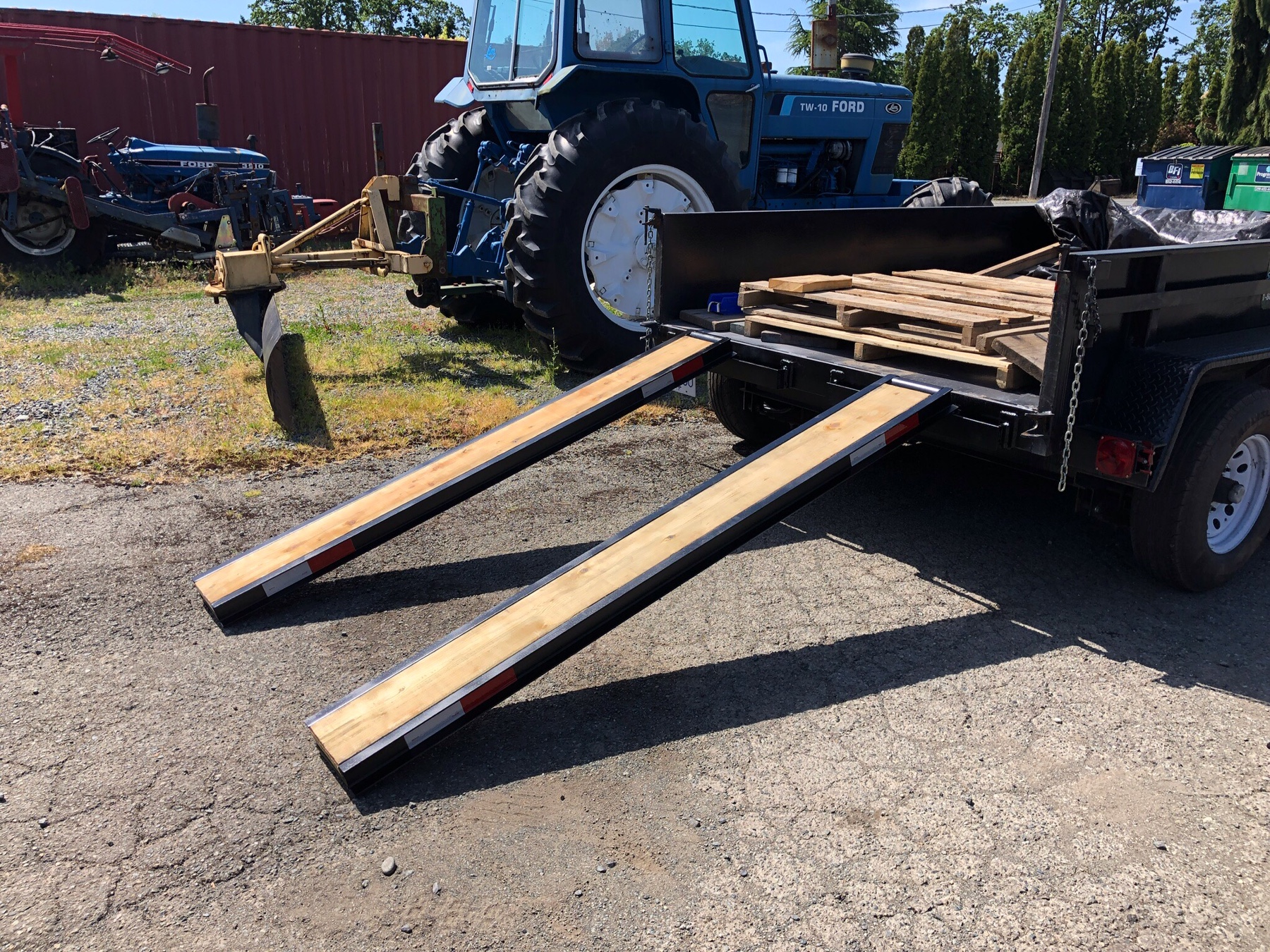

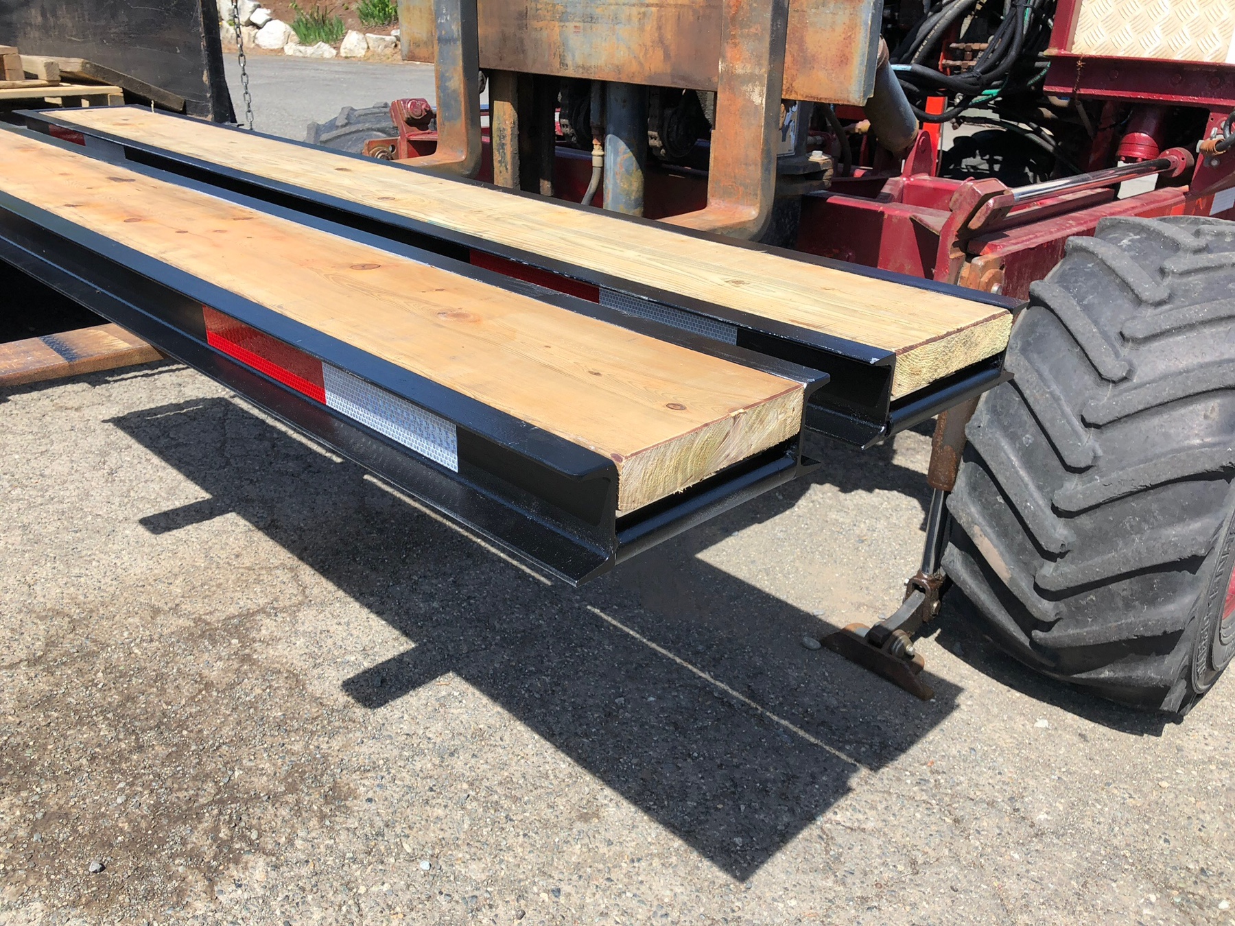

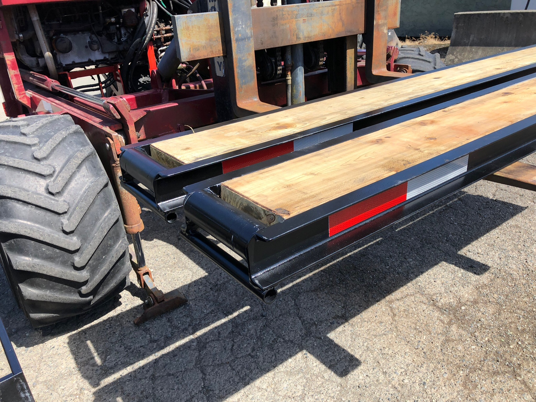

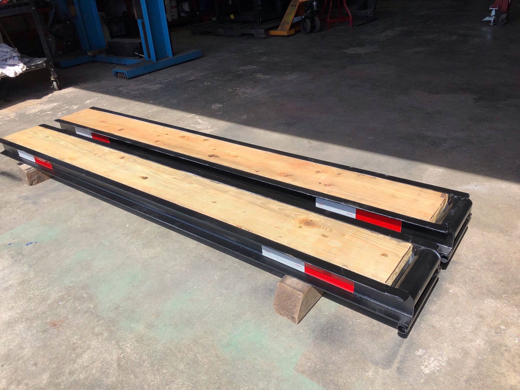

I spent the better part of the weekend building a set of ramps (steel and wood) for my dump trailer. They will be only used for equipment under 7000#.
Seven feet long and 10.25 inches wide. I used 3" channel, 1.5"X1.5"x.25" angle iron, and 2x8 pressure treated boards.
I didn't have cheap or easy access to any aluminum so had to use what I had.

Very nice BB. Wouldn't expect less. How are you holding the planks from scooting down hill when you start to load and what spacing is the angle at under those planks. Thanks
gg
/ Todays shop time. #543
Thanks,gg.

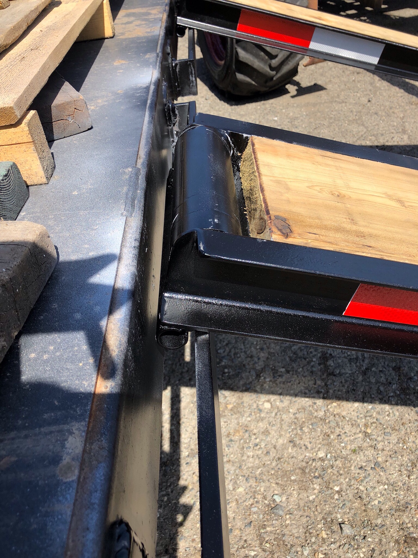

The angle iron spacing is only 16"OC as my reasoning was with a narrow 10" overall width the 3" channel would be carrying almost the entire load.
I made "receivers" with a 1.5" gap on the back of the trailer. 1/2"x3" flat bar on edge. The same material for the standoffs.

Nice job! Those will outlast a few generations. Last pic clears it up for me. :thumbsup:

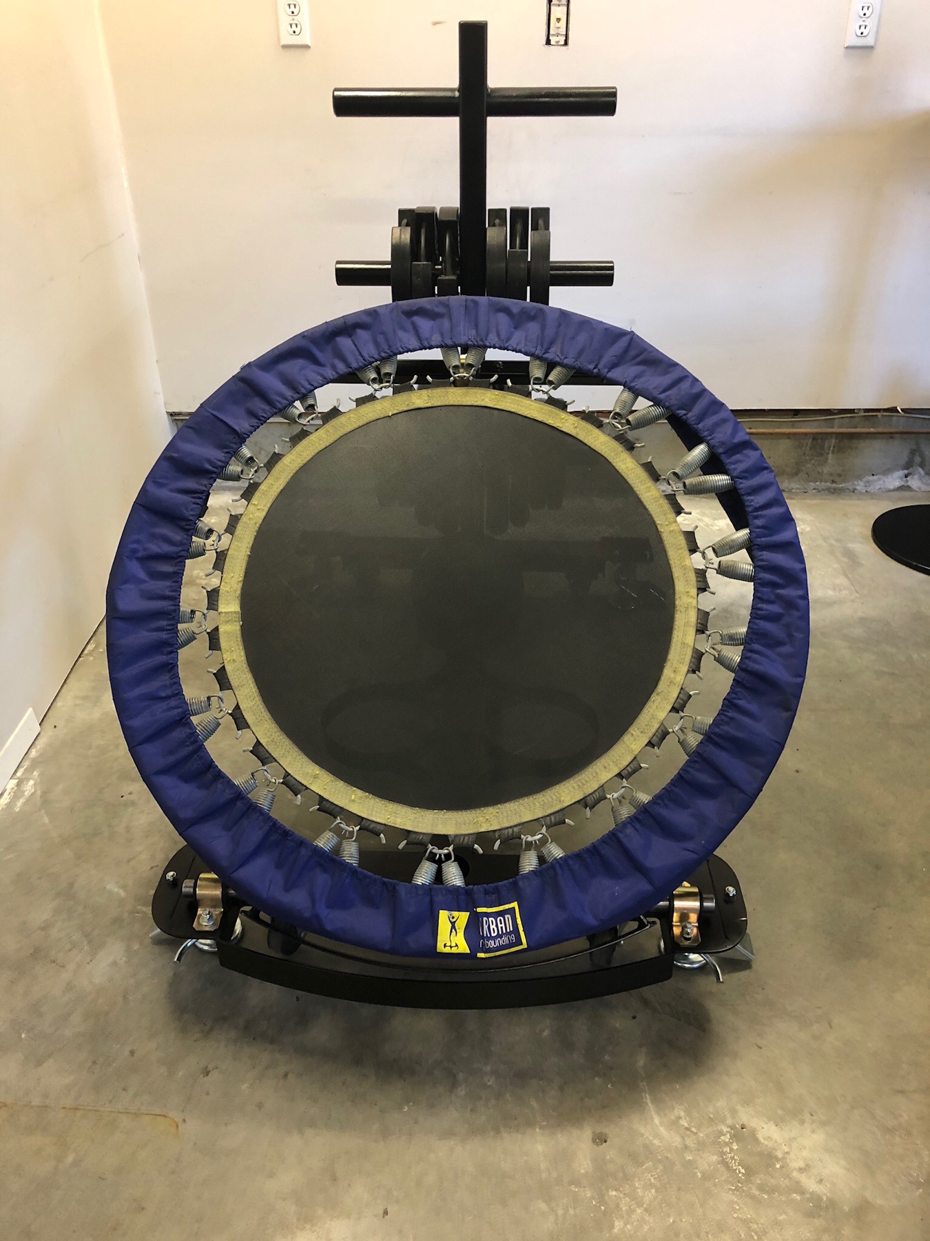

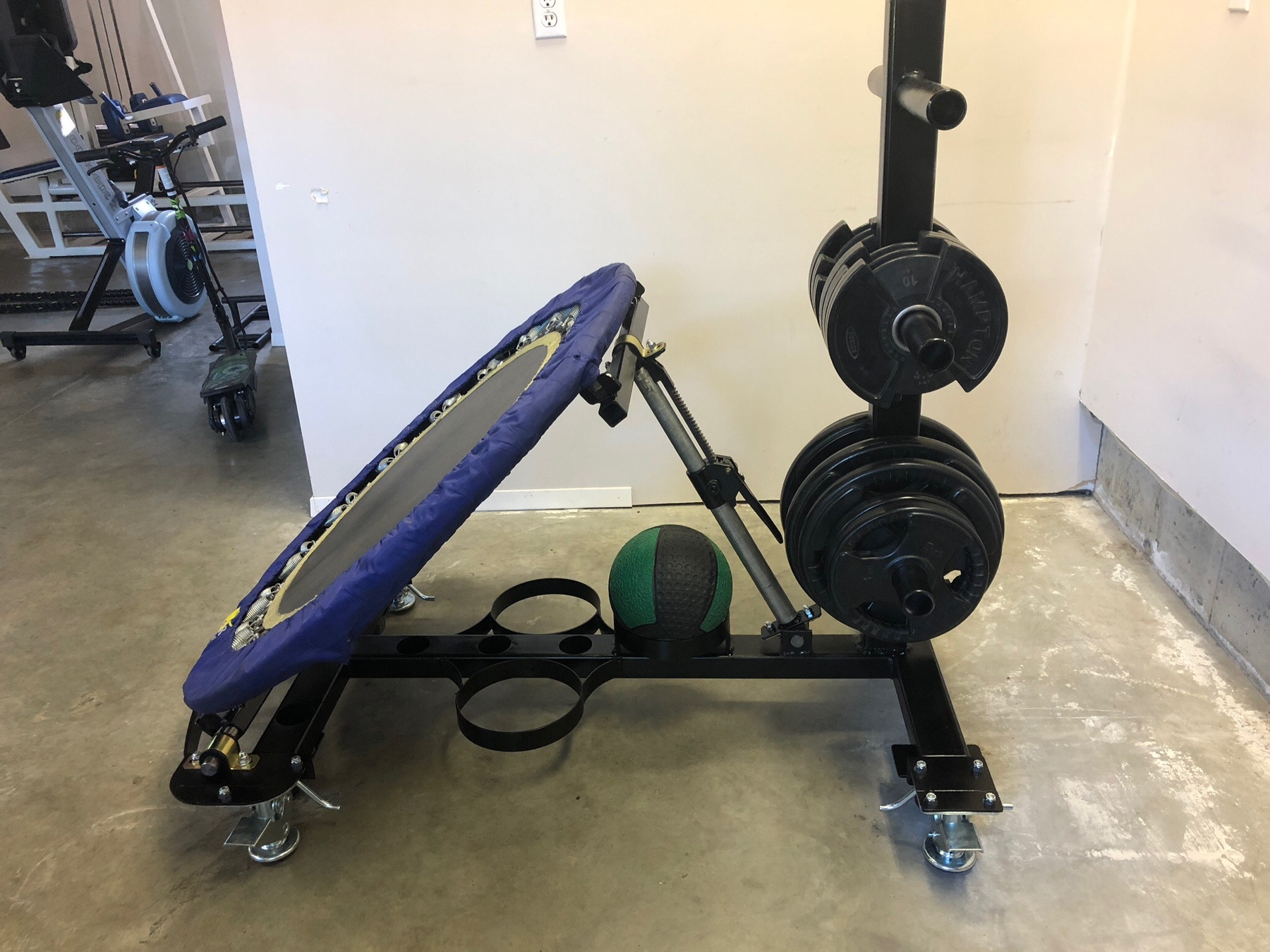

I made my own medicine ball rebounder. The homeowner ones available were flimsy and noisy. The commercial ones were also flimsy and noisy but way more money.
I made mine mobile and integrated Olympic plate weight storage. It's infinitely adjustable 45°-65°.
It provides an incredibly fun workout.
I made mine mobile and integrated Olympic plate weight storage. It's infinitely adjustable 45ー-65ー.
That's brilliant. Looks like it is ready for market! :thumbsup:

/ Todays shop time. #551
View attachment 554435View attachment 554436View attachment 554437View attachment 554438
The look extremely heavy to handle but very capable of handling a very heavy piece of equipment. I sure hope you have some help to put them on and off so you don't damage your back and end up like me.
/ Todays shop time. #553
They're 90 pounds apiece, Gary. Easy enough to hurt yourself not being careful. I'll keep a lookout for some used aluminum to make another set.

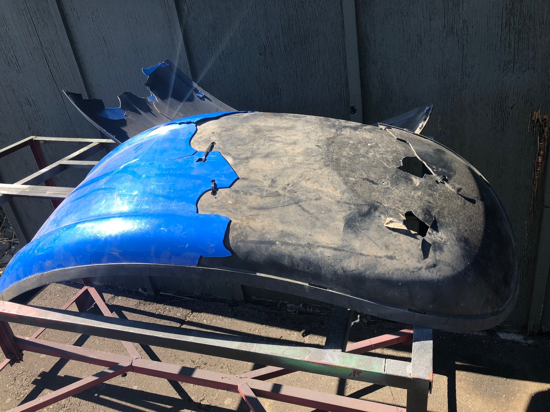

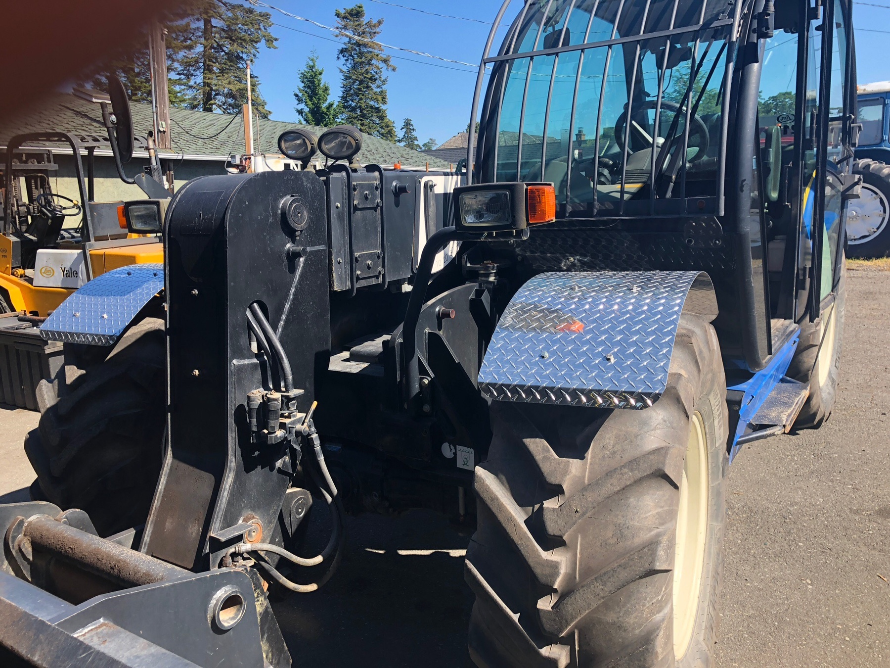

The front plastic fenders on my NH telehandler (purchased new in 2008) are toast. Between UV deterioration and the fenders "catching" on full turn/extreme axle oscillations this is what they looked like:

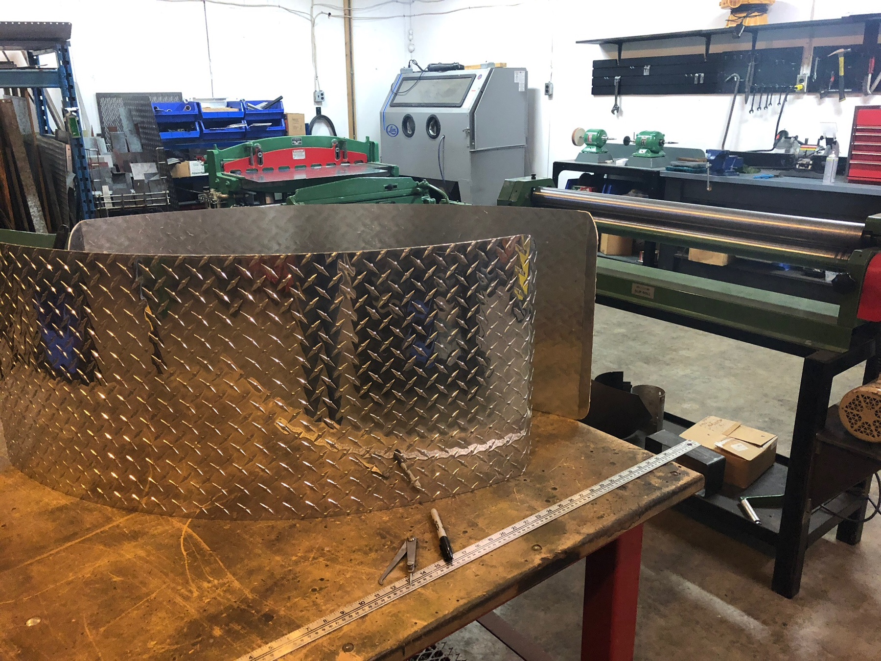

New Holland wanted close to $2000 for a new set, so I decided to try bending up a pair using .09 (approximately 11 gauge) aluminum checker plate I had left over from a previous project.
They turned out good enough for a couple of hours work. What really annoyed me was when I removed the originals I realized either the factory or the dealer had installed them on the incorrect sides (left and right). The barely noticeable 1" offset probably contributed to their early demise.
I'll have to pick up more aluminum to replace the two rear fenders.
View attachment 555491View attachment 555492
I suppose going back to dealer on a 10 year old screw up is not going to get you far. DIYers looking good though!
Your replacement fenders look a lot better and should last longer.
