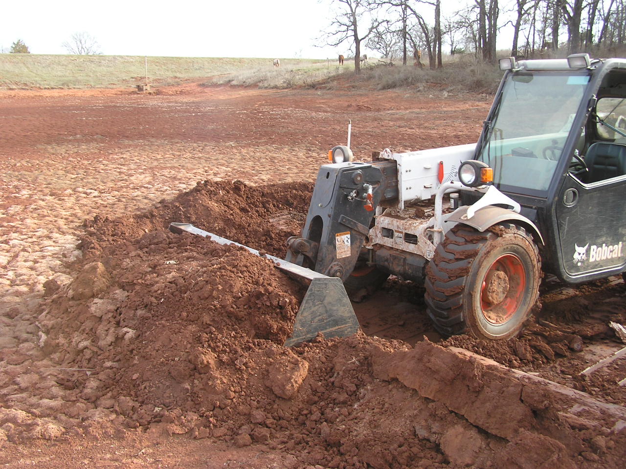

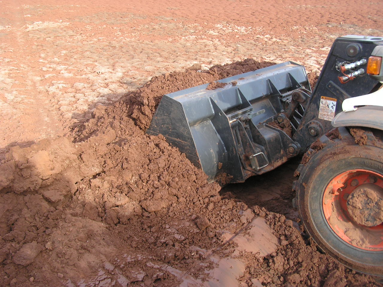

This is what a very full 1 cu yard bucket looks like.
This is how it got that way with one stab.

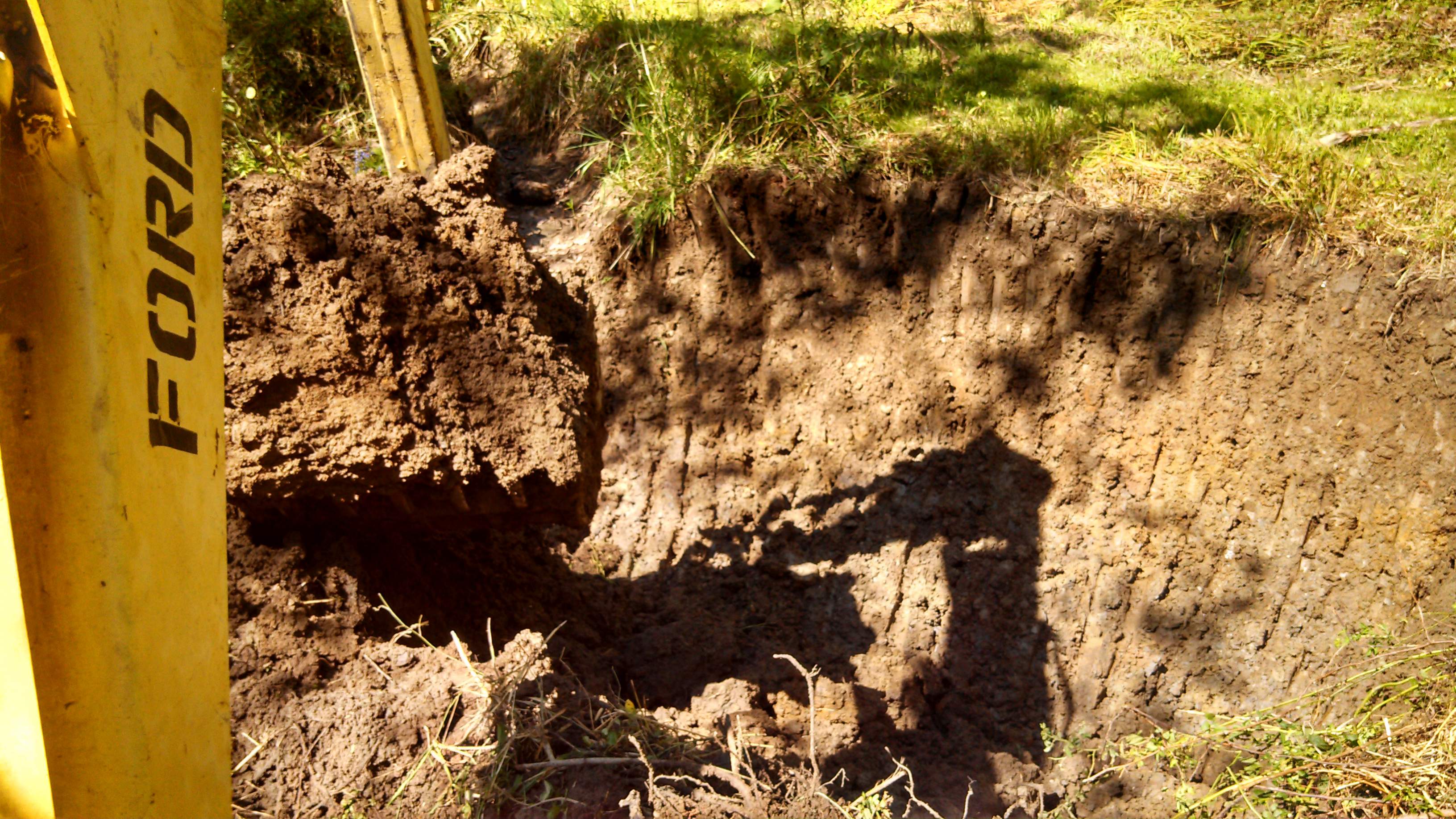

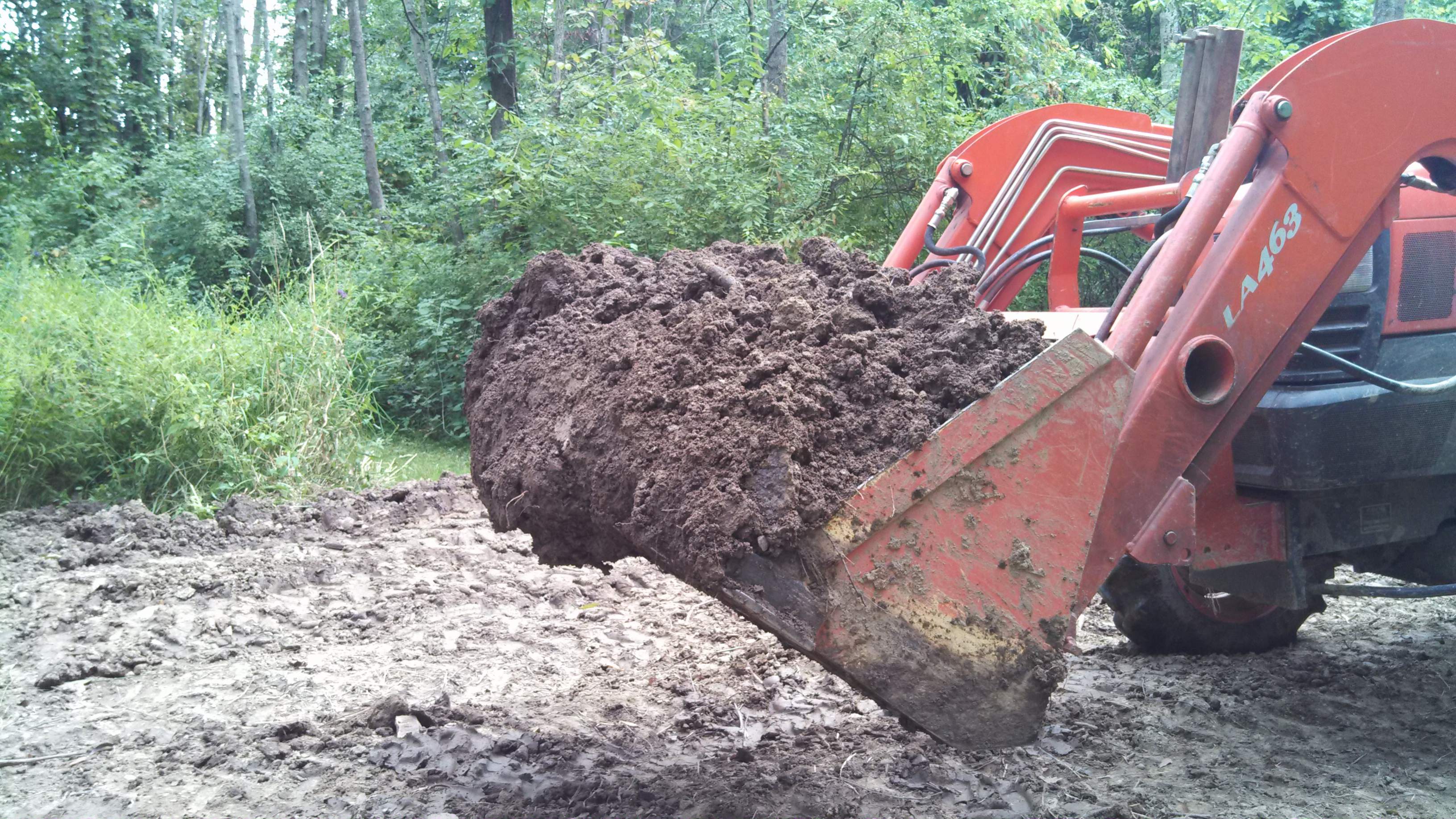

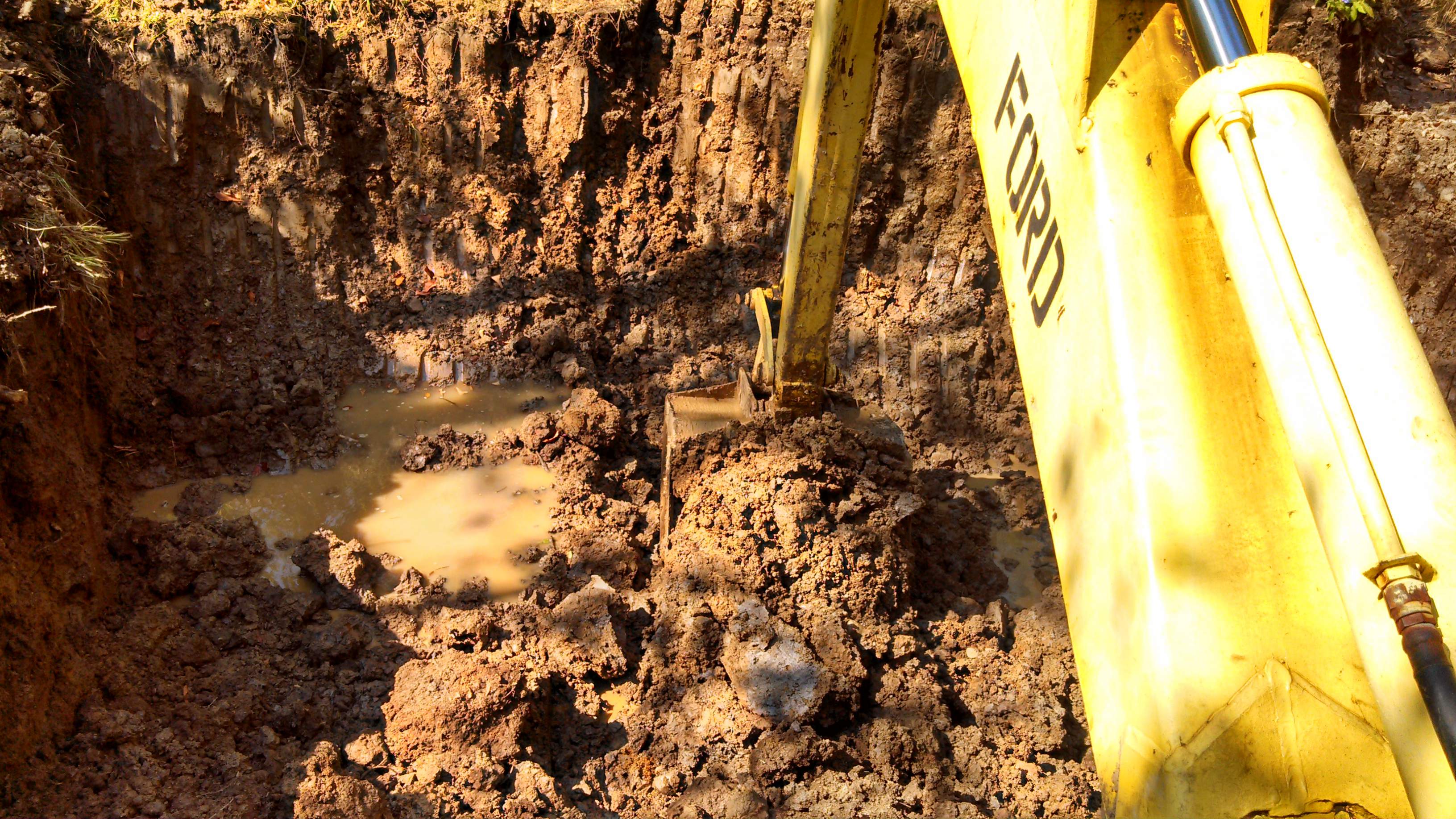

Travel time is everything. As others have already mentioned. But I typically dont have any issues getting a full bucket with either the 4wd kubota OR the 2wd BH.
My dilemma comes in as either using the BH with a 1-1/8 yard bucket, or using the kubota with 1/3-1/2 yard bucket.
Again, travel time is important. But when moving piles short distances (5 seconds or less) and or spreading out piles, the kubota is actually faster than the big cumbersome hoe. I can easily do 3 loads on the bota for every 1 on the hoe. Maybe more.
But any distance at all, the hoe is king.
But then again, if only moving a short distance, I can use the hoe. With a 20+ foot reach, and 185 degree swing, I can move dirt 40' with the backhoe. And having a 1/2 yard bucket (maybe 3/4 yard heaped), that is even faster yet for short moves.
Honestly, I never really give it much thought. I just hop on whatever I feel like driving for the day:laughing:
Believe it or not, each backhoe scoop is more dirt than the kubota load, even though it sure dont look like it, the backhoe is about 1.5x's more dirt:confused2:
IMG_20130824_115421_309.jpgIMG_20130826_112329_533.jpgIMG_20130826_144511_123.jpgIMG_20130826_144604_425.jpg
