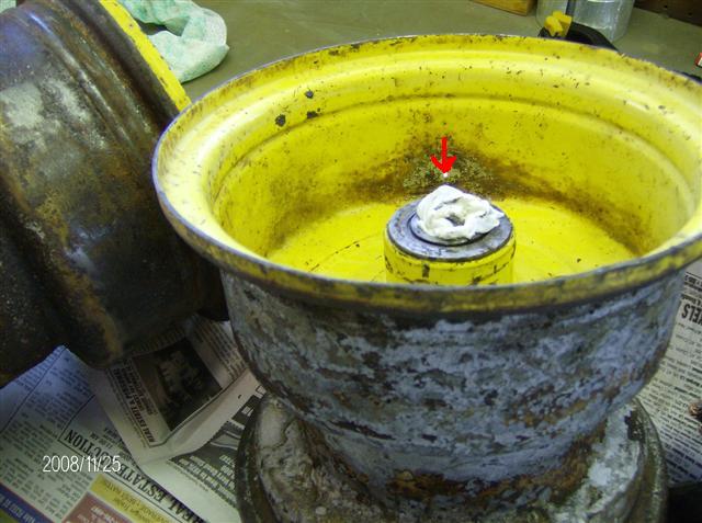

Just be aware that some (maybe not all) "flat stop" products eat rims! My JD 420 had a "hydro-seal" product in the front tires when I bought it, one rim was in bad shape, including a hole eat through it! Cleaned the rim, epoxied the hole & tubed the tire. ~~ grnspot110
How long do you think that flat fixer product was in there? It sure seems to have done a number on that rim.
