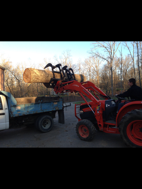

If I was forced to pick between my current tractor which is a L3240 without a backhoe or a scout with a backhoe. I would pick the bigger tractor. When I bought the tractor we were building a house and the primary use was dirt work. Now its primary use is firewood. I have to haul my wood over the road and my preferred hauling method is a Chevy 3500 with a dump bed. A scout lacks the lift height and strength to do this. A scout also lacks the ground clearance which is pretty important for my use.
