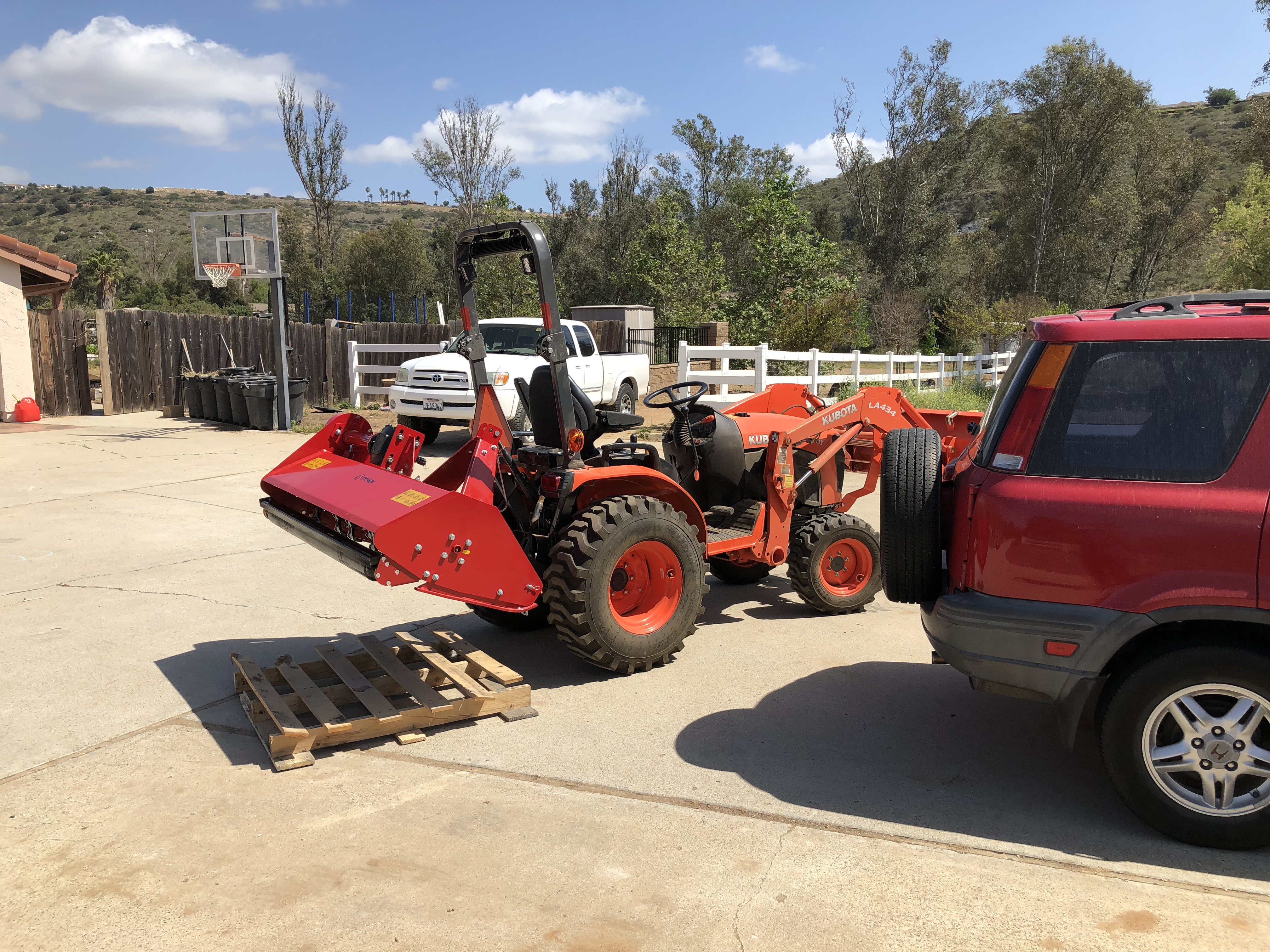

I finally fired it up and mowed some of the overgrown weeds. Everything worked as expected and the weeds are now shorter than when I started!
I'm sure as I get more experience I'll be able to understand each setting and hone my configuration. My needs are to abate weeds and to clear some of the wild brush for paths and access.
Some things I noticed:
-This is the only other attachment I own besides a box blade, and I can feel the difference in weight between this and the box blade. Tractor still handles just fine, but it's something I can notice.
-DUST! I live in a desert climate and there's lots of dry dusty dirt, all of it is dry dusty dirt. So when I'm mowing if I catch a small mound of dirt there's an immediate dust storm.
-I turned a 5' tall bush into mulch, it was pretty amazing.
-My Kubota B2601 ran it just fine (I was wondering how it would manage)
-It was fun!
I know that I got the cheapest flail possible, and I don't expect a champagne on a beer budget but this thing did the job for me and I'm confident that if properly maintained this will last me several years. I'll come back and update this thread as I get a bit more experience.

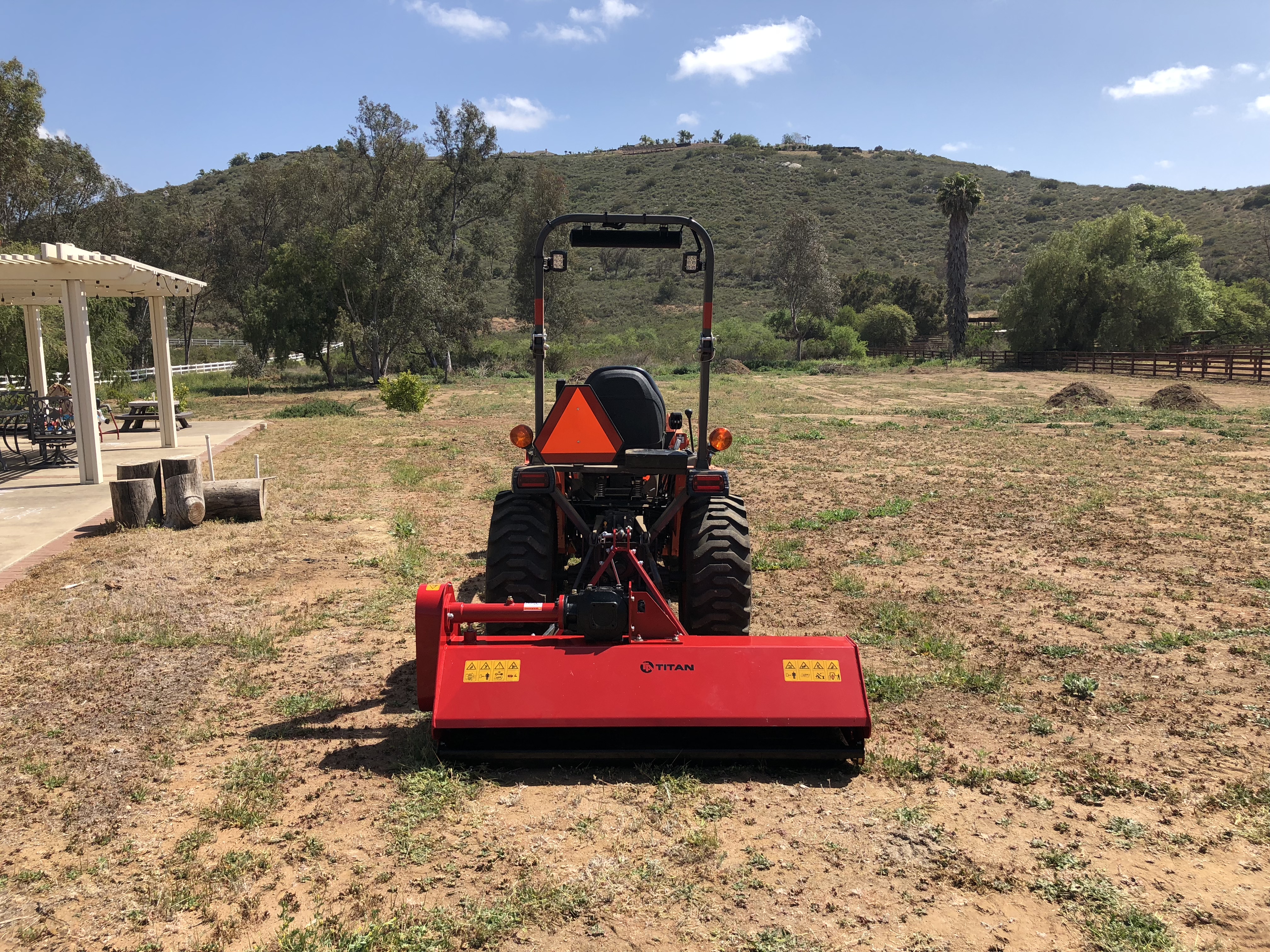

I've been using it a bit here and there with great results. I'm only clearing brush and weeds, no grass. I've got it set up so that the mower has about 12" that protrude right so I keep a close eye on the right side to make sure not to take anything out (or take out my mower).

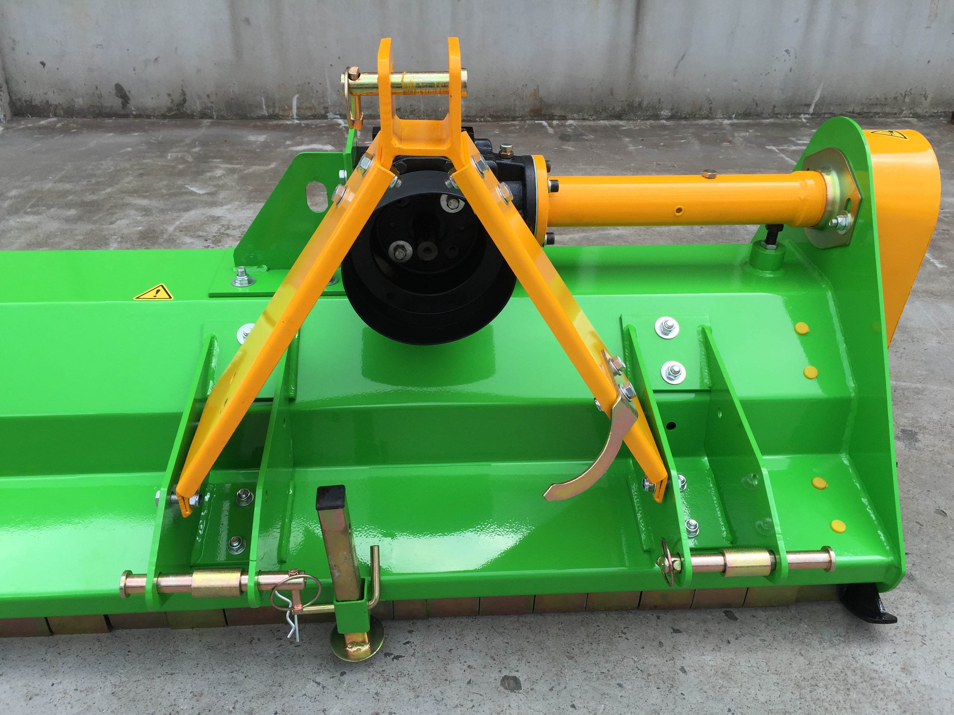

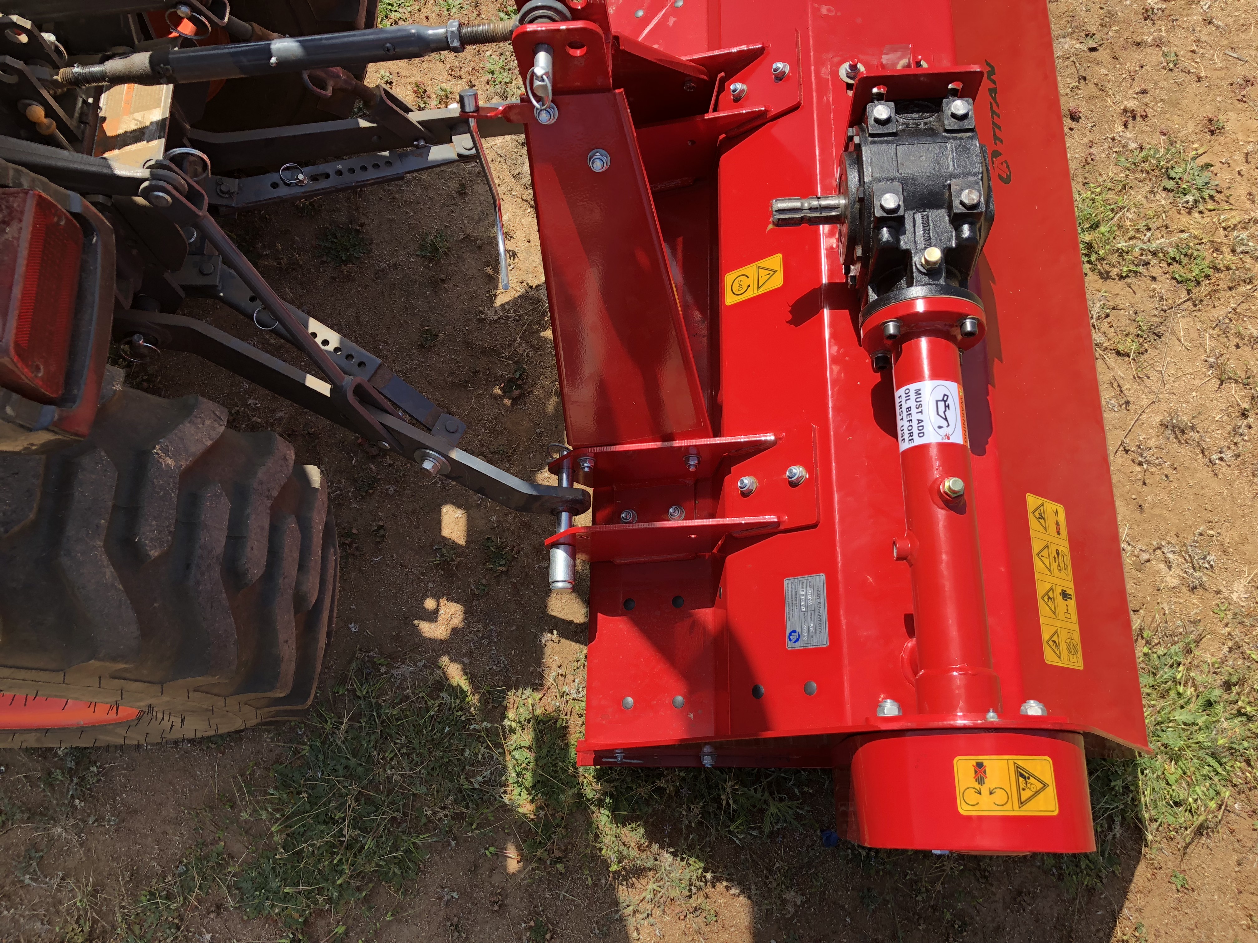

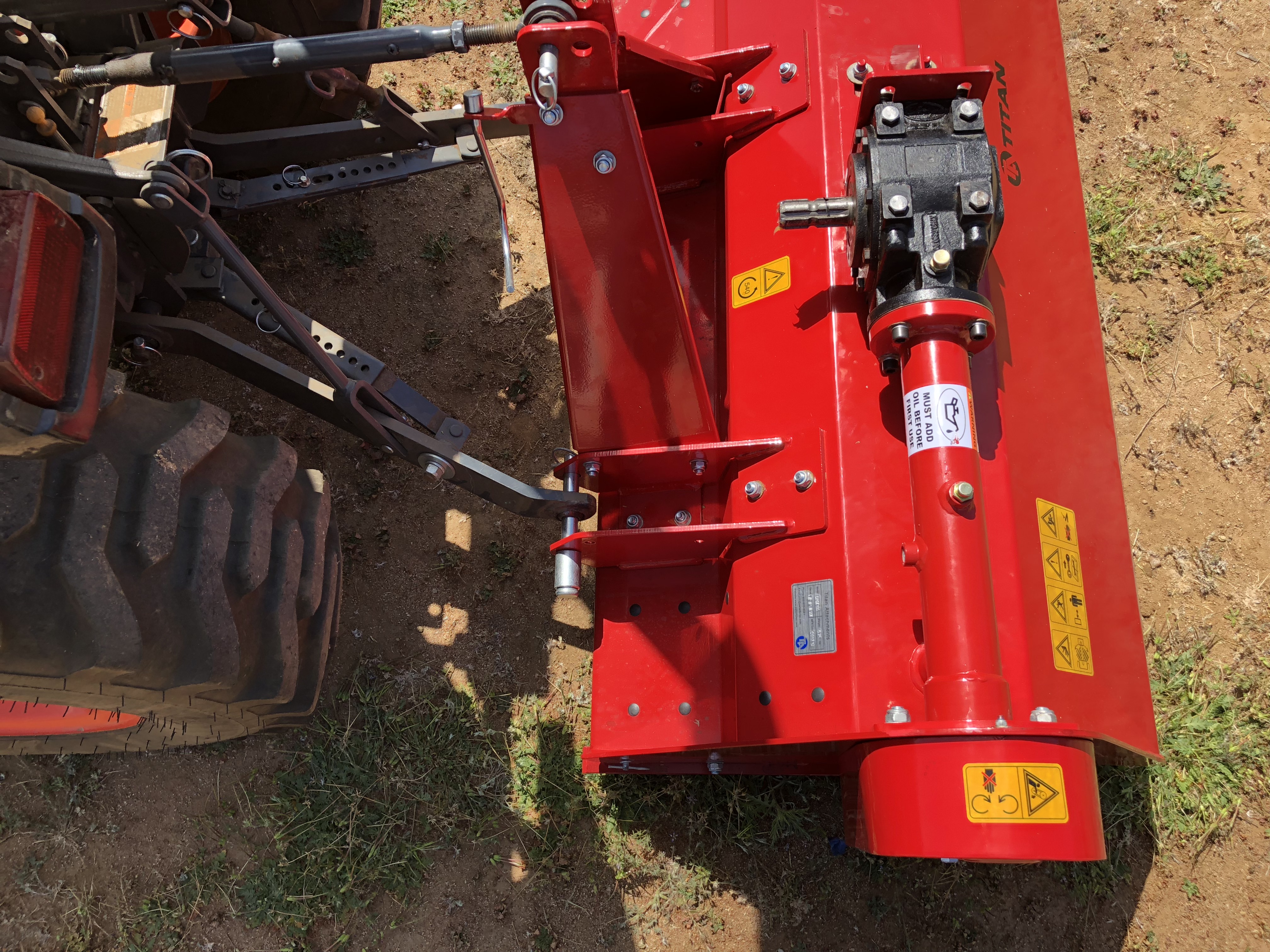

You assemble the lower bushing at wrong position, it should be installed inside the lower hitch like this. To avoild the mower to slip when mowing.
Look at these photos.
And where is the PTO cover on the gear box????? Safety first.
/ Titan EFGC155 Flail Mower
#33
Ah yes that makes sense, I'll move the bushings next time I take the mower out. I took this picture right before putting the PTO shaft on so I took off the rubber gearbox PTO cover. Again Jack, thanks for your flail mower knowledge and help!
