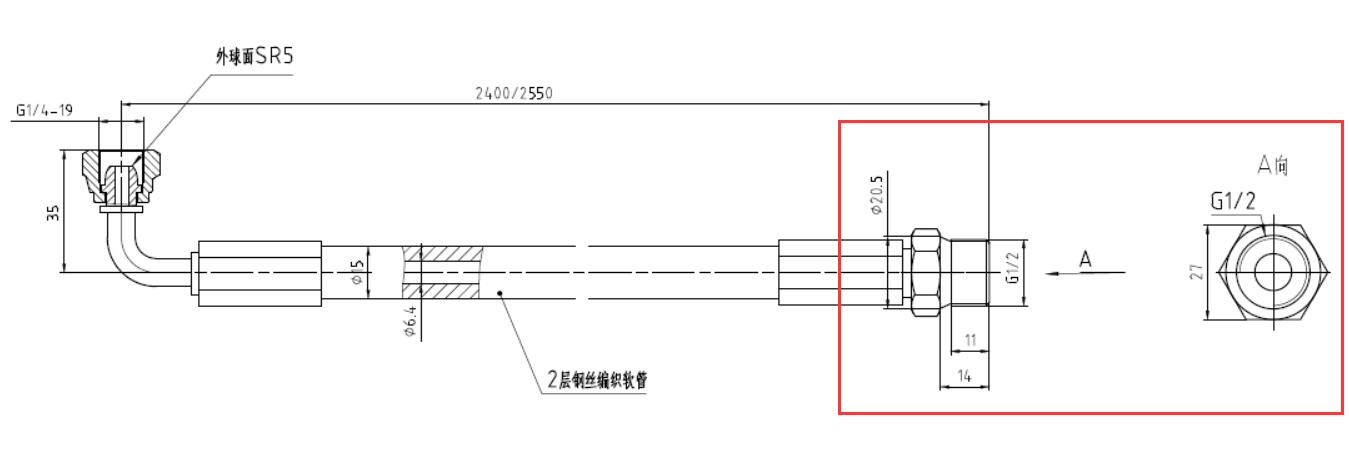

I recently purchased a titan flail mower however the hydraulic fittings do not match my tractors, a kubota l3901.
My thought was to change out of he fittings however even the connection on the end of the hose is odd. On the end of the hose there are tapered fittings with an o-ring in the middle of the taper and is they have female threads. I will try and post a picture if that helps?

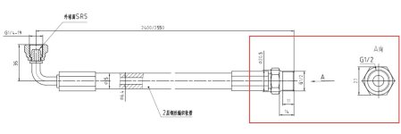

If the initial couplings of the Titan ditch mower cannot fit on your L3901, then you need an adapter to change the initial thread into the thread of the male coupling for L3901.
I think the initial thread on Titan mower is G1/2" as this photo: QQ截图20180808234727.jpg
By the way, what's the thread of the male coupling for L3901? You can ask this data from your Kubota dealer.
Then you can find such adapter on internet G1/2" -----> Kubota male coupling thread.
Or you can ask Titan to get them from their Chinese vendor which should/could produce that adapter within one week.
Enjoy it.
