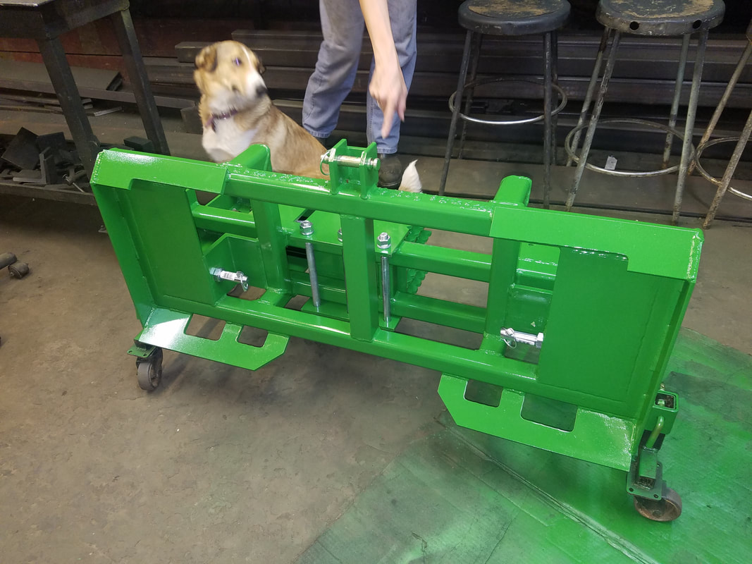

...But I do have the Titan 3 point to SSQA. And like it for what it is. I also have a hydraulic top link, so that makes it easy to connect to SSQA attachments.
It is heavy, so a bit of a pain to connect to three point arms, I made a jig out of some scrap 2x4s and a furniture dolly, to easily roll it around, and hook up.

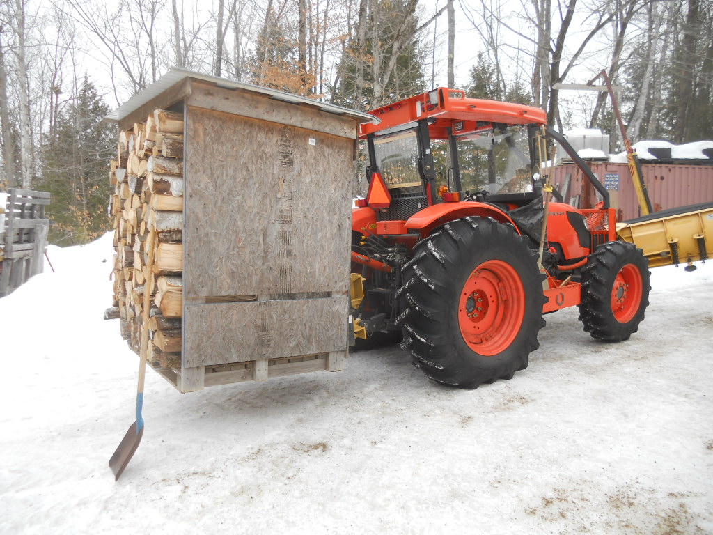

.. I use it mostly with my tree puller, as I use it on rear of tractor, while leaving Grapple on front. Have cleared acres of saplings with it
..Also use it for my pallet forks, and homemade platform for a carryall. And sometimes with the bucket.

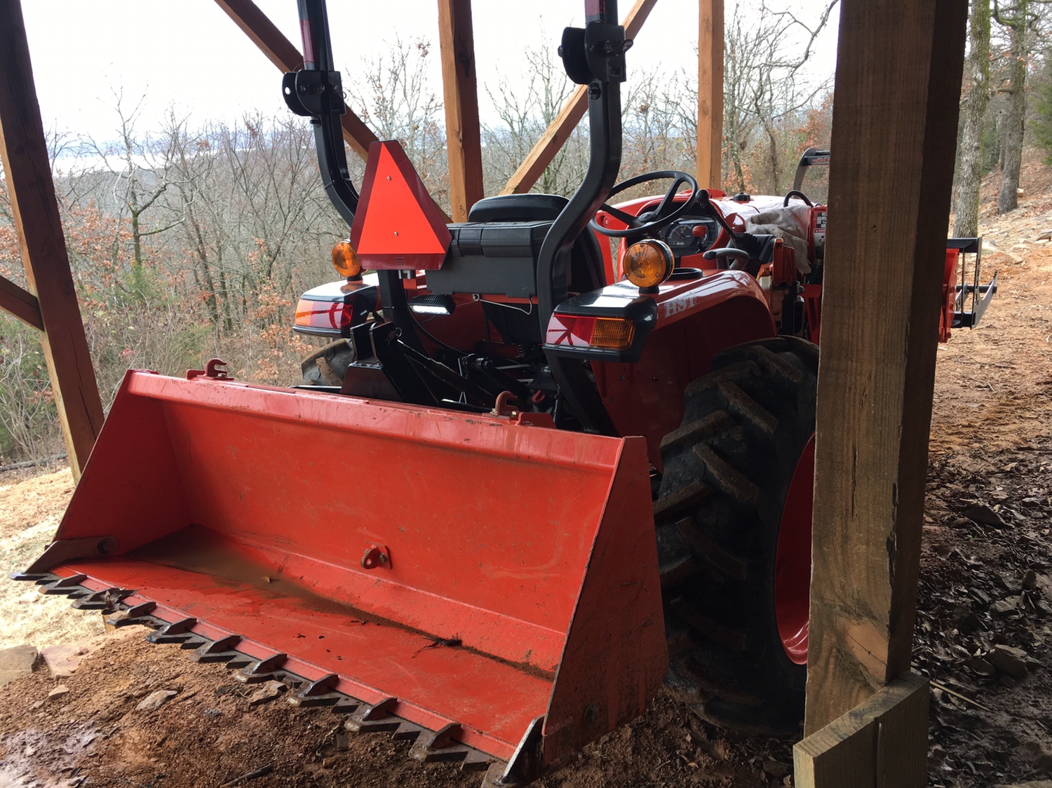

   / Titan 3 point to SSQA Adaptor

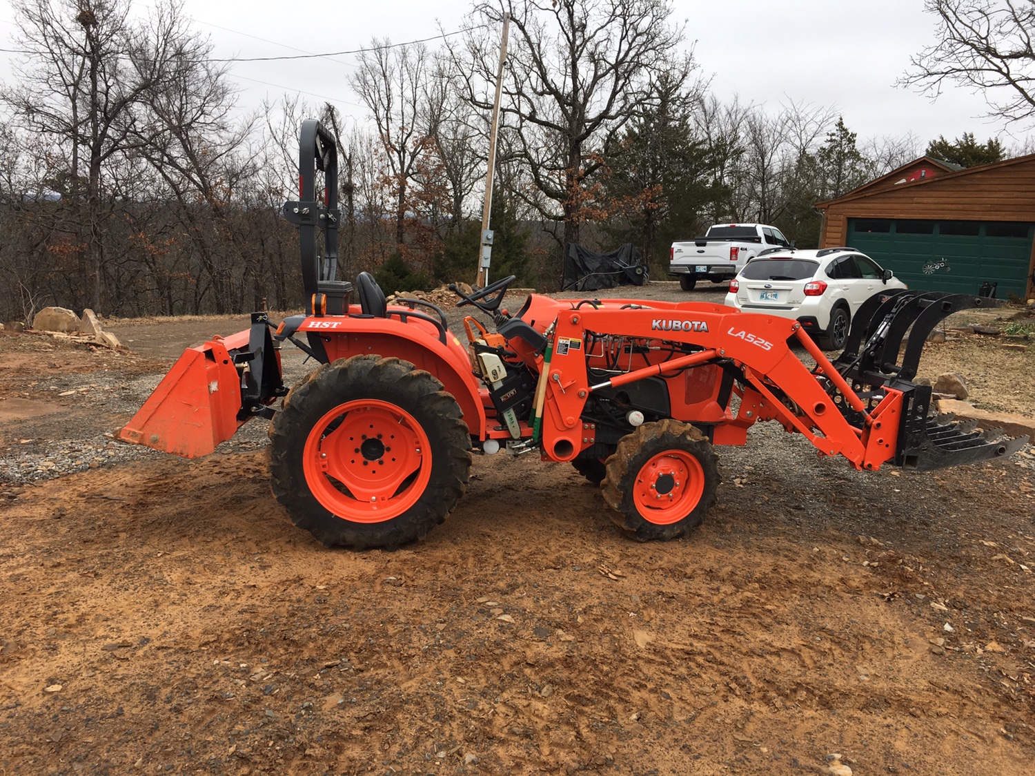

That's my plan is to use it with the bucket on with the grapple on front.
With rear remotes and top tilt eventually, it'll be an interesting addition!

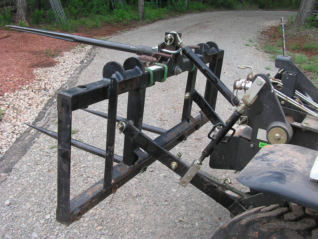

It wouldn't take much more bracing and would set in closer than on an adapter to SSQA.
Just copy this frame design:

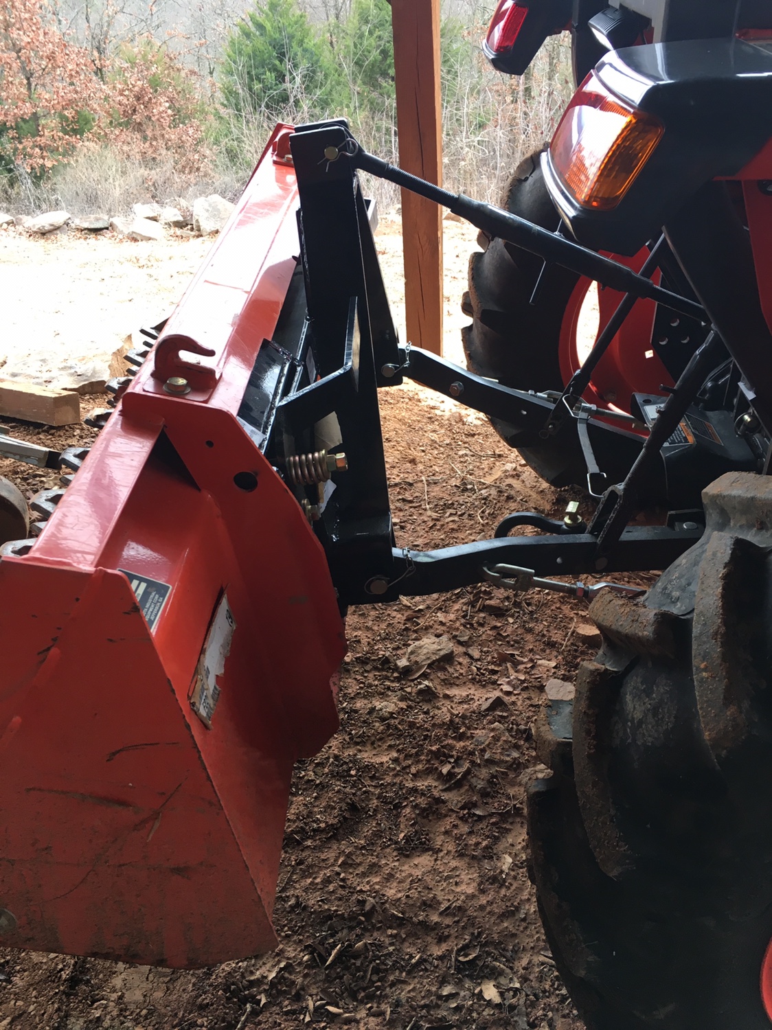

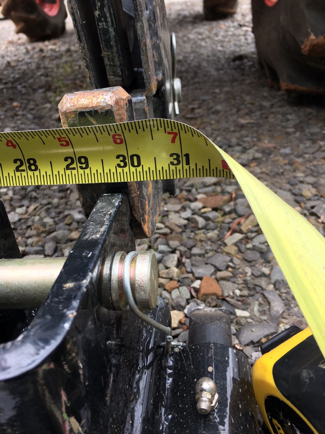

Well, I got it and sad to say. It will NOT work with a HF quick hitch out of the box.
What is irritating is that with only a little bit of care and setup with welding certain braces, it would work perfectly.
Titan, you screwed the pooch on this one.
By moving the two braces out in line with the other frame members, this could have worked just fine. No extra expense or labor. 5/8" inch total means 5/16" on either side.
So. It's heavily built. Seems well constructed. Must be careful with the SSQA lever handles as they can terrify the rear tail lights if the top link isn't extended out quite a bit. All in all it is a quality product. IMG_2204.JPG
Now I have to go buy a plasma cutter, sigh.... and a welder, sigh.... to move the two pieces of outer angle outwards enough to work with the QH and then of course finish contract negotiations with Brian @ Fitrite for rear remotes so it can dump as needed.
A man's work is never done.

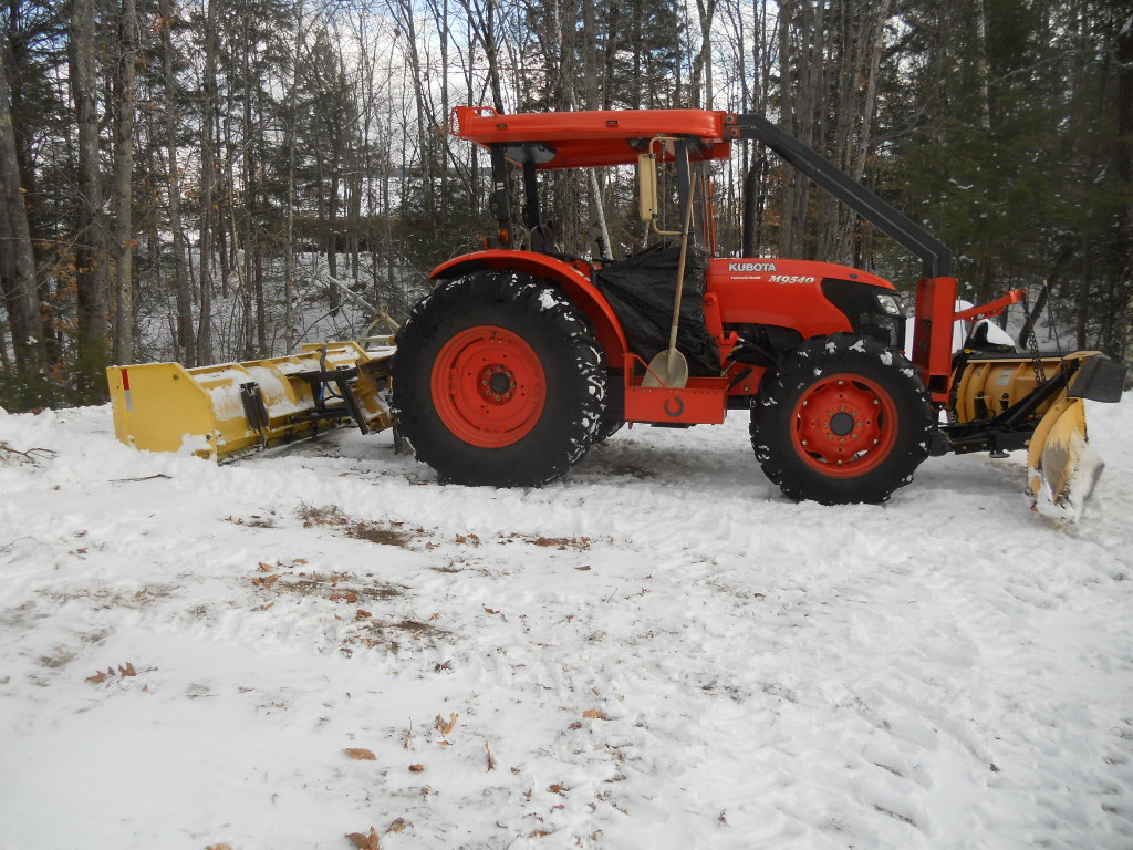

Lenny double check the distance (stroke) you'll need to dump. I don't think you can fit a long enough cyl in place of the top link to make it happen.
I've tried. It's handy to have a bucket on the back for tools or loose hand filled stuff, and the rear forks are great, snowplow is handy too.
