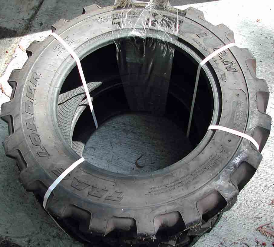

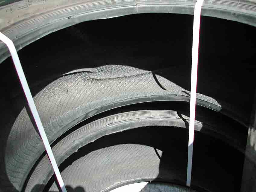

Great supplier, Phil. I just got these blems 2 days ago from Nebraska Tire,
for $126 for the pair, delivered. You can see the defect in the carcass if
you look closely....I am not worried about using them. 25x8.5x14 Titans,
but with the 'T's ground off.
