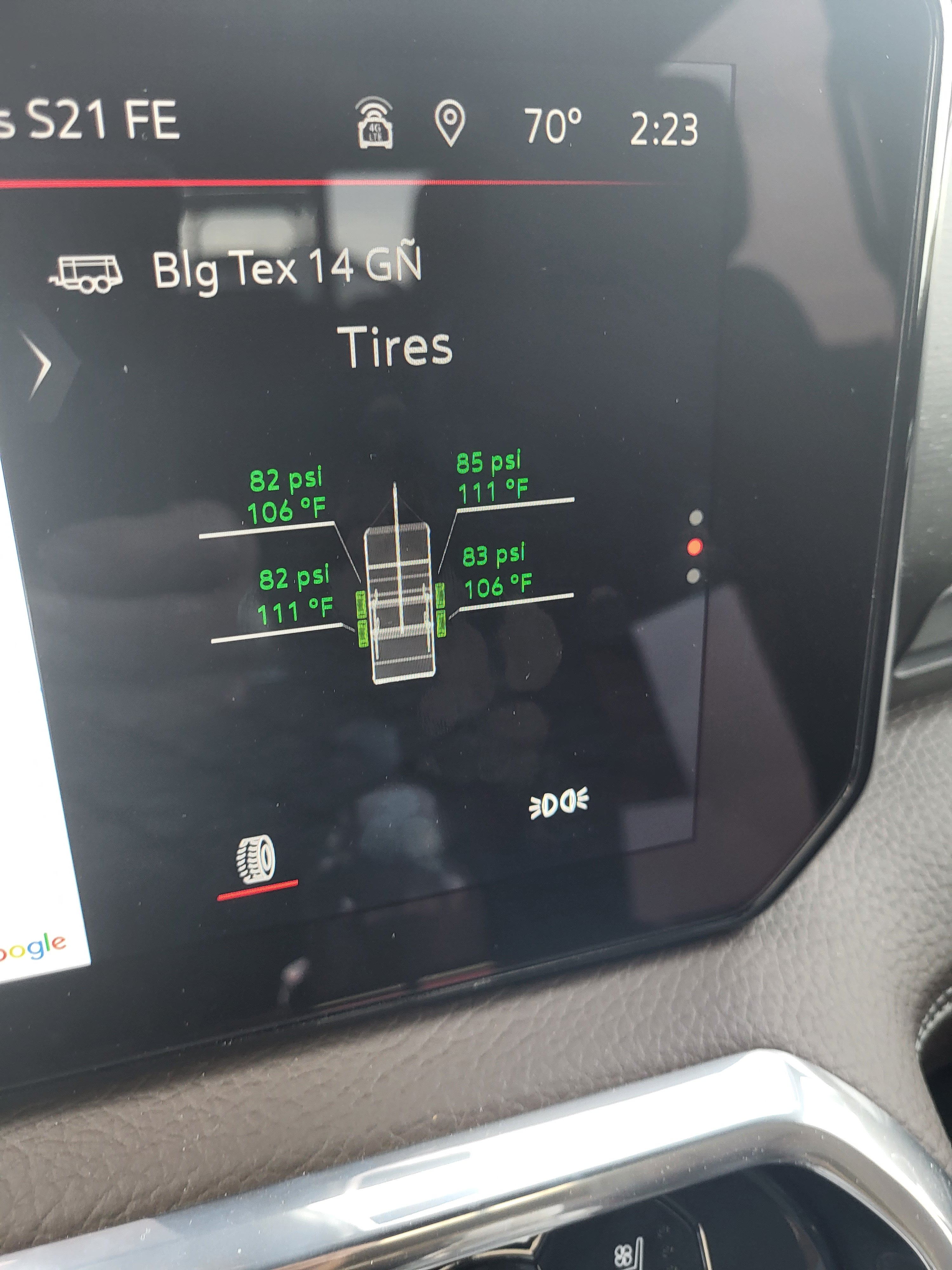

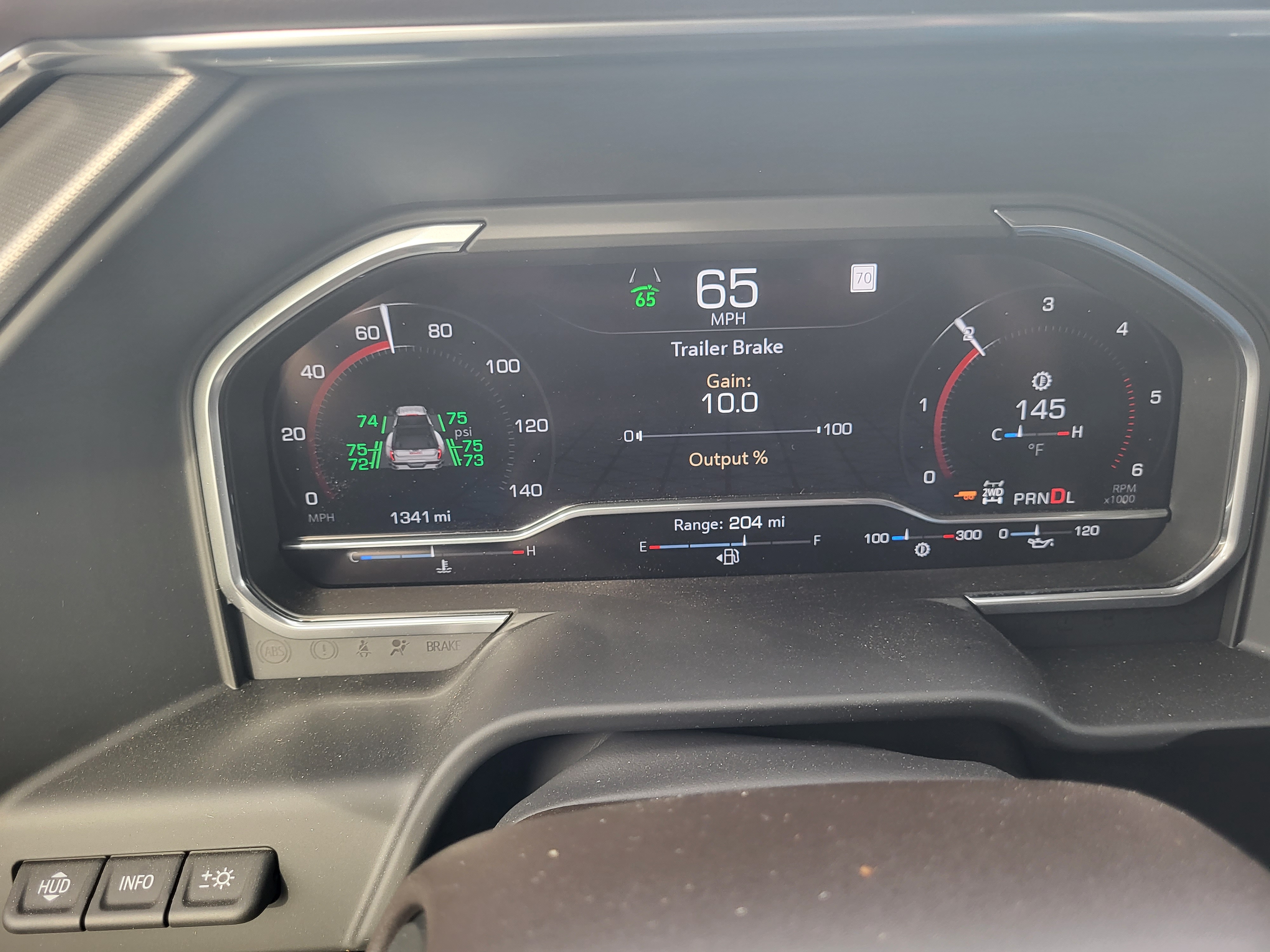

I too am a believer in TPMS. My GMC vehicles allow you to customize the display on the dash display. On the 3500HD I have the TPMS, transmission temp, and trailer brake gain displayed. Definitely easier than manually checking the duals. The trailer TPMS is on the center display.
