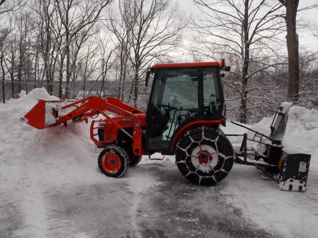

I just bought a pair of mounted turf tires (rear) to permanently mount my chains on my BX25. I normally use the industrial treads year round. The dealer told me that Kubota frowned on mixing tires from front to back, and it could void any warranties. The reason was that the circumference was different on the turfs vs the industrials, and it wasn't healthy for the 4WD. My viewpoint is that using chains will effectively change the circumference of the rear tires regardless of the treads, and since Kubota isn't keen on using chains on the front, I cant see how this argument is valid.
Do I have anyone who agrees with me, or should I buy turfs for the front for snow use with my chains?

I've never seen mixed tires on 4-wheel street vehicles. Even dualies rears match the fronts. Can't be that expensive to pick up a front set with turfs. Could even come in handy, if you get a flat in the front. I'm a big believer in chains.

Well it depends! If you only run the chained tires on snow covered roads there is enough slippage for the fronts to relieve any mismatch in tire circumference and nothing to be concerned about. If you need to do a lot of close turns on dry pavement you will be either pushing or dragging the front tires and adding extra stress and wear to the front axle parts. I'd run the chains on rear with the fronts you have and pop it into 2WD anytime I had to drive on dry pavement. Do run a compatible front to rear set in the summer or you will suffer rapid front tire wear plus axle bearing wear on the front.

With these on it doesn't matter what tread pattern you have under them. Ice surface with rain on top and no tire is worth a darn without chains.
