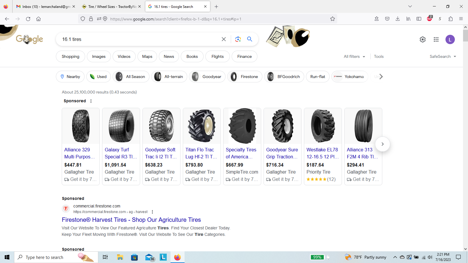

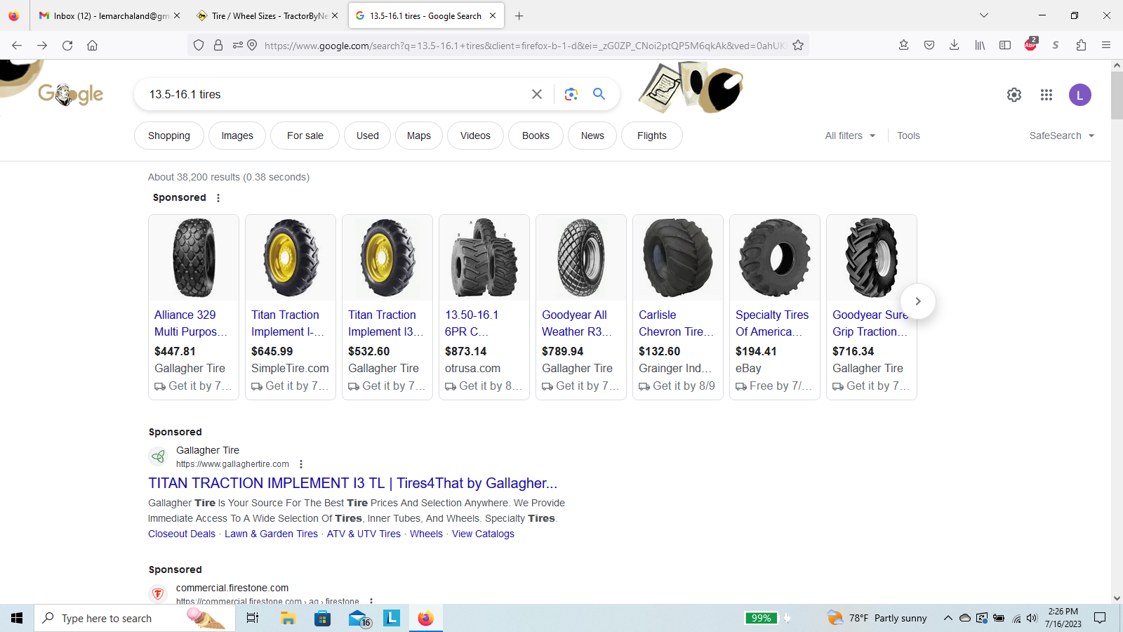

16.1 tires not restricted to 13.5
13.5-16.1;
