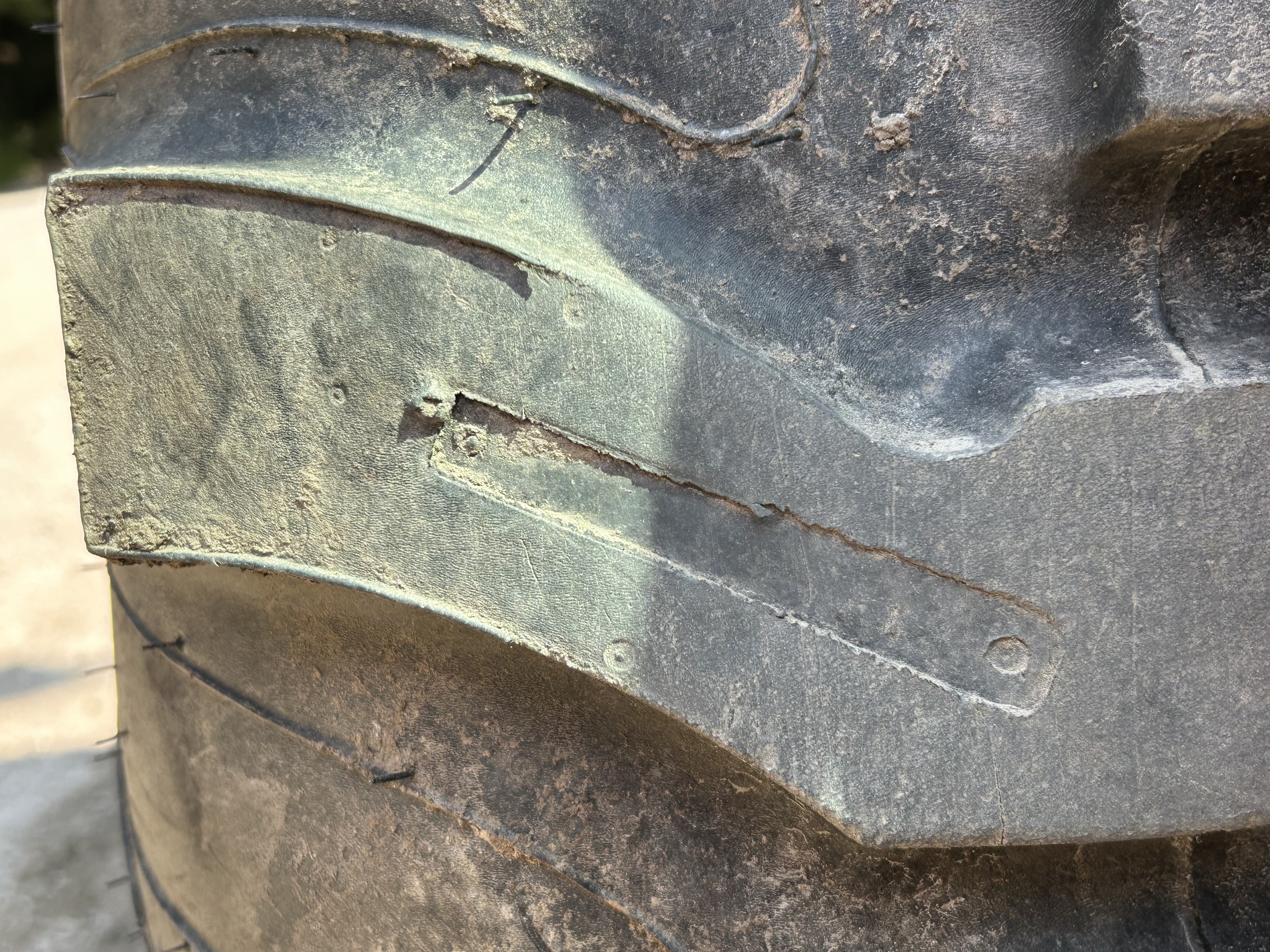

View attachment 962355On my rear tires (14.9- 24 R4) only has about 50% of the thread in contact with the ground. The instructions on the tires only say to not exceed 38 psi and the pressure is presently at 20 psi.
Wow. After 1,400 hours my M6040's rear tires look like new compared to yours.
Of course, 85% of the time there's something on the 3-point, but looking at the picture I can't help but wonder if you're spinning the rears somewhat frequently.
I don't use 4WD unless it's needed, which is when getting full scoops of dirt or rock with the loader, or when plowing if the snow is deep. I also don't drive it on pavement, which I'm sure helps.
If they are overinflated for the weight they are carrying then no doubt there is a lot more slippage than if the tires were aired down. The tracks the tires leave should show the entire width of the tire in good contact with the ground.

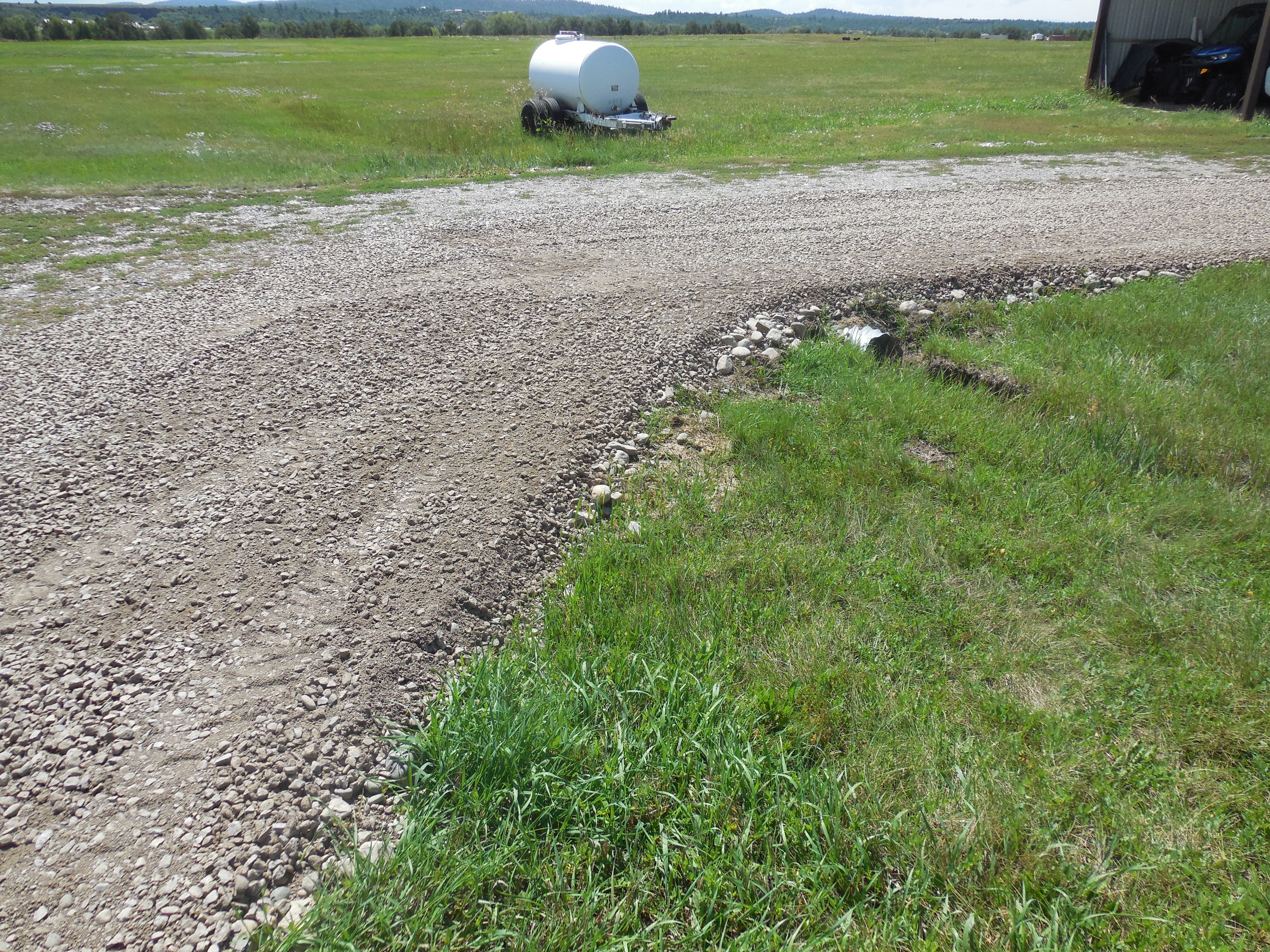

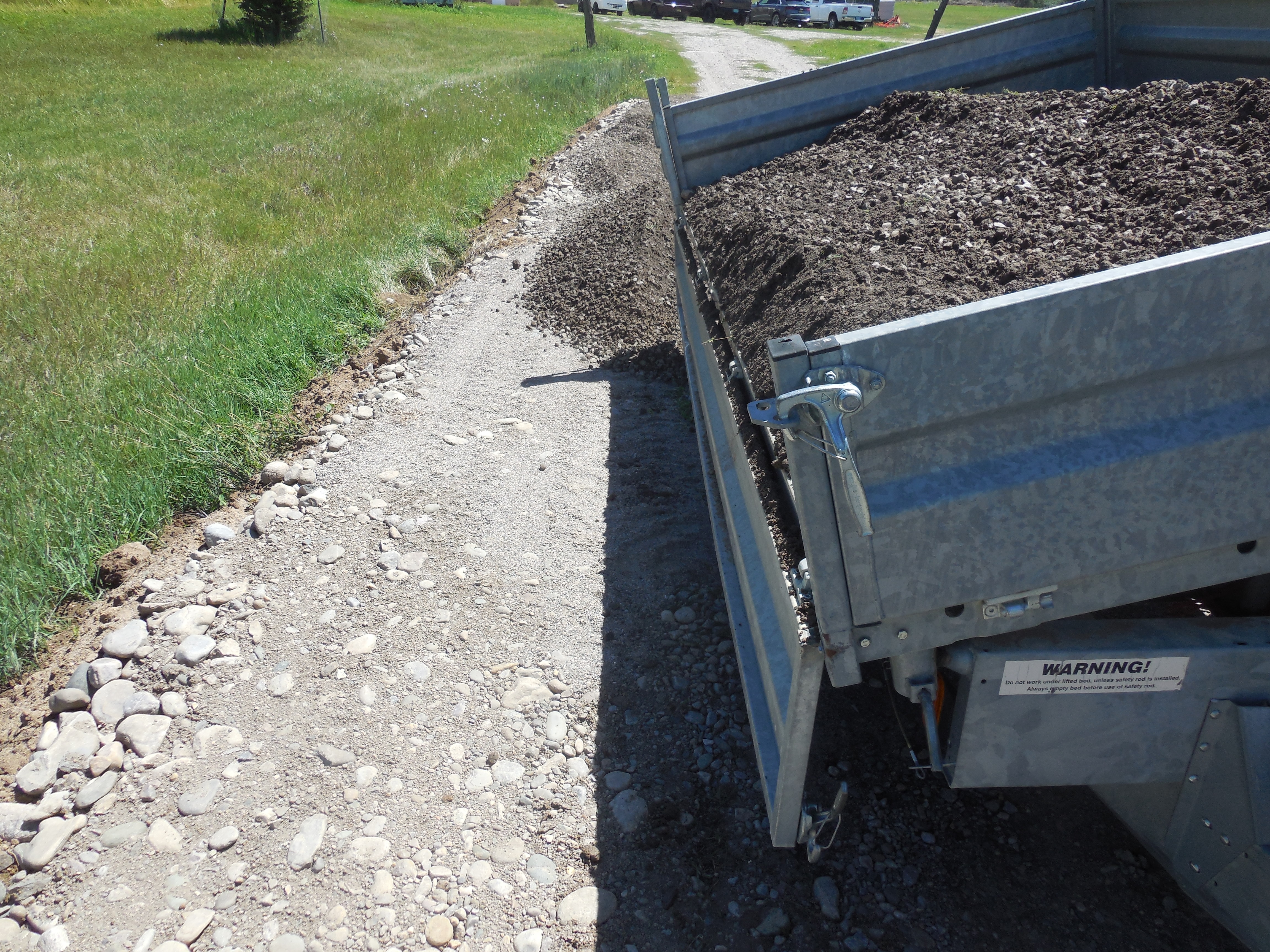

/ Tire pressure question #14
I moved 20 yards of 3/4” road mix which required 40 bucket loads of laying down the material and grading the road, total time running of 19 hrs. So I ran the tractor a lot on loose gravel which might account for the slippage. Definitely going to lower the pressure in the tires.

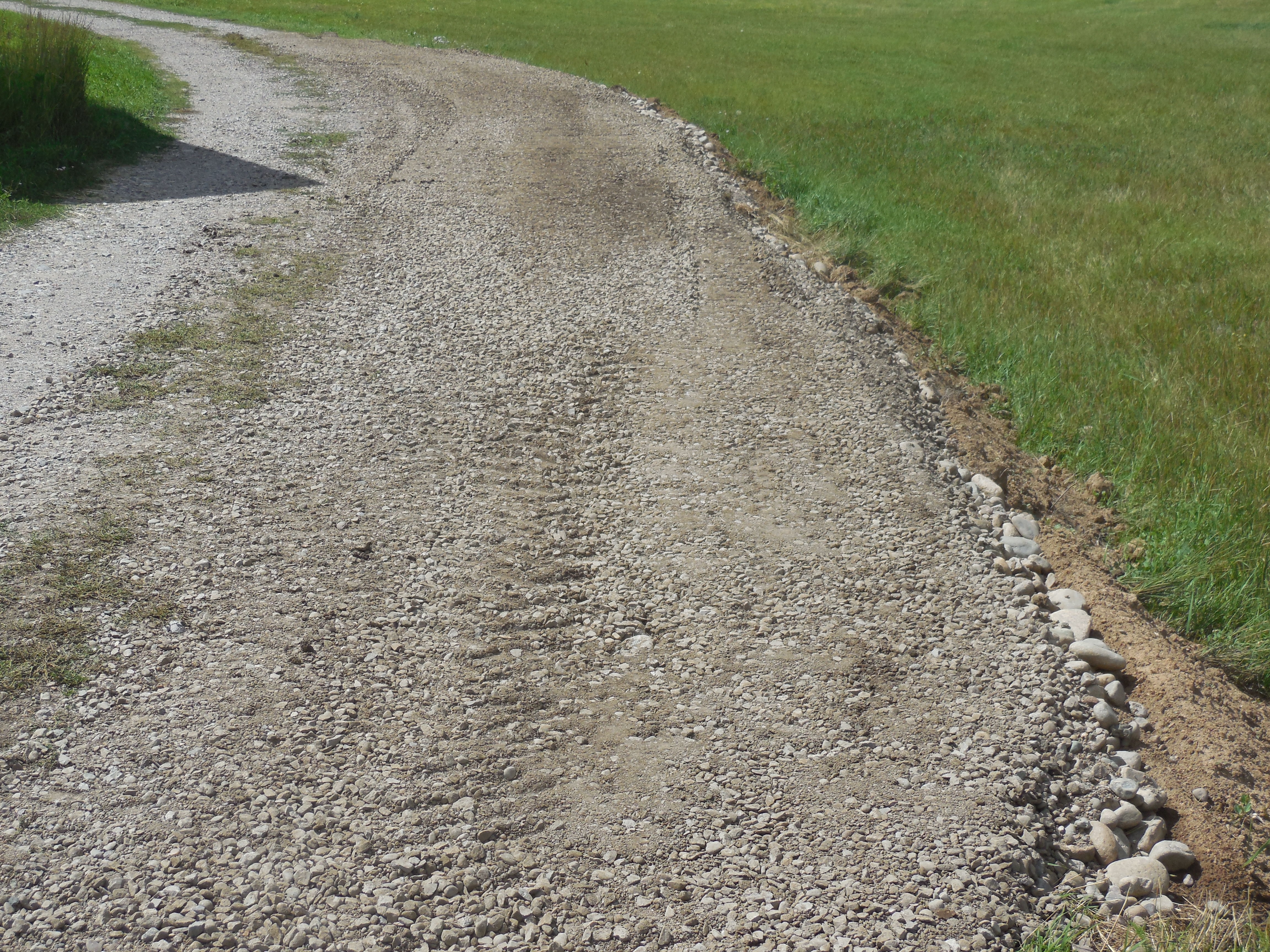

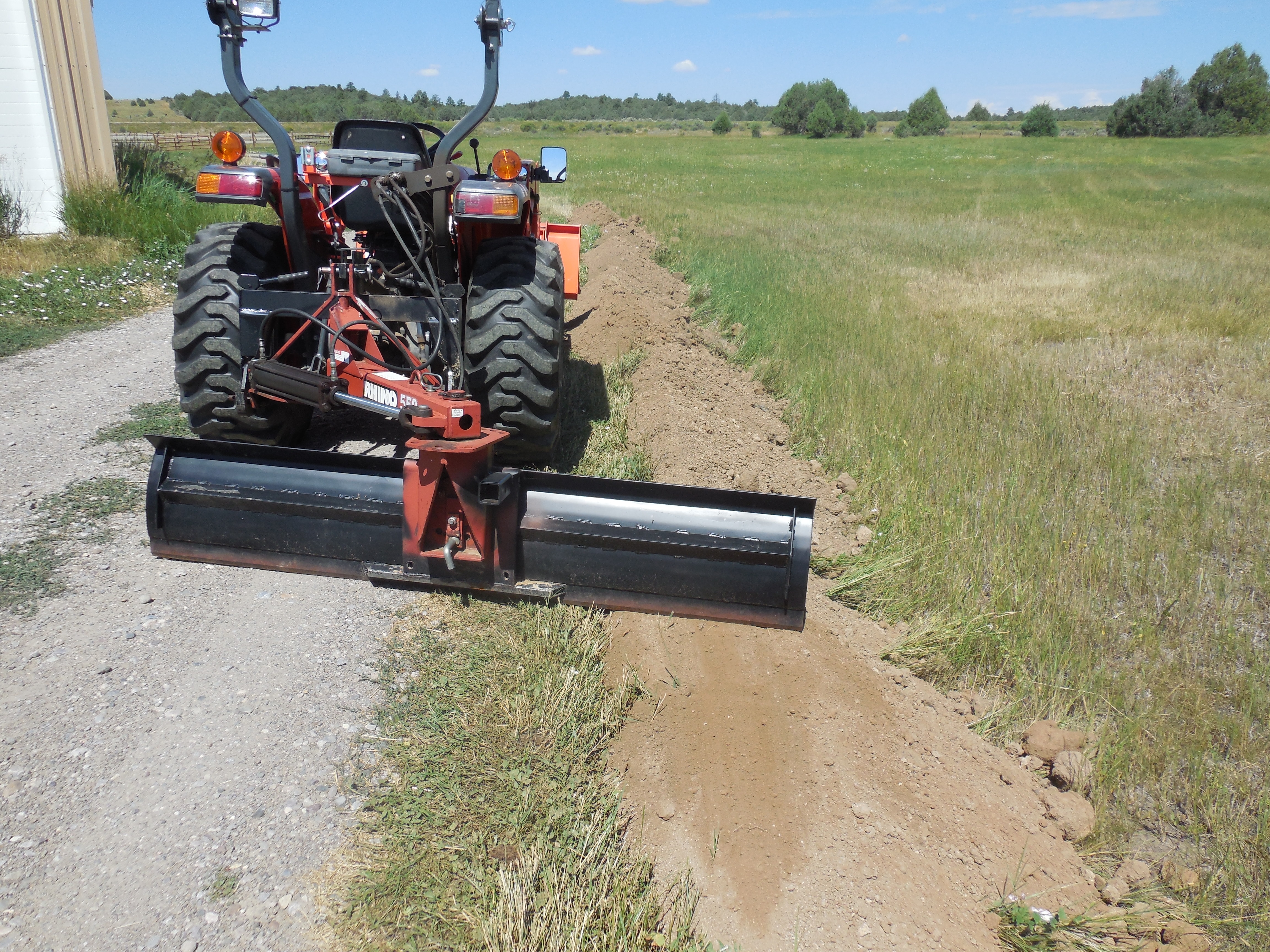

I'm close to finishing up some driveway fixes, having used dirt, 4-, and 1" road base. 13 yards of the 4- and 16 of the base.
I "cheated" and used the 10' dump trailer to move it all to where it was needed (love being able to dump to the sides), then used the L3800 with a rear blade and the M6040 with a box blade to spread it all, in layers.
Never had any issues with slipping tires with the 6040, but a couple of times I felt the rears on the much lighter (and R4 equipped) L3800 slip. Backed up a couple of inches and engaged 4WD. I really don't like spinning the tires.
Anyway, I'd think there must have been a lot of tire spinning going on to make tires look like that in 19 hours, regardless of how overinflated they were. Unless they were bad before starting that project.

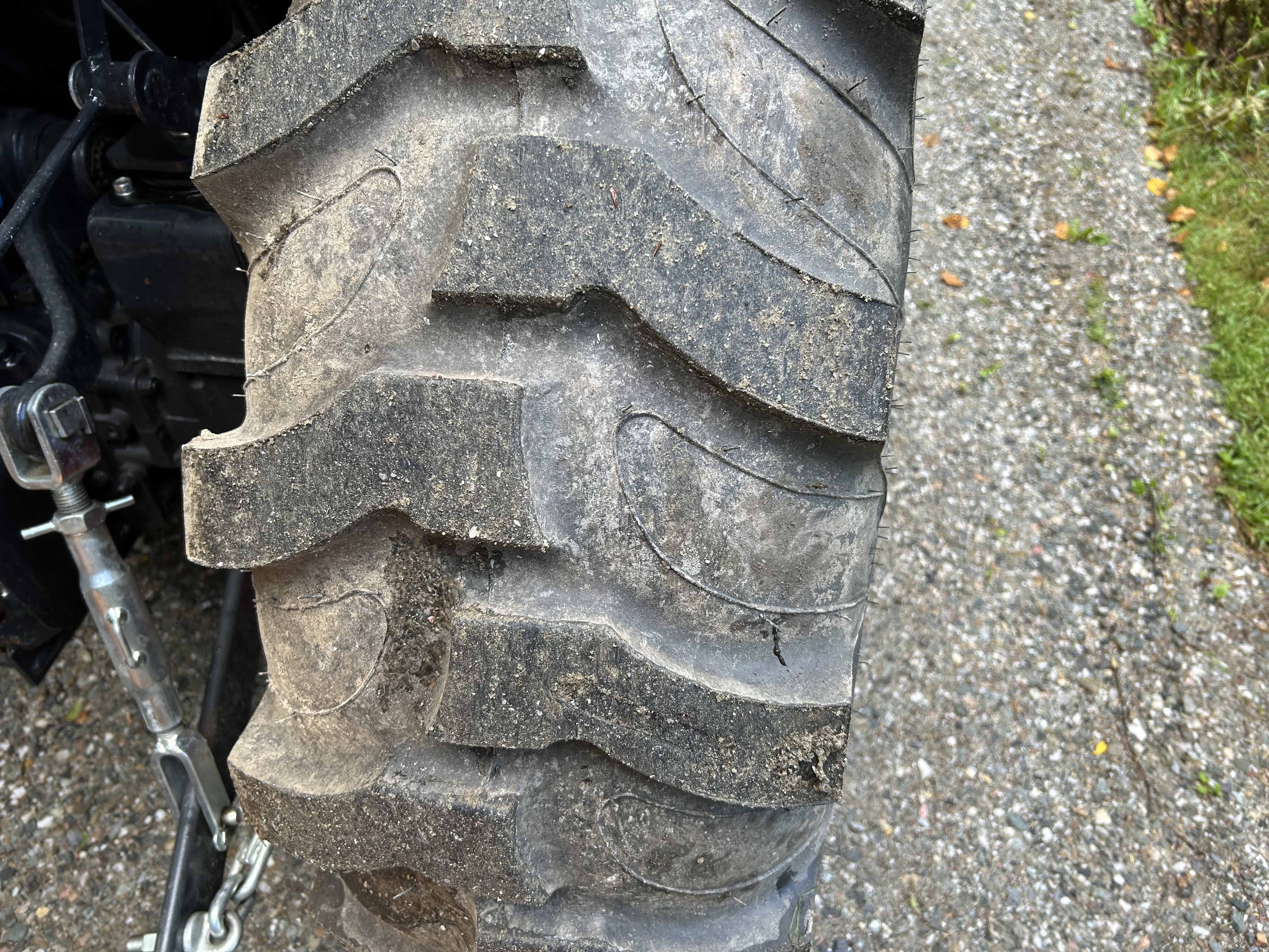

Anyway, I'd think there must have been a lot of tire spinning going on to make tires look like that in 19 hours, regardless of how overinflated they were. Unless they were bad before starting that project.View attachment 975265View attachment 975266View attachment 975267View attachment 975268View attachment 975269View attachment 975270
The wear on your rears look right. What is the tire pressures?
I hate to admit it, but I don't recall ever checking it. I'll be happy to find out for you later today or tomorrow.
That one is a '13 with only some 560 some hours on it so I'd expect the tires to still look good.
Can't say the same about the fronts, though. They're about half gone already, which is much like how the older (about the same size) little Kubota we had. It consumed fronts but not rears.

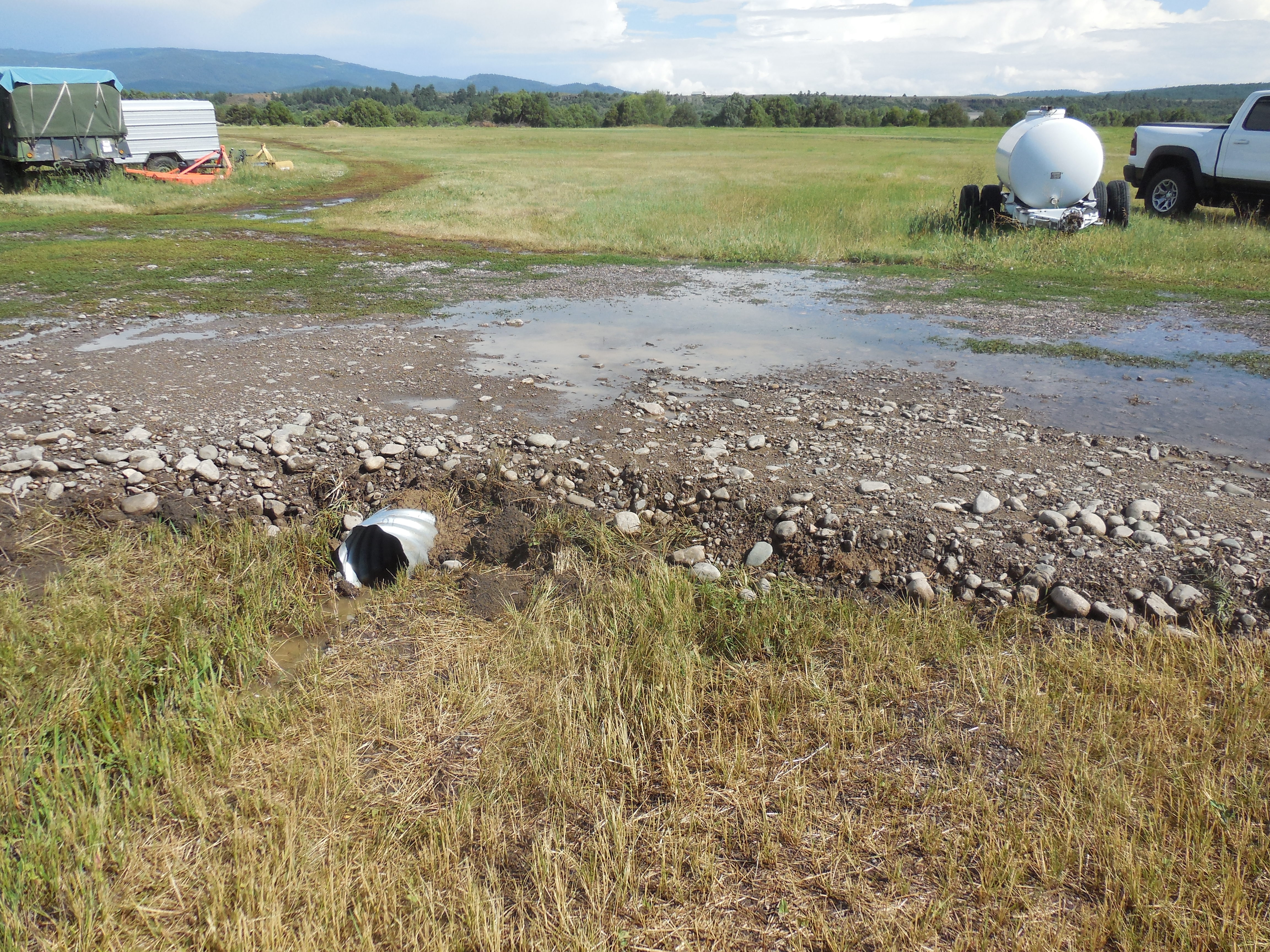

Fixed the last part of the driveway today, by the way. That low spot over a culvert always got the better of me when plowing. That the driveway's slope increases as it gets closer to the road is bad enough for my operator talents.

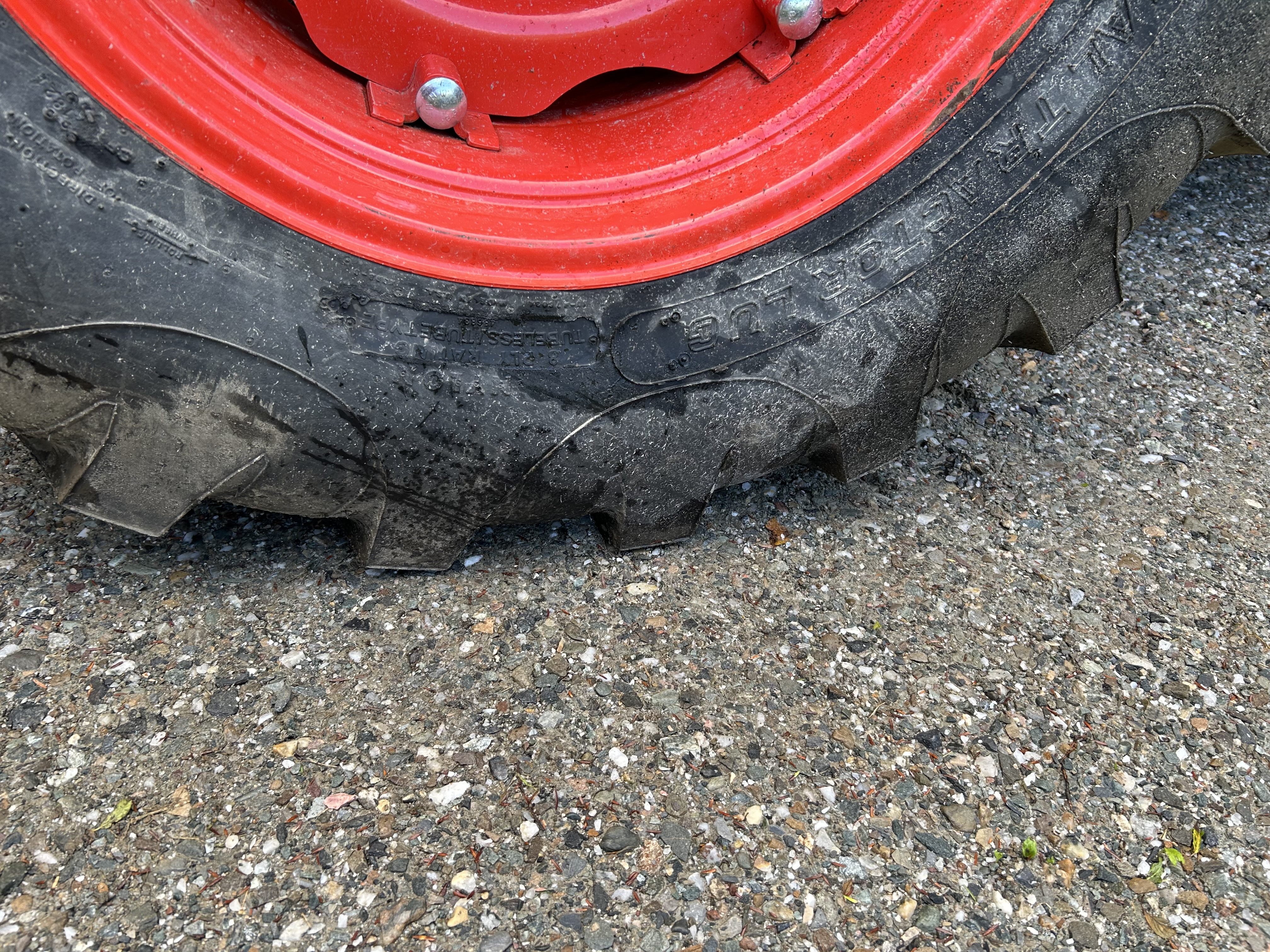

I changed the rear tires pressures this morning. One was 22.3 psi the other was 24.2 psi and changed them both 12.0 psi at first. 12 psi only changed the tire contact from 50% to 75%. So I dropped the pressure to 10.0 psi and this gave me full contact. Going from the original pressure to 10% didn’t noticeably change the sidewall profile. I ran the tractor about a mile at each adjustment the get a dirt profile on the tires. Also noticed that the tires were spinning because tire inflation stems were always in different locations relative to each other.
