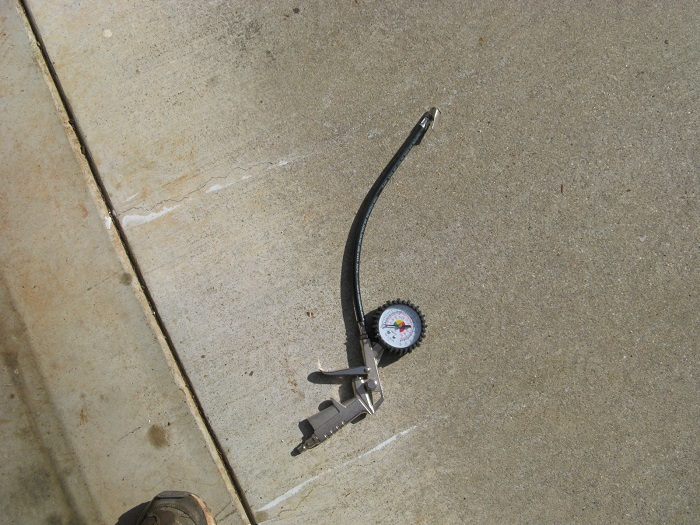

Harbor Freight air gauge. Best ever. The long line from tire to gauge can be easily purged between measurements.
