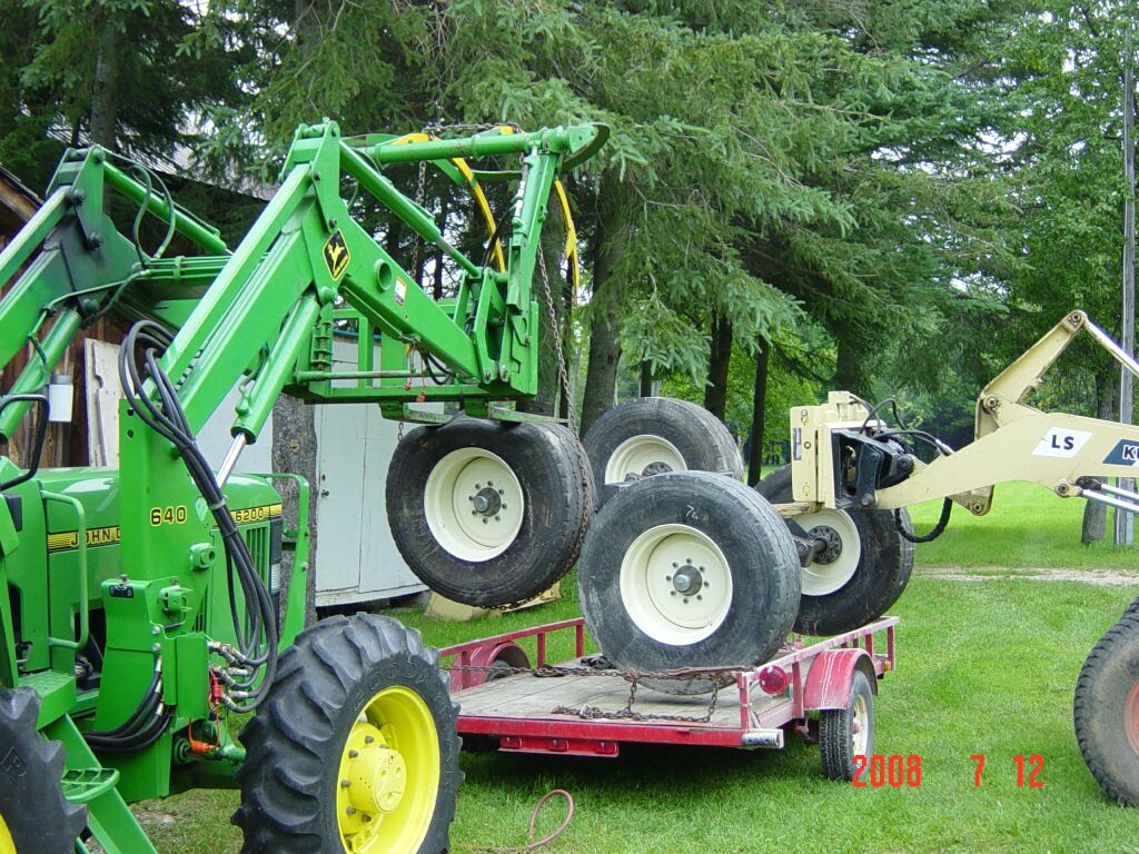

Trying every trick in the book to get those tires back on. I (stupidly) let the air out hoping that undercarriage would sit better on that little trailer for transport.

Remove tire, drive to local tire shop, drive home half hour later. I’ve used the ratchet strap trick for implement tires. It worked, barely. Not well enough to think it would work on a tire like that. It’s worth $20 to prevent the aggravation.

Well, I ended up using two ratchet straps on the tire -side by side.
I had those cheap ones you can get at Lowes or Home Depot. I used an adjustable wrench to hold onto the ratchet mechanism - this increased my leverage considerably - and I was able to crank down on the tire until it sealed.
Hooked up the compressor, added some air until I saw 5 psi and I knew it was holding air at that point. Released the straps and filled it up.
