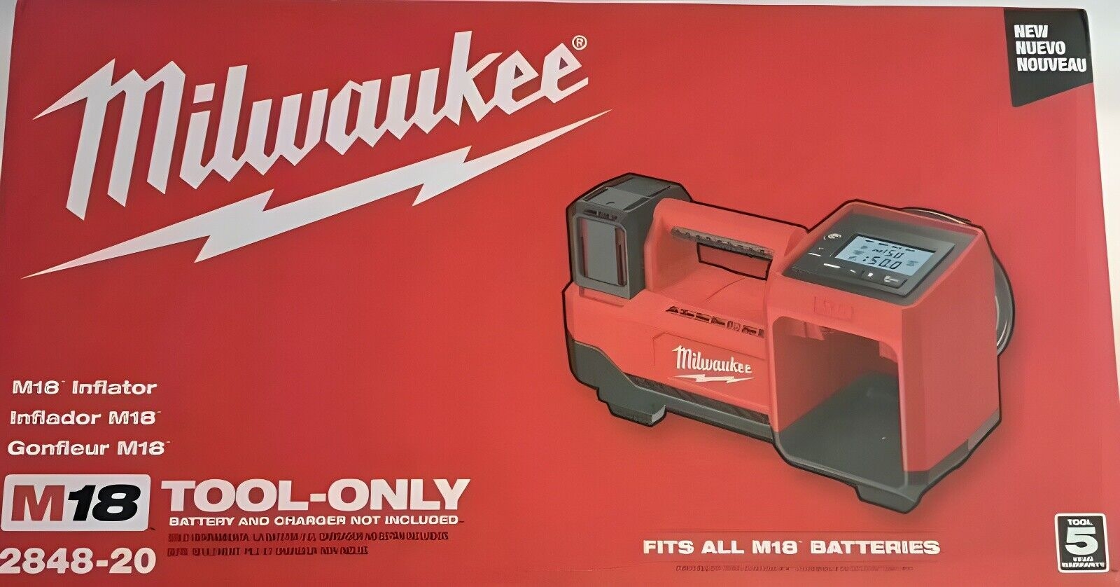

Like "Workinonit" said ..... the best money I've spent in the last couple years was for the Milwaukee M18 ( It retired 4 compressors I now do not use )
I have one of those and love it for using around the property but I don't want something that big taking up space in my truck. I keep a little $20 Slime (or equivalent) pump in all my vehicles because for the one flat I get every 5 or so years that's all the space I want to give up. It'd be a different story if I were offroading and needed to air up & down frequently.

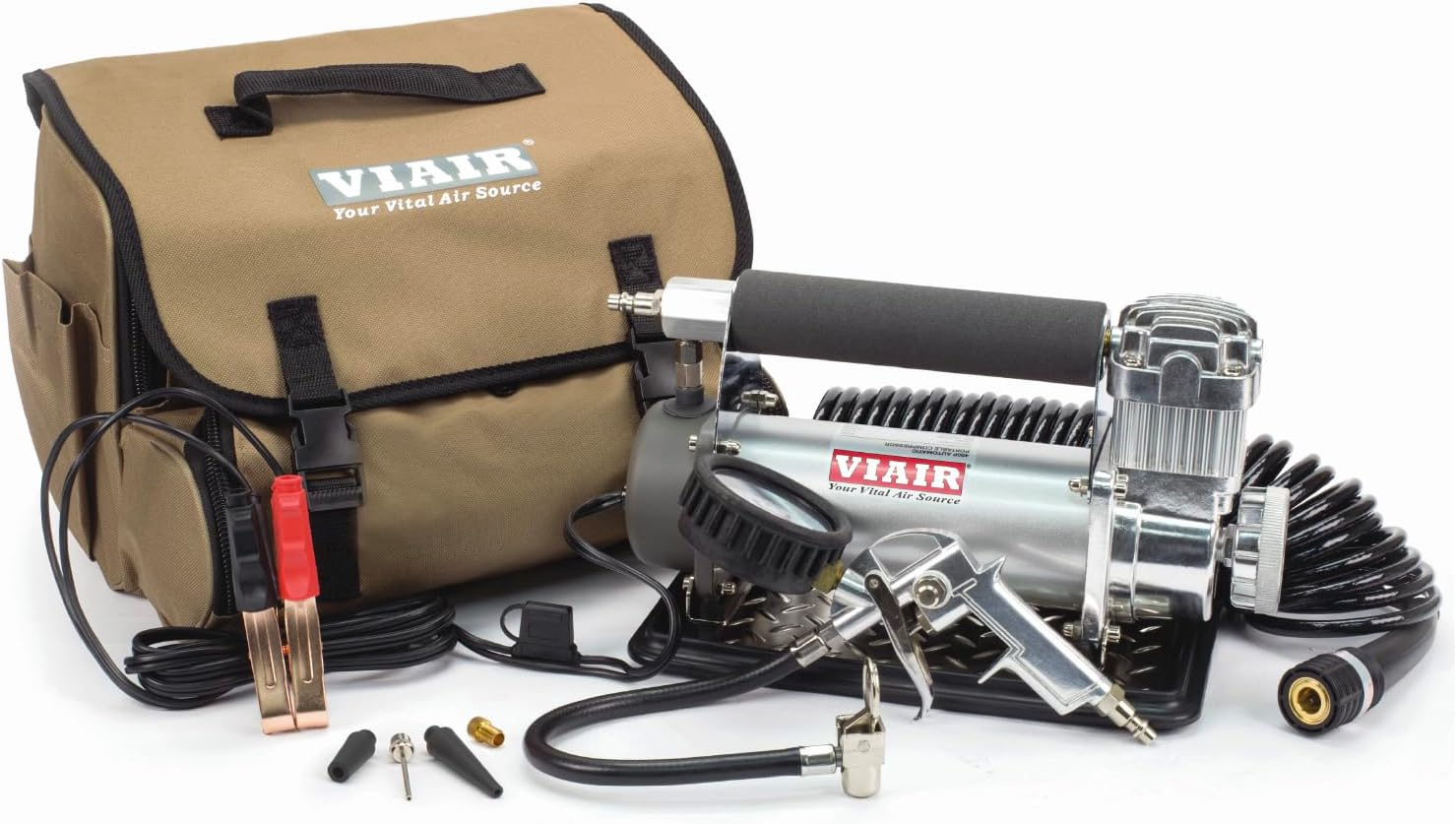

I frequently reduce my pickup tire pressure when on sand or soft ground. To speed up the re inflation time, I use this ViAir portable 12V compressor:
It also comes in handy for small air tools or inflating air mattresses, rafts, bicycle tires, etc.

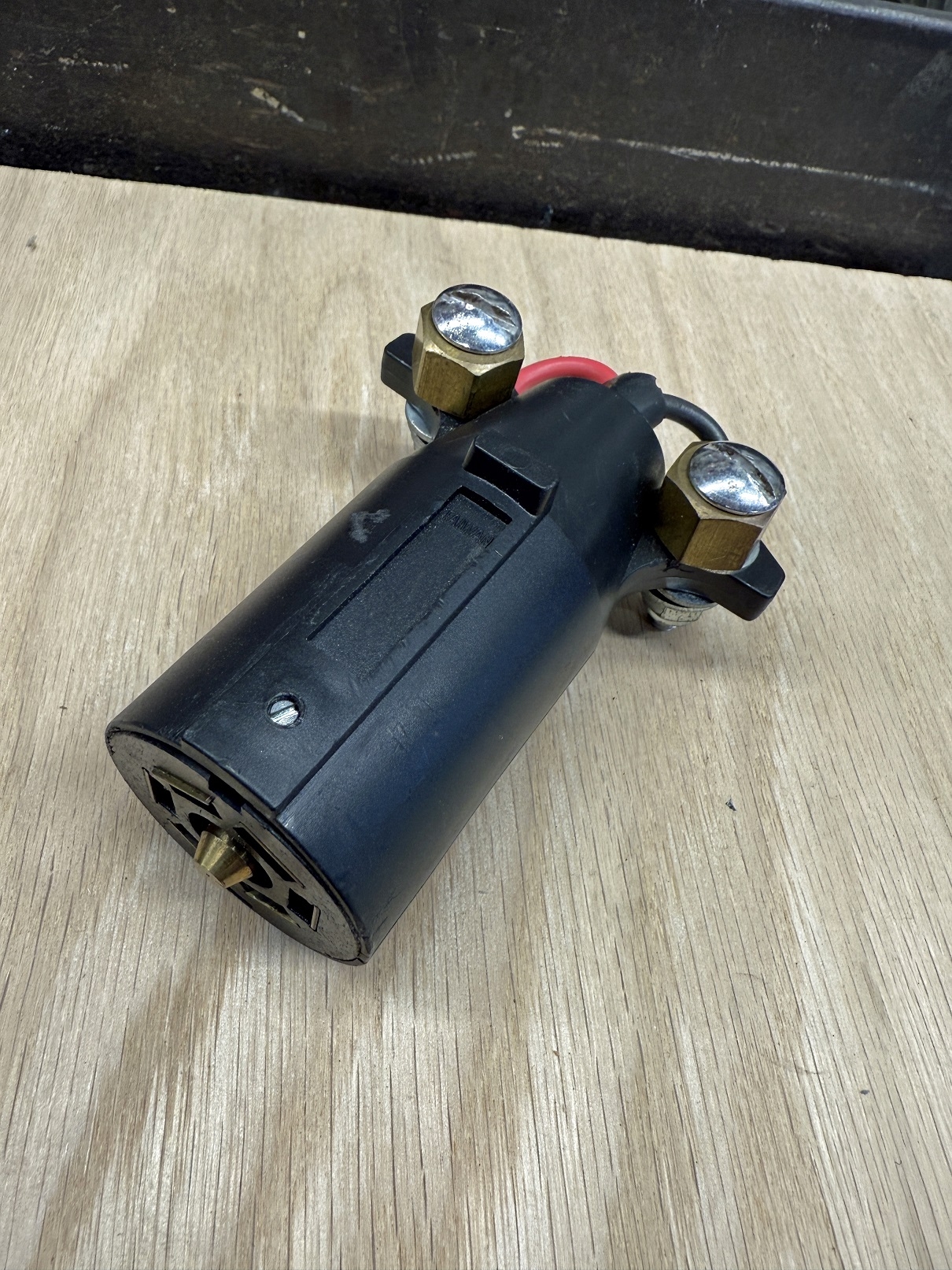

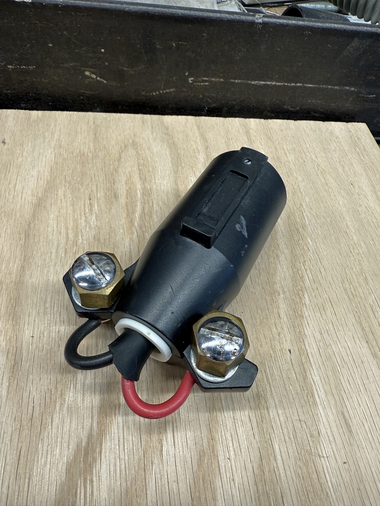

Instead of having to pop the hood to connect the compressor to the battery, I made up this adapter that plugs into the vehicle trailer wiring harness socket. Makes a convenient place to attach the compressor alligator clips. It's a standard 7 pin connector, wired to the 30A trailer aux circuit which is protected by the OEM under hood circuit breaker.
View attachment 4454147 View attachment 4454148
I have the same Viair kit. 400 something with a high pressure cut out. Had a similar adapter only to an Anderson plug. Might steal your trailer adapter idea. I tend to mostly use it for the 5th wheel rather than move it up to the 5hp shop compressor.
I'm likely to pick up a cheap tiny Ryobi 18v compressor for the car. The Viair is just to big & heavy to leave in there & I only need it for emergencies. I have a ton of Ryobi batteries anyway.
