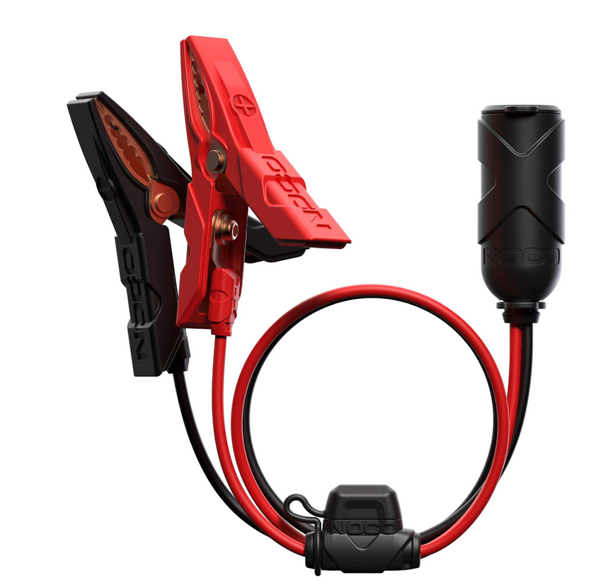

If the unit you have uses a male cig plug, what about a alligator clip to cig adaptor?

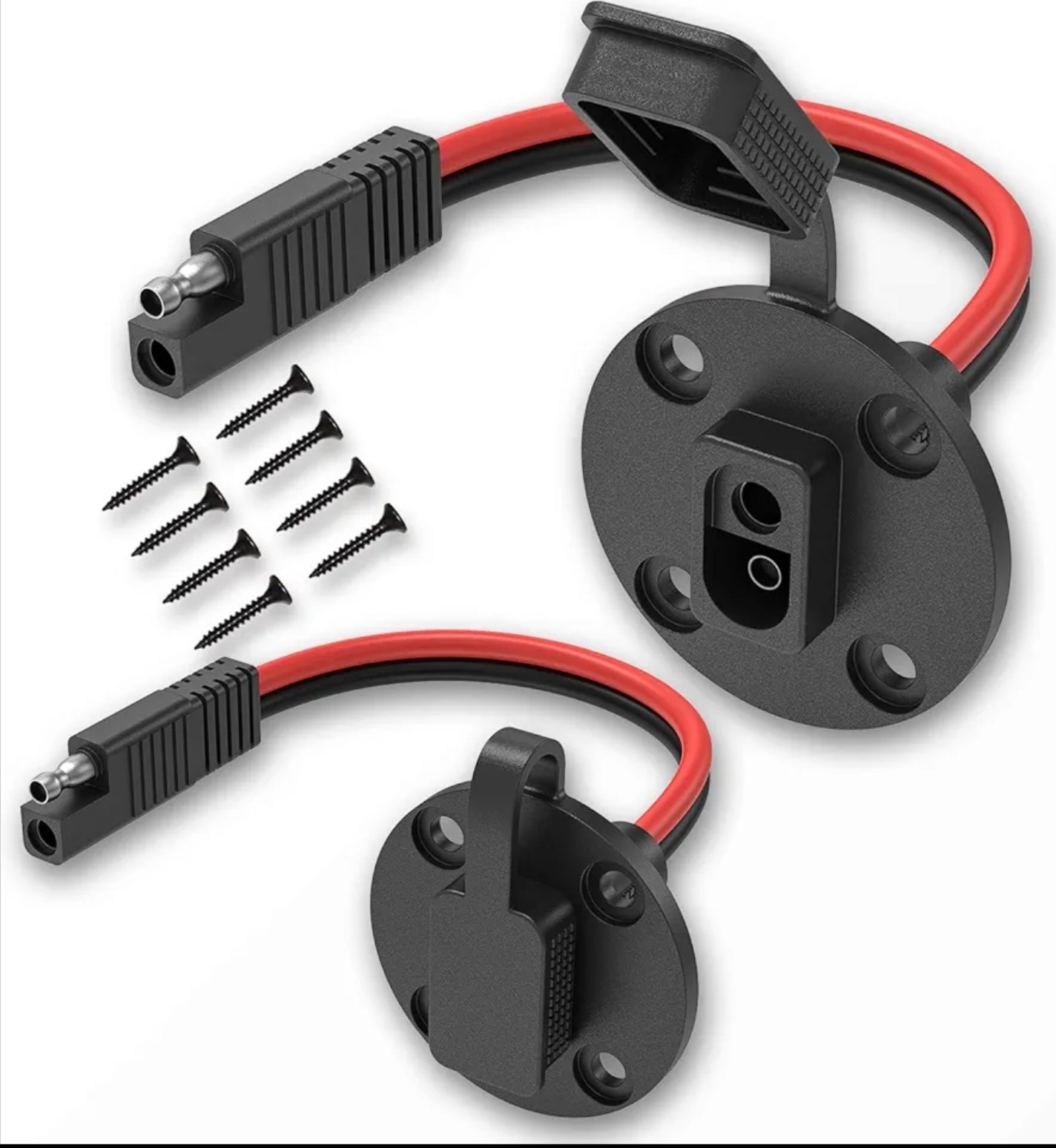

I install sae flange connectors for access to 12v power. Can plug a charger into it, or get power from it.

or a $10 pigtail adapter that clips direct to your battery like booster cables.
Leave it in bag with your existing inflator and bobs your uncle.
No mess or installation required and can use existing stuff you already have.

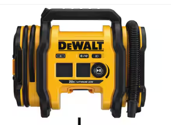

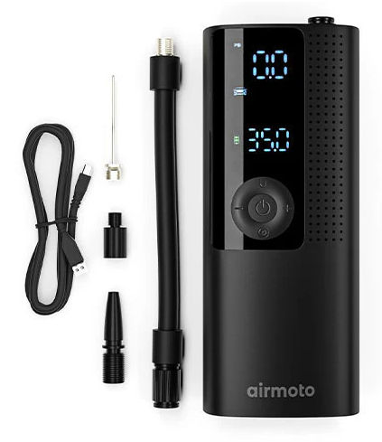

I keep a Dewalt 20V inflator, 20V 1/2" impact, the 20V power pack, and a spare 4AH battery in my truck. I have an Airmoto inflator for the 2 SUVs. It charges off the USB-A plug on the console.
