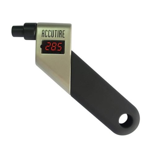

Our horse trailer tires require 110 PSI, some digital gauges don't go that high.
I bought an Accutire gauge at Sears many years ago, had a 5 year warranty, The center pin that opens the valve in the valve stem is plastic and wears out. Every three or four years when it quits opening the valve, I take it to Sears and exchange it for a new one.
Works good gets the same pressure reading as the one in my truck. Accutire Gauge | Standard Digital Tire Gauge and Programmable Digital Tire Gauge

Xfaxman that looks like what I'm looking for. Thanks.

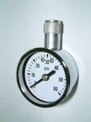

I haven't used anything but this style since I discovered them in the 60's.
No failures.
