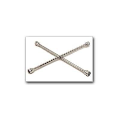

I would use a 4 way lug wrench
Easy and perfect.
