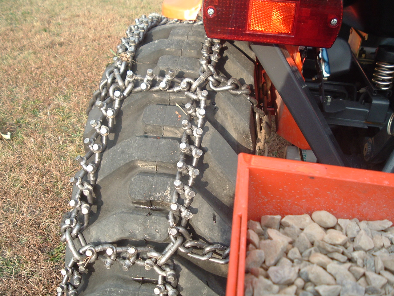

I have studded snow chains that work well on ice: DSCF1416.JPG
/ Tire Chains #5
Im looking to buy the same tractor and have looked into chains. IF you have the industrial tread(R4's?) its a unique size and only a few styles fit them. I only looked on tirechains.com though, so maybe other sources have more options for those tires. IF your on a hill, wouldnt hurt to have chains on the front, just for steering purposes. Roy mentions using the rear brakes to steer, but as you know, this model doesnt have independent wheel braking so that wont work. IF you get them soon, update this with what you get and how you like them.
Whistlepig, those are sweet looking chains, where did you get them?
