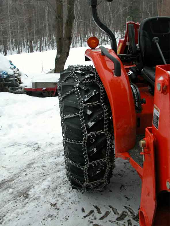

Jon -- I guess it sort of depends on your terrain and your type and amount of snow. I have a steep dirt road and driveways, bitter cold (-30) early in the winter and sloppy cold (25 to 35) late in the winter. Plenty of ice and snow ranging from light and fluffy to wet and very heavy. In my experience double ring are great in wet sloppy stuff or mud, but not on ice. For ice, the best IMO is a chain that gives you a continuous contact with the ground.
I use Valby ice spikes (attachment) but the current generation is a lot lighter and easier to handle at 120# per side than the 300# per side monsters I had on the L3010. So far, I've not noticed any decrease in grip.
Ice is tough. You need something that has edges if you want any significant grip. V-bars and ice spikes come to mind. The duo-grip and double rings just don't have the edges you need.
