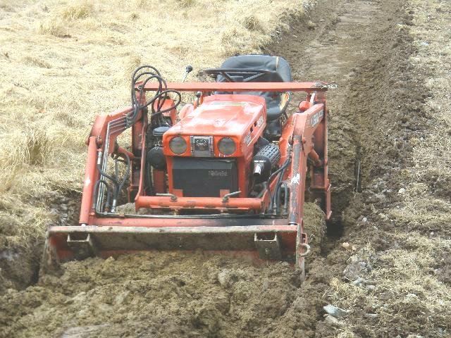

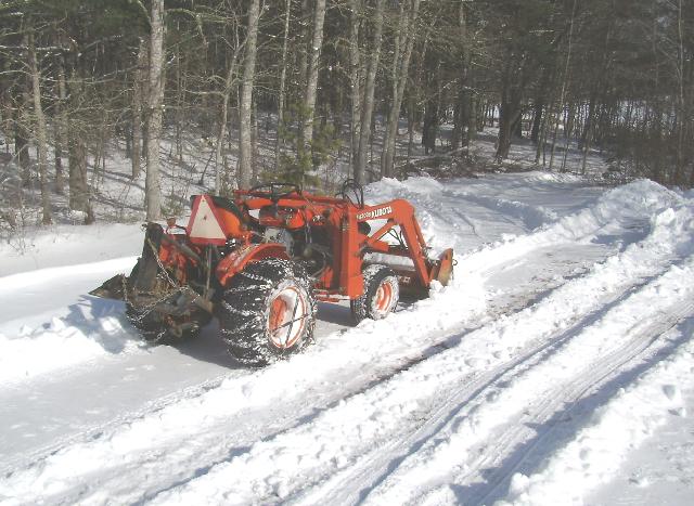

Chains in mud and snow.:D :D

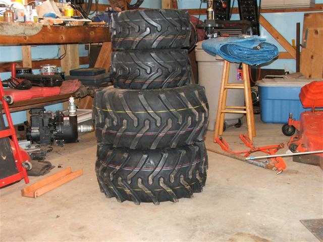

/ Tire Chains or Better Tires? #9
If you go with tires for the BX, the cheapest I found was through the Kubota dealer, this set, four wheels and tires was ~$300 ordered through whole goods. I don't have turfs and I use these to mow the grass also, not hard on the lawn unless I turn sharp or in 4WD.
