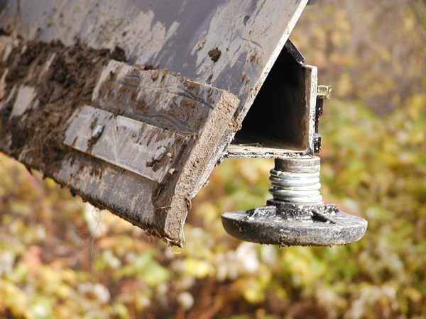

Mike, I'd be wary of plowing in float any time. I learned my lesson on a solid block of ice that nearly tossed me in the bushes when the seat tilted forward on impact. At least the only thing that got bent was the blade. :)
Also it didn't take me long to toss those silly caster wheels in the corner and put on some tried and true snow plow pucks. The difference in performance turned the blade into a serious plow. It was just impossible to regulate the plow clearance with those spongy caster wheels. The blade was either too high or digging in. Those dog-gone wheels must arrive in Tazewell by the boatload - they tend to show up all over PT's attachment lineup - and in on the blade they just don't work.
Here's a link to how I mounted the pucks.
PT-1845 Plow Blade Improvements

I plow my paved driveway in float all the time with the blade riding on the asphalt. No visible markings after 5 winters. I would do it on gravel, too, but with the blade set about 1.5 to 2 inches and riding on the wheels.
Perhaps this works for me because my blade is only 60" wide and the tires can support it better than the big boys' blades. ;)

Wow, cool post Sedgewick! Great pictures.
I will have to go kick those tires, but I think they're solid on my blade (I won't be able to do that for a couple days, I'm "in town" for a few days yet). I tried it out on some pretty rough trails and it worked out ok. Dug out and threw a couple rocks though.:eek:

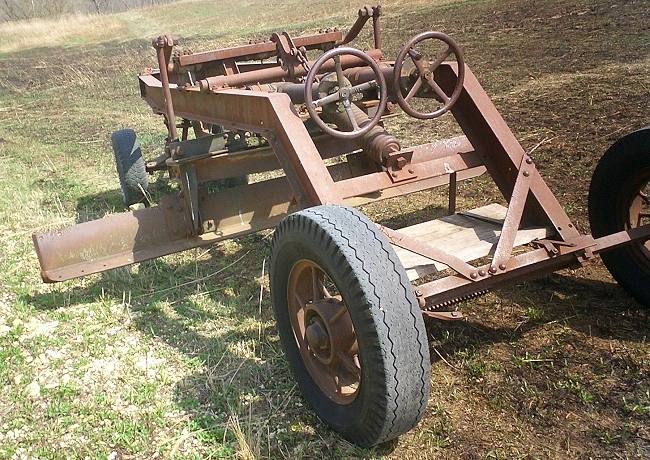

Oh, for MossRoad's paved driveway -- I'm a gravel guy too. But I think it's gonna be ok. my usual approach is to plow a little high for the first few snows to build up a layer of snow and ice, and then get a little more aggressive and bring the blade closer to the driveway once I've got a couple inches of water between me and the gravel.
Then, in the spring, I drag the township's road grader behind my tractor and regrade the drive. I've attached a picture of it. It's got to be at least 250 years old.
