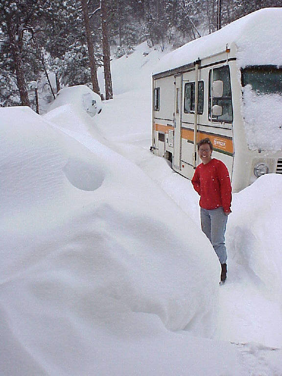

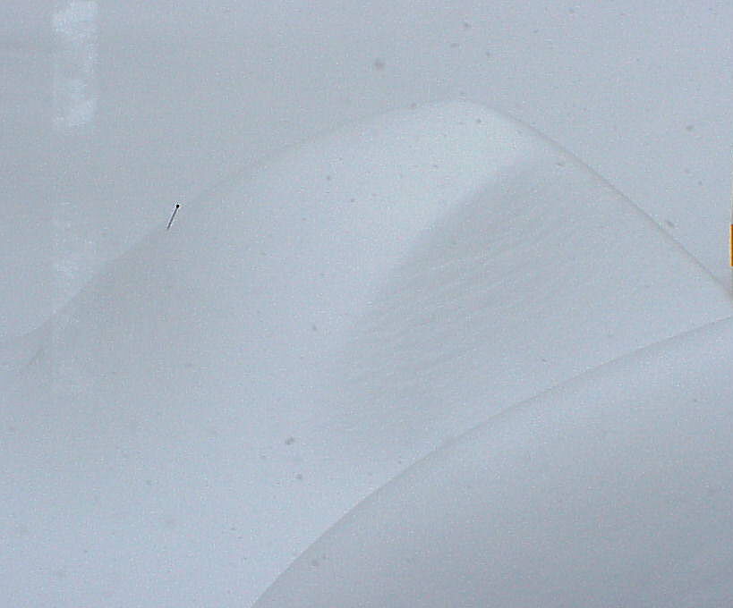

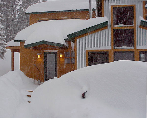

Here are some pictures at the 3' level during the first storm. The add'l. 6' came in three more snowfalls within three days of each other.
The pictures are:
1 - Our car; you can see a bit of the antenna
2 - Our antique motorhome, which is where we live while building a house.
3 - The house after about 4' of snow
