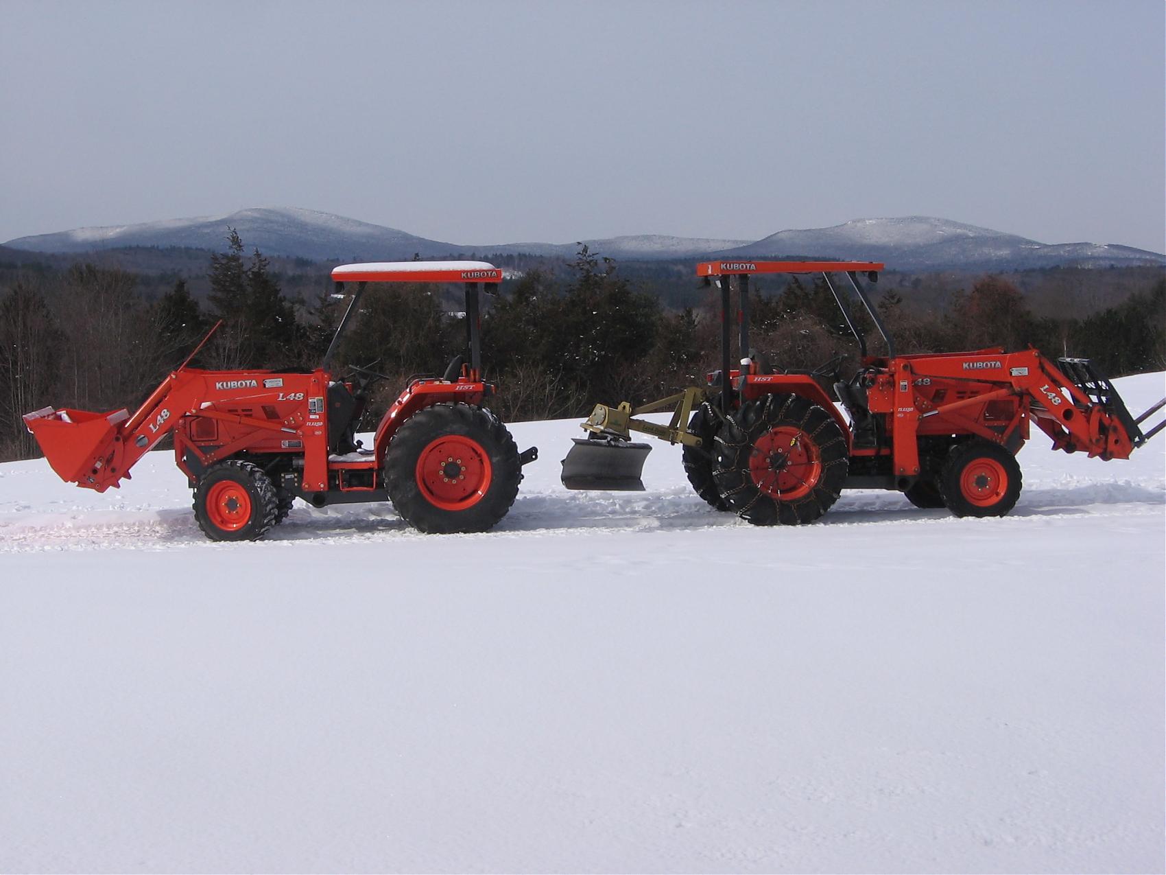

Search my threads about chains on L48s. Not impossible, but pain i the arse. Here is one of mine chained up:
