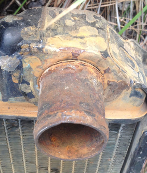

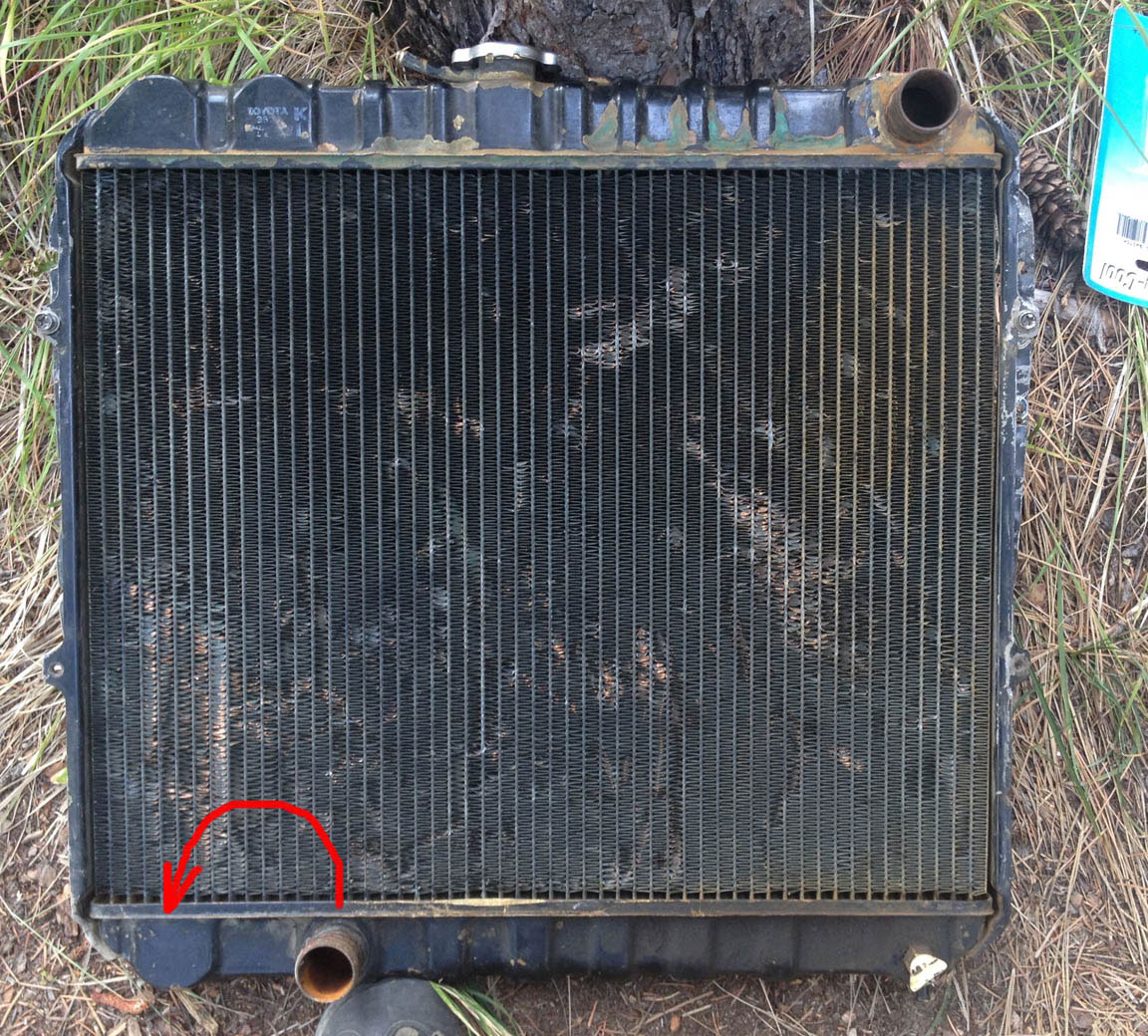

I need to move this radiator outlet. My plan was to unsolder it, pull ot off, cut a hole and solder it in, then solder a brass cover over the old hole.
I was planning to just use flux & solder from my plumbing kit. I've done lots of plumbing with copper, but never soldered a radiator. I will be paying good attention to avoid melting the long seam between the tank and core.
Any tips?
Where can i get a piece of brass to cover the hole?
Where can I get 'new' outlets? (would like a size 3/8" larger)
This inlet leaks, you can see the broken solder joint, it had a sealer on it which I peeled off. Is it likely that I can get this clean enough to re-solder?

If that joint is that bad, the core is likely messed up too. Anyway, sure, with a torch you could heat that up enough to twist and pull it, but dropping it off at your local radiator shop will likely be far less of a hassle.

Why does that hose bib look like it is made from carbon steel. Most radiators I have seen, that is brass also. Clean it up good after removing the hose bib and flux it good with solder flux and it should solder up really well. Don't heat it more than needed to make the solder flow around the joint so you don't disturb the tank top.
If the core is stopped up a bit, this may be a good time to rod out the core or at least get it boiled out by a radiator repair shop especially if you have some problems getting the solder joint to hold.
Gary I was surprised about that too. Going to a radiator shop is at least an hour, and $200 and doesn't satisfy my urge to 'fix something'. Besides today I'm blowing money like there's no tomorrow (2014 F-150?) and have to take some lumps.
By what I can see thru the filler hole, the core looks 'clean'. If it behaves under the torch I think I could be done in an hour (but of course that always takes 3 hours).

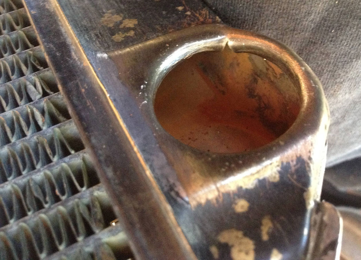

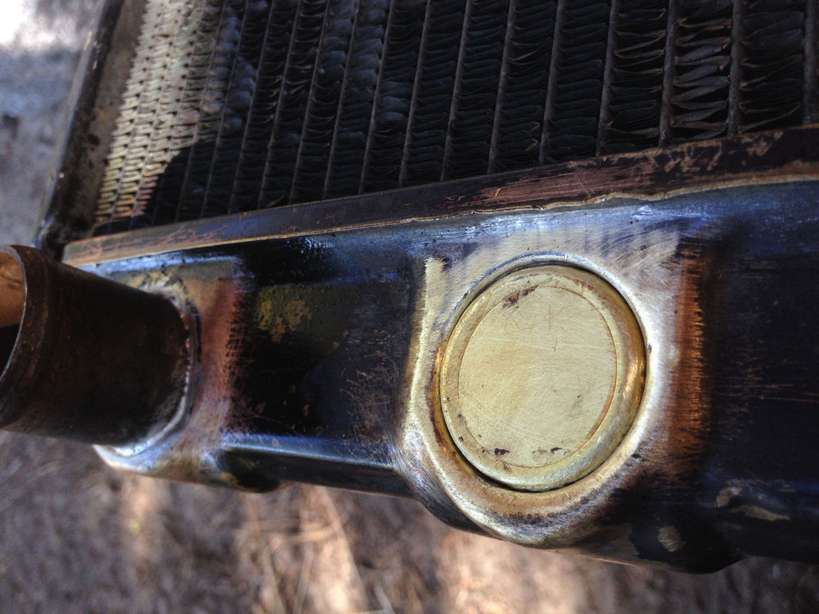

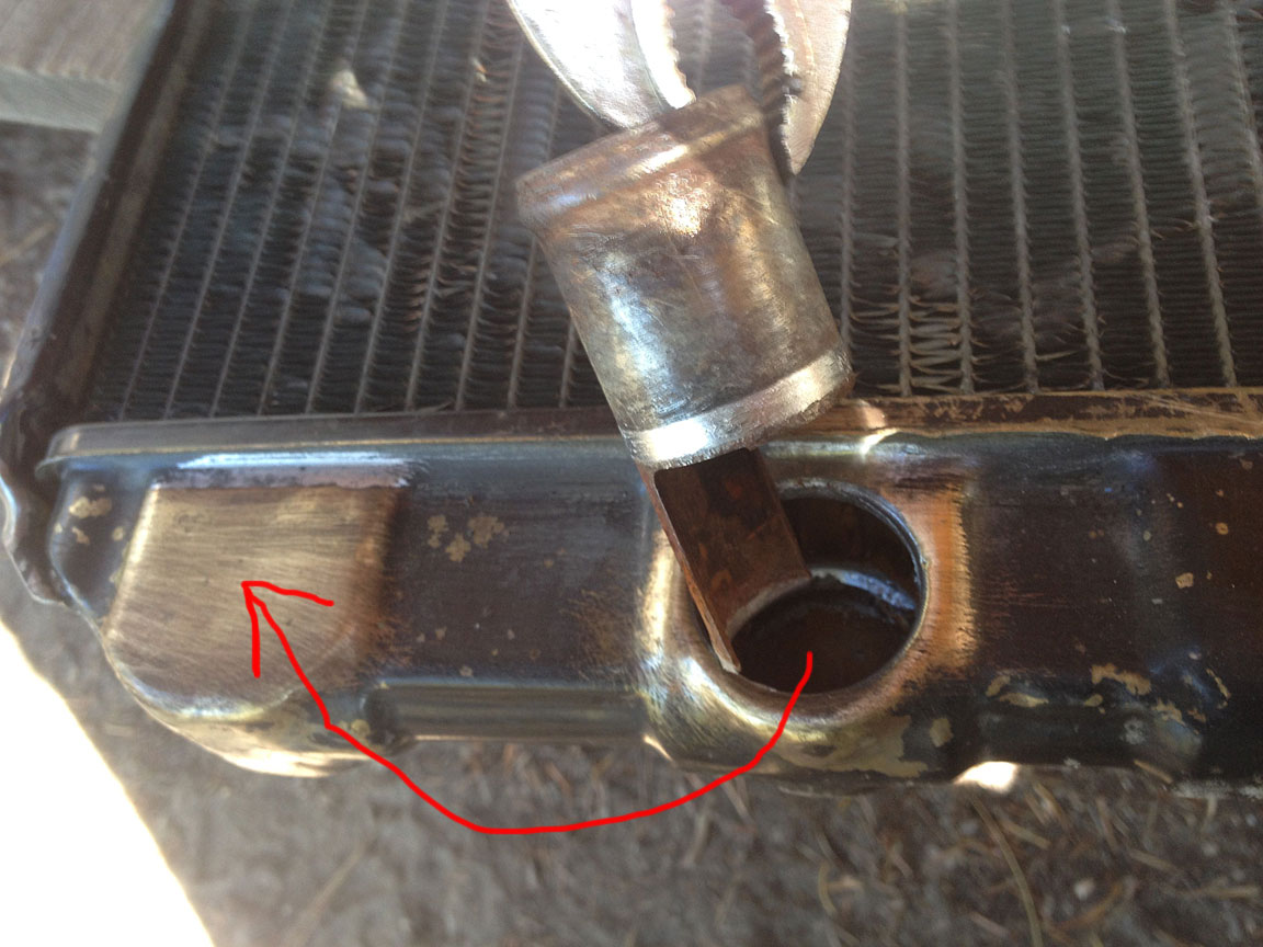

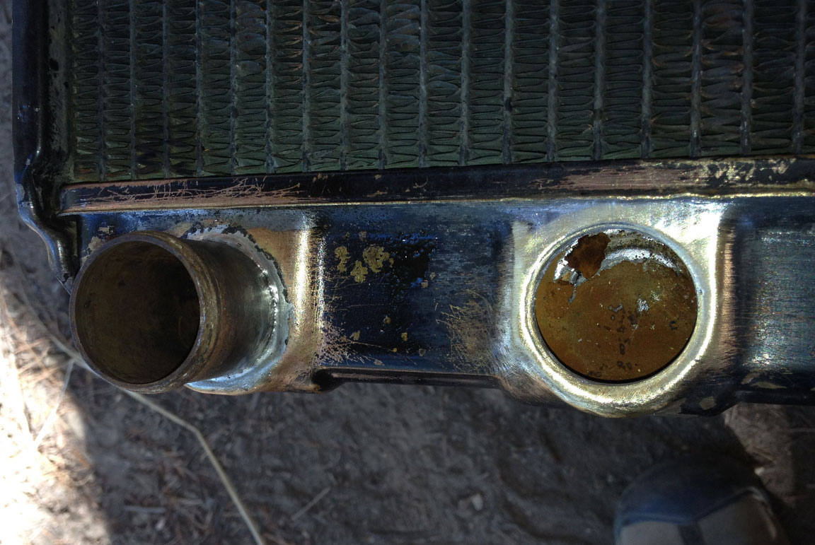

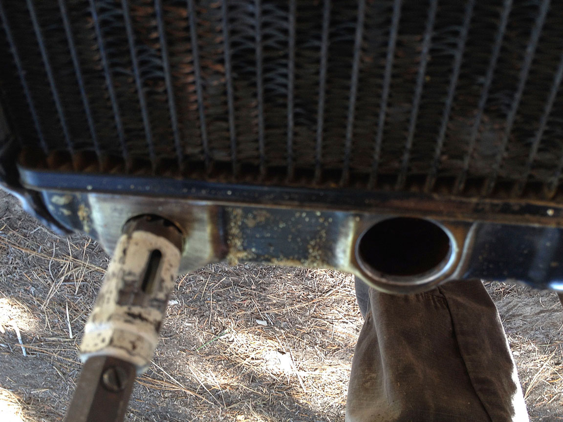

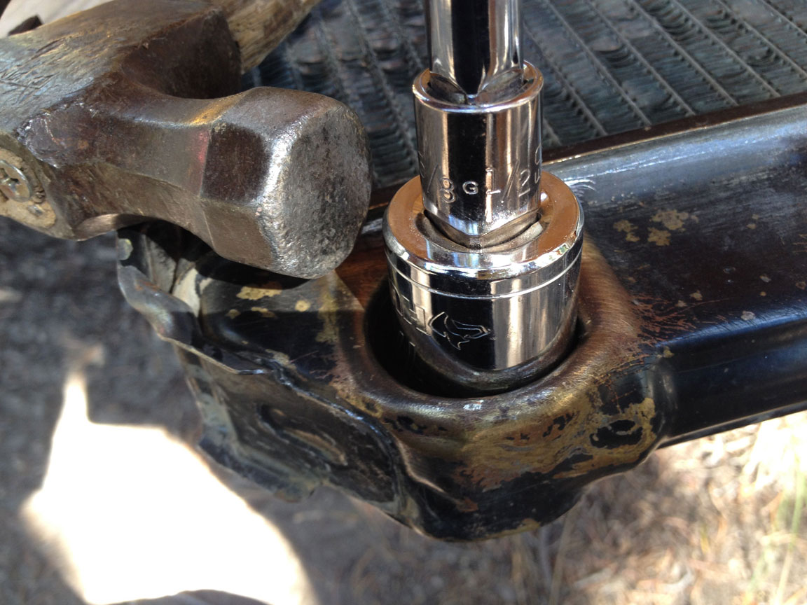

OK I tackled this project today. Thanks you guys for the tips. This took about 3 hours.
Heated and removed outlet
Drilled a 1" hole because that's the only holesaw I had. The outlet is 1 3/8"
Used a hammer and a socket to bang a lip onto the hole, while enlarging it. Hole looks similar to original.
Material started to tear. I probably should have filed the hole out to a larger starting diameter (larger than 1").

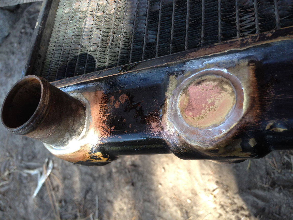

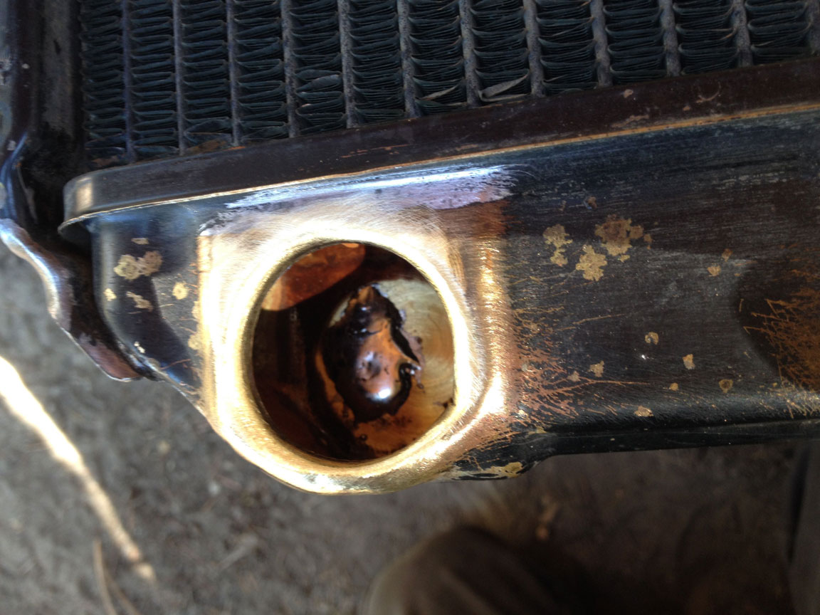

Pre-tinned the other side with a blob of solder to hold the outlet nipple's support.
First soldered the support to the backside. Then soldered the outlet nipple into the new hole.

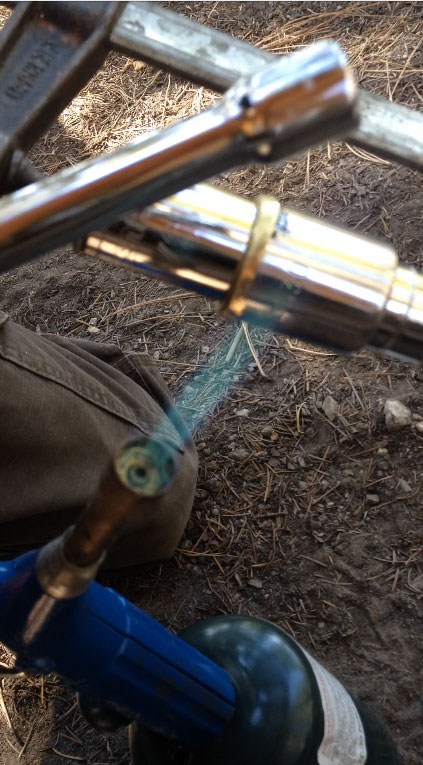

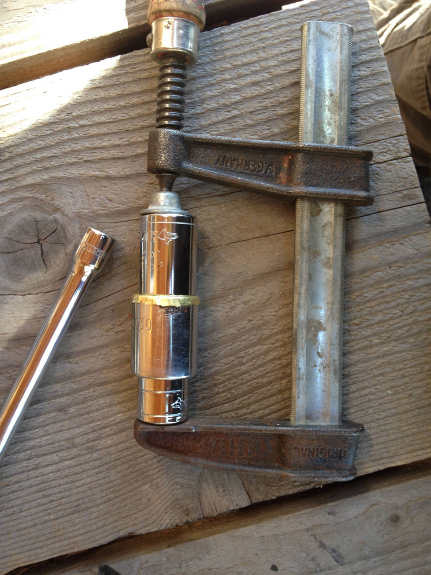

Bought a sheet of flat brass at the hardware store for $7. Cut out a disc and clamped it between a couple sockets to form the plug. It was not working as I hoped, so heated it and it formed better. I used a socket extension as a 'hammer", lightly tapped o the brass a few hundred times to get the shape I wanted.
Pics of the socket/clamp arrangement to form the plug.

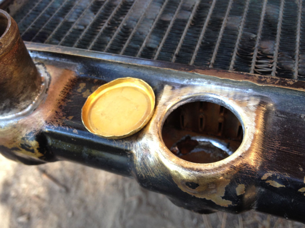

Plug ready to go in.
Plug pressed into the hole.
Plug soldered into the hole.

That my man, is a super well done job,
you certainly have talent.:thumbsup:

Looks like there might be a pinhole in the new inlet location. How did the pressure test go?

Thanks Gary. 50 mile drive, didn't leak a drop!
