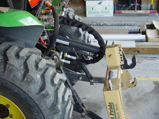

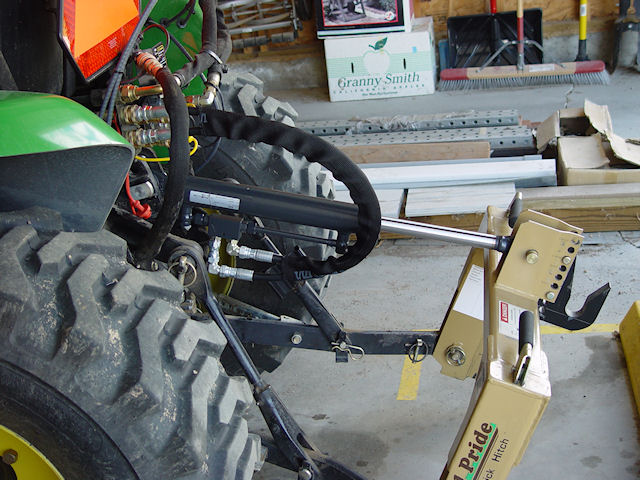

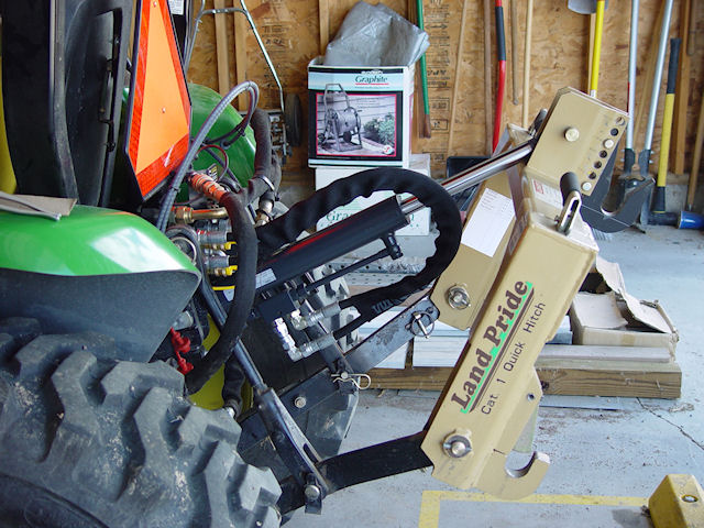

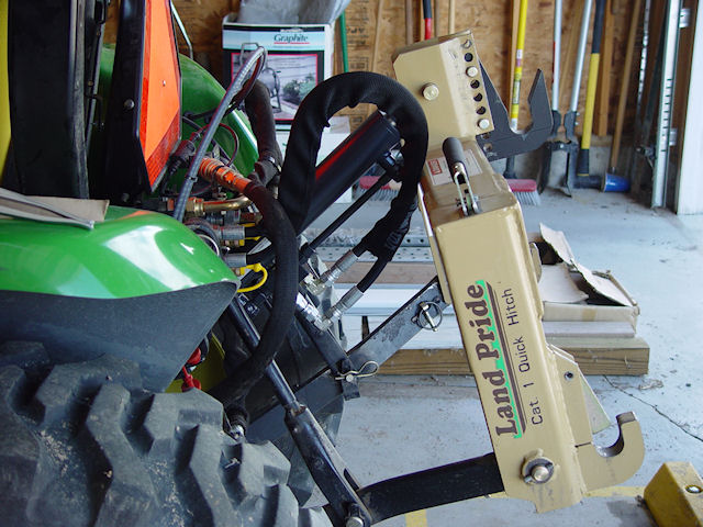

Since CCM is busy with hay season, I ended up getting the longer Cat 1 toplink cylinder from Surplus Center that KennyD posted the link to.
I would like to get an unpainted 4" or 6" cylinder for the sidelink minus the ends; but with the check valve and banjo fittings.
The sticker nmu98 posted way back when is the same as the one on my cylinder.
I think CCM & Surplus Center get their cylinders from Domingos prekyba as I found the check valve and cylinders on their web site.
I just took these photos today.
My sincere thanks to KennyD for his hydraulic wisdom concerning my setup.
