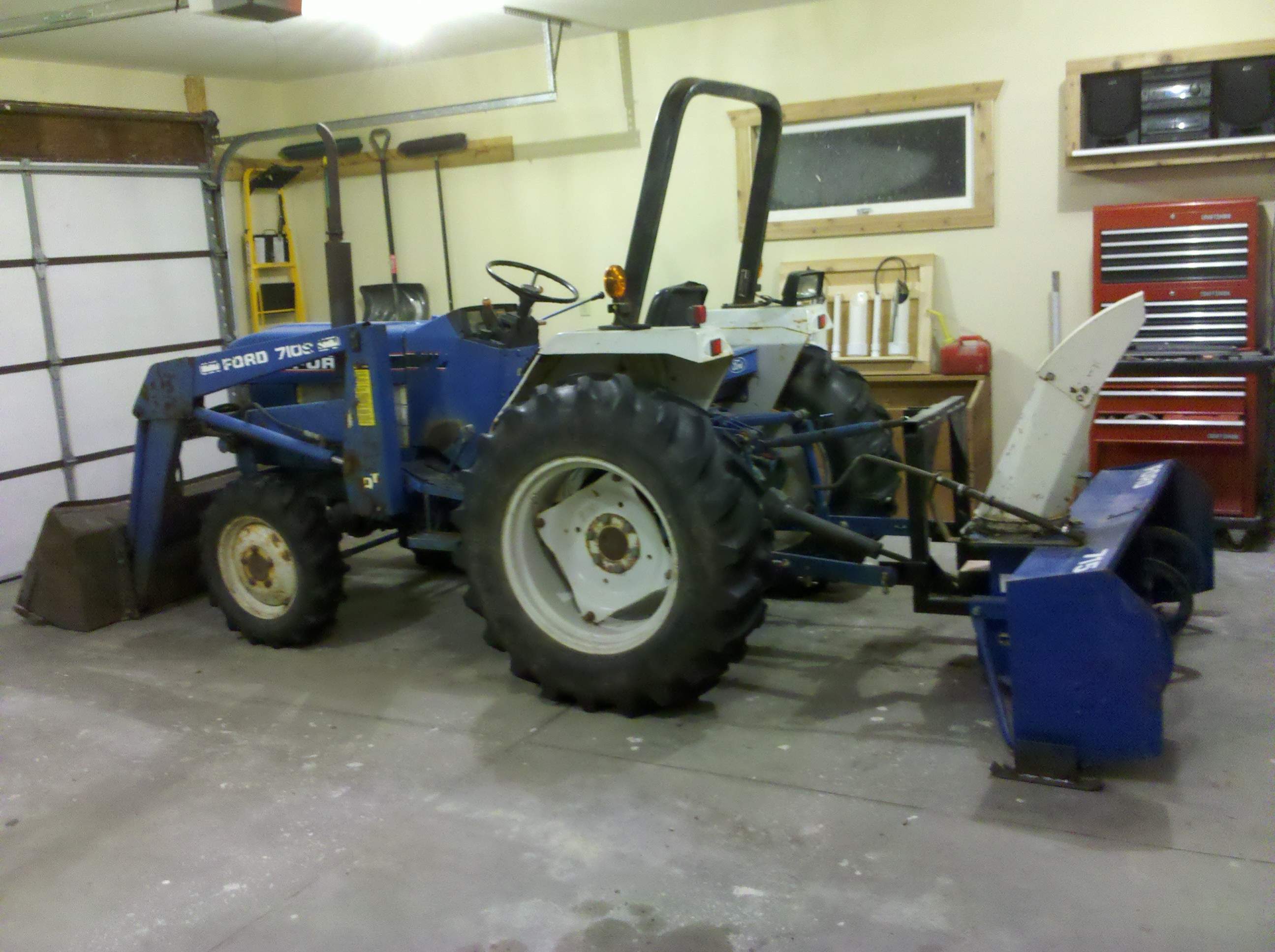

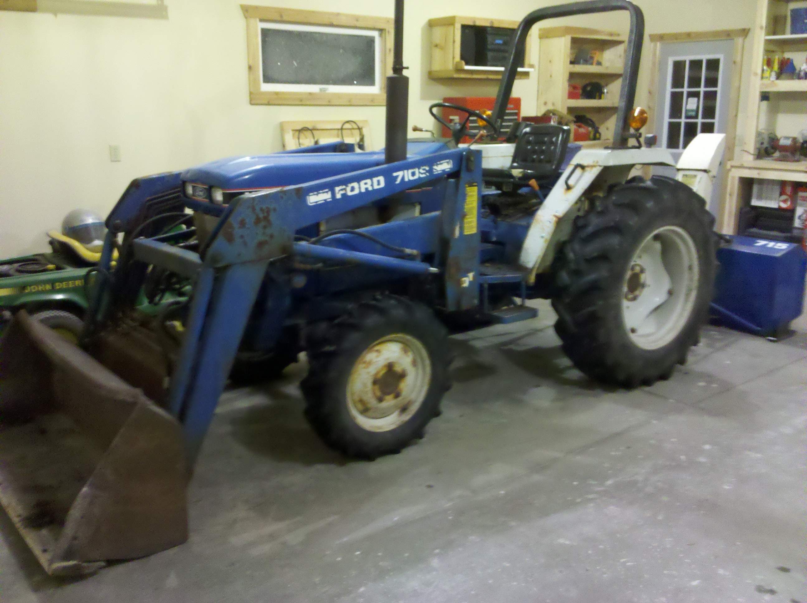

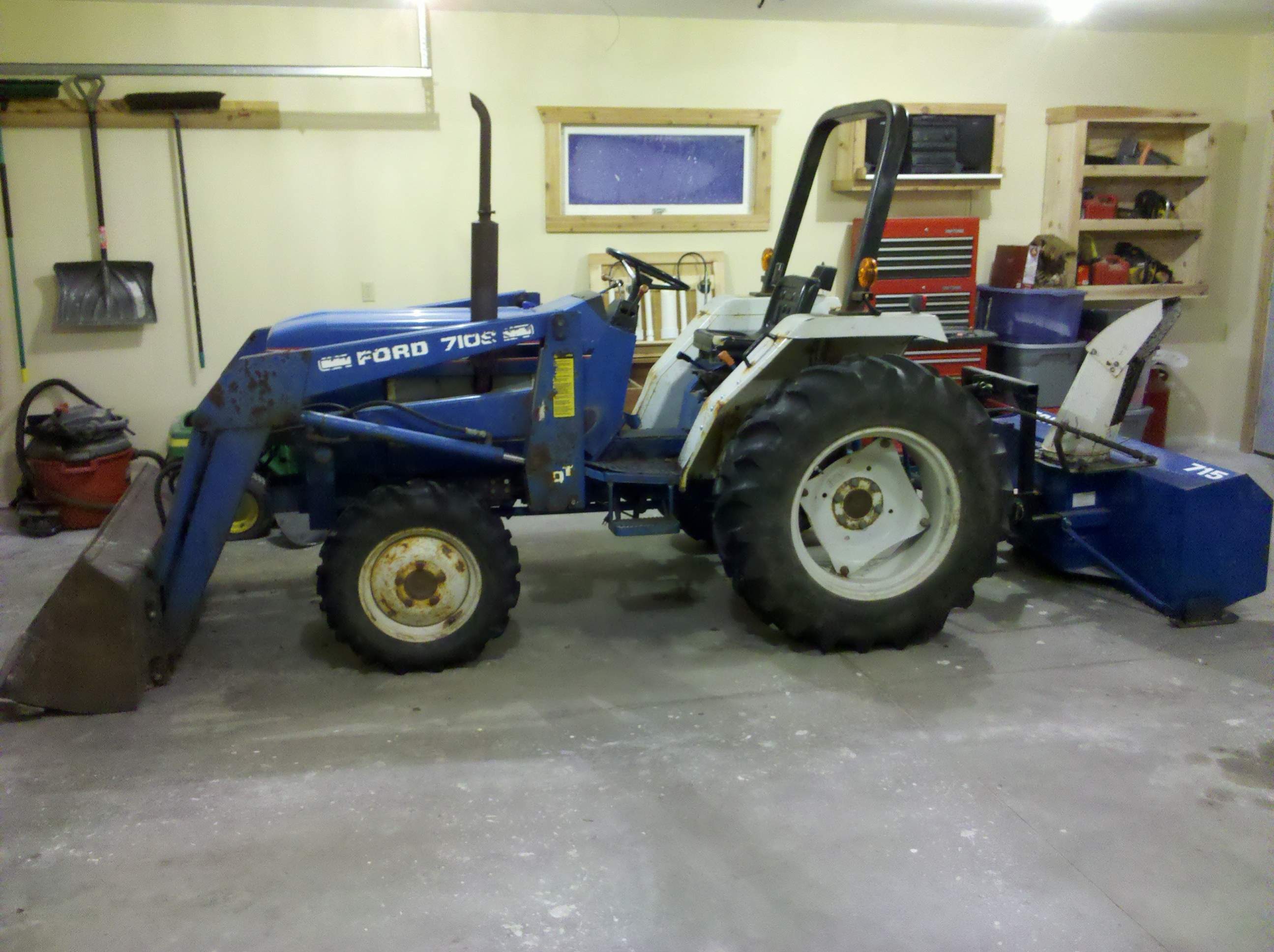

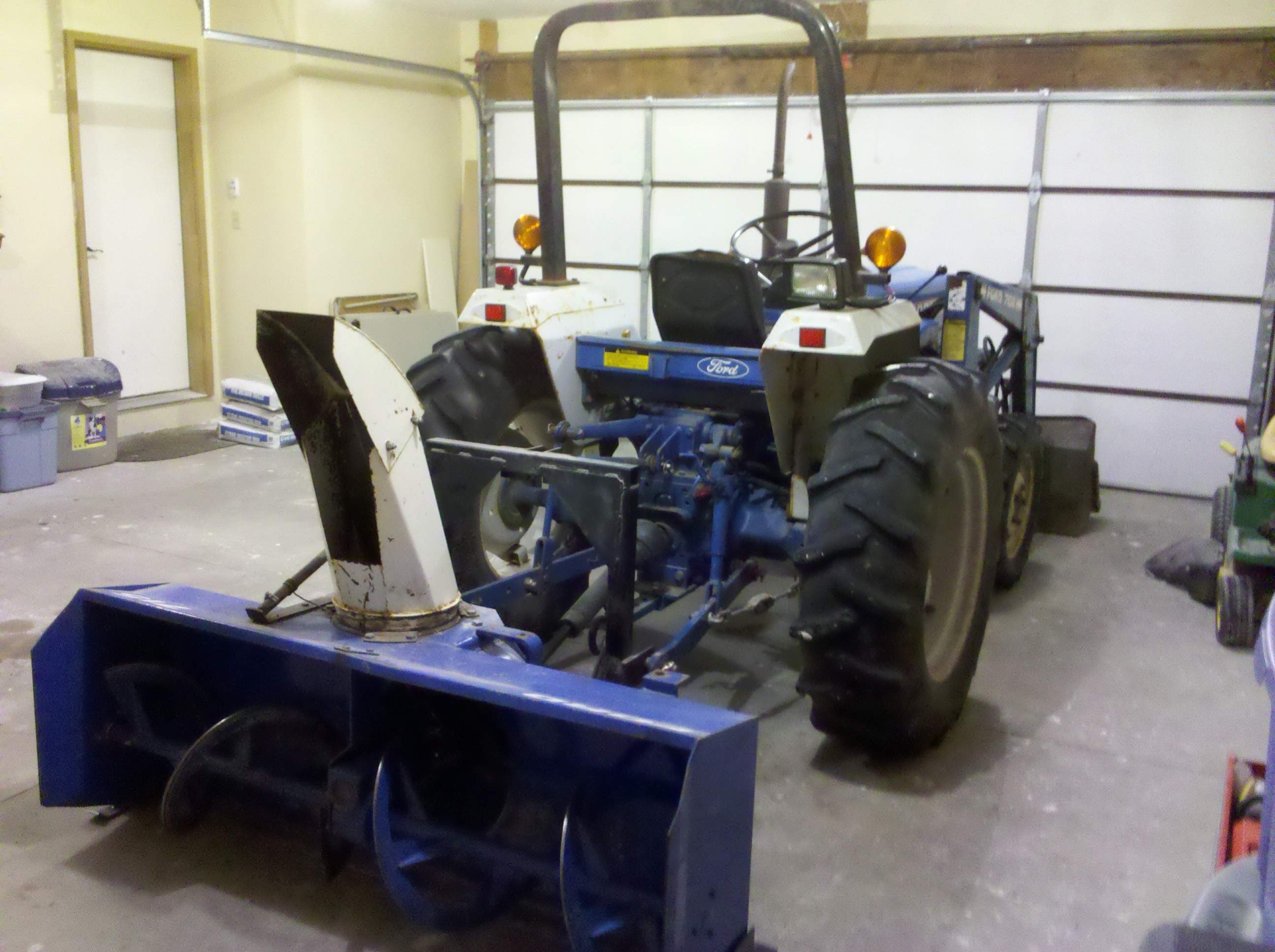

Thanks again for all the advice. Since purchasing it, I have put new glow plugs in, added a block heater, and treated the fuel so I am all set for winter. Here is a couple photos. All we need now is some significant snow and it will be playtime! :thumbsup:
