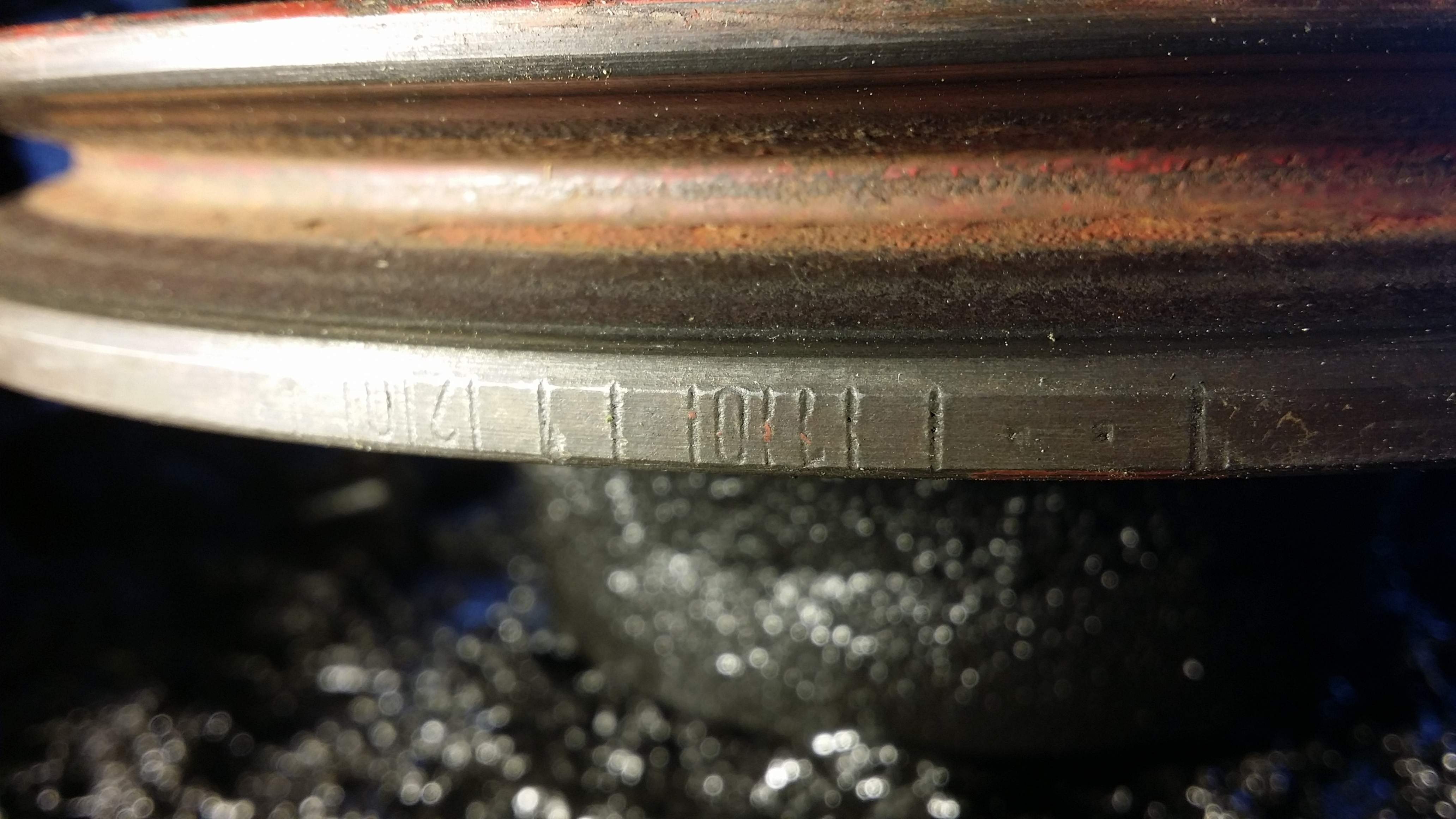

Hi Guys.
I found these marks on the pulley of my ih684 and took a picture.
Which mark is TDC.
I * * I I 1 I 0 I I I I 2 I 0 I I I
   / Timing marks on 1978 IH684 #6
where is 20deg BTDC........IN THE MIDDLE OF THE 2 AND 0
............10DEG btdc .........IN THE MIDDLE OF THE 1 AND THE 0
Ihope that this will help finding TDC

   / Timing marks on 1978 IH684 #8
Engine........D-239........Timing Advance......static timing-engine, degrees BTDC = 16
   / Timing marks on 1978 IH684 #9
Now for the next bit off info.......Open up the pumps window and turn the engine until the marks in the pump line-up .........the check on the frontpulley where the pointer lines up with the timingmarks . If at 16BTDC .........remove the pump........if not.........thats how it should be returned
