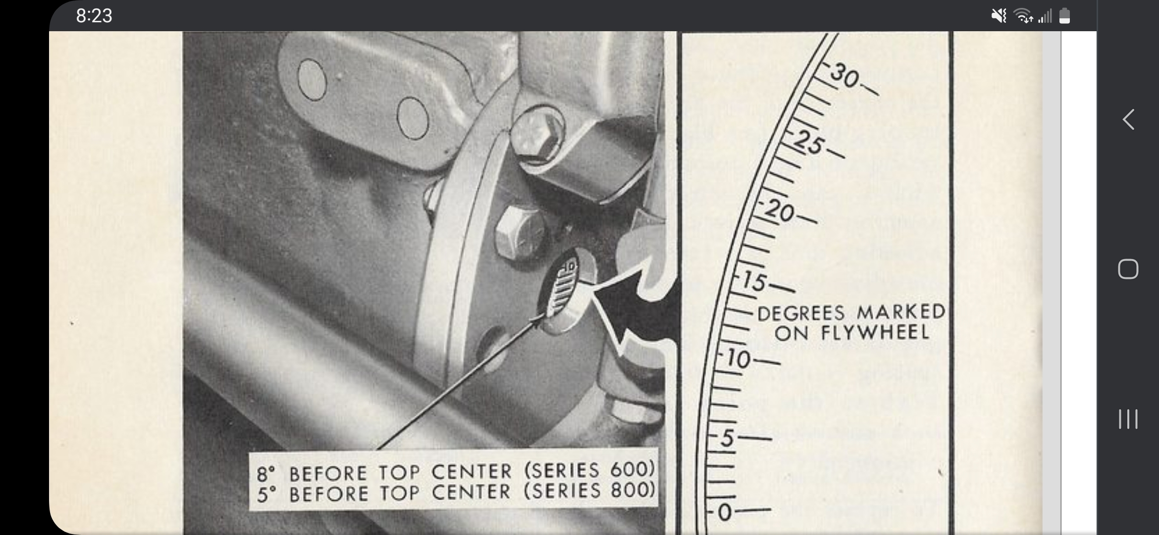

I can not find where to look for the timing marks so I can find 4deg before TDC. I found on the 600's none high crop there is a peep hole put I can not find a hole any where on mine.

If you can't find the marks through the insoection hole, take the starter out and then use that larger opening to look for the flywheel marks

Thanks for your picture. it made me look harder. IT was there. Shame on me. thanks again
