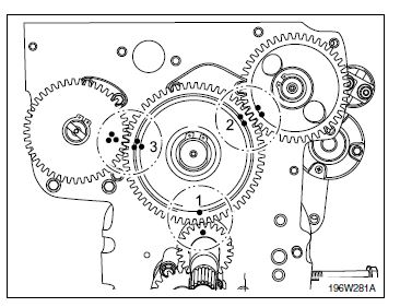

I've seen some of the smaller engines w/ inj. pumps like yours that have "2 marks" on the front "PULLEY"..{removable pulley}
1 for engine "TDC" & the other for "Inj. Pump".. Both lines about a 1/2" apart..{probably 1 tooth}

Sorry for my ignorance on these type systems I'm used to old Massey 35 diesel and old gas tractors. So it takes me some time to understand why these type diesel tractors are this complicated. But I'll get if you can bear with me
I sent you a PM a week or so ago, I can send you a pdf of the engine disassembly and assembly, but his might give you what you want.

There is a flywheel timing mark window on side of the flywheel housing, I "think" it is on the RHS on CK20. If equiped with a loader the loader mounting frame covers the window and must come off. The front gears/marks align crank, cam, & injection pump to Top Dead Center. Fuel injection timing is done via gasket thickness of gasket between the pump assembly and the governor housing.
Moving the crank gear 1 tooth without verifying TDC mark on the flywheel could very well result in piston to valve contact, damaging valves &/or piston.
