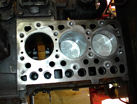

   / timeing gear setup on a kubota 3 cyl diesel #3
I had to put new rods, pistons and rings in my Kubota l2500dt so I know what your talking about on the price thing. It was a little over 700.00 dollars. In my shop I have a manual and can scan and send you a copy of timing proceedure if it would help you............rc

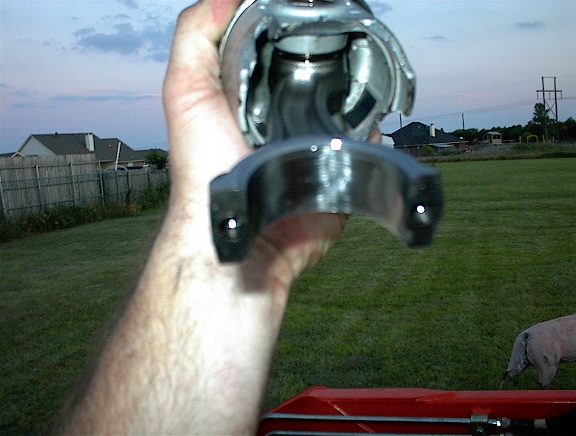

   / timeing gear setup on a kubota 3 cyl diesel #6
The engine that I had to work on only had 300 hrs. The previous owner had run it through a pond and took water into the intake and bent two rods. When the shortened rod came down it broke the bottom off of one of the pistons. Figured I might as well put all of the rods rings and pistons in it while I was at it......rc
