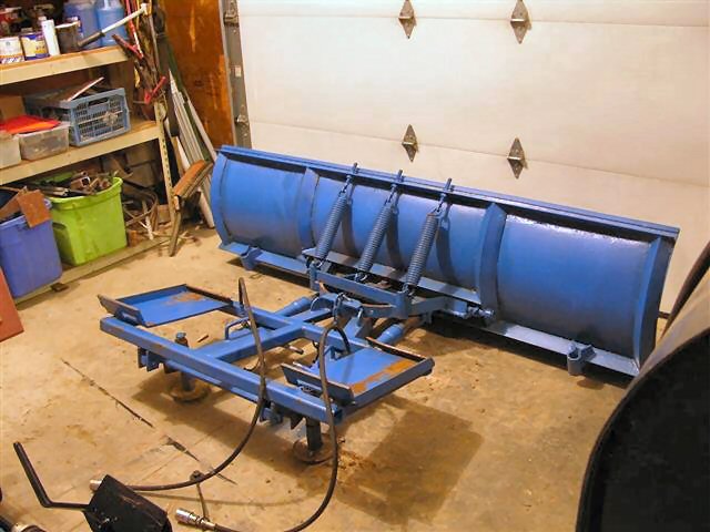

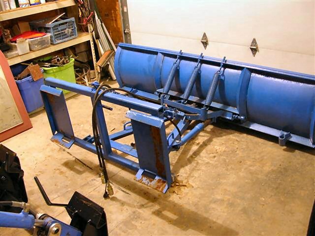

Ever since I converted a Myers snow plow to work with the TC-40D-SS my snow removal duties have been much, much easier.
However making the hook-up to the tractor has in the past always been somewhat of a challenge.
Here's what the plow looks like as you pull up to it with the tractor.

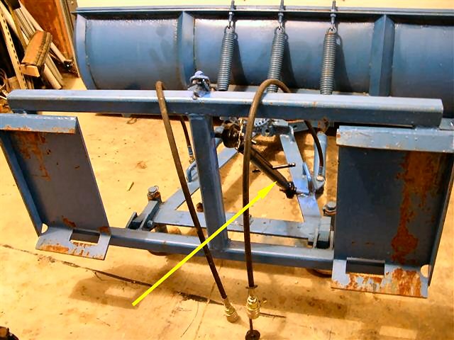

Herein lies the problem. If you don't get the tractor square with the plow the 1st time around the QA on the plow simply falls over. :(
Sometimes you need to get off the seat 3 or 4 times to get it right.

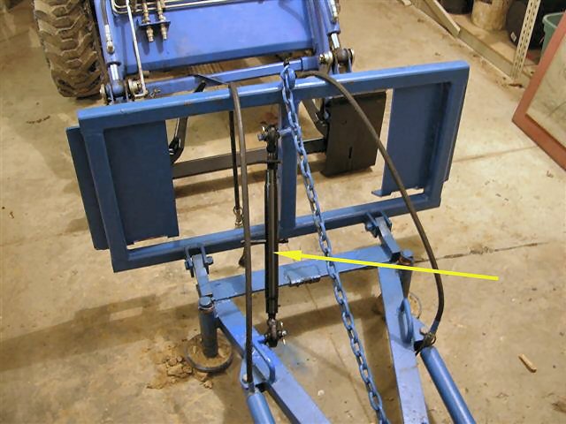

I happen to be digging through one of my scrap steel bins the other day when I cam across the old adjustable top-link that came with the TC-40D-SS and a light bulb in my head lit up.
Why not weld a couple of pins to the plow frame to temporarily mount the adjustable link like this.
   / Time to hook-up the snow plow UGH!
Now I can move up on the plow and gently bump it to square it off, & make the attachment without the QA plate hitting the floor.
Then when I jump off the seat to lock the QA I simply pull the 2 spring pins on the adjustable link, slide the link off so the plow can once again pivot and I'm good to plow.
I set the adjustable link on the mat next to my feet as a reminder to replace it before disconnecting the plow.
Thought maybe a few others might have a similar situation. Also a piece of steel with 2 holes drilled in it could just as easily be used instead of an adjustable top link like I used.
