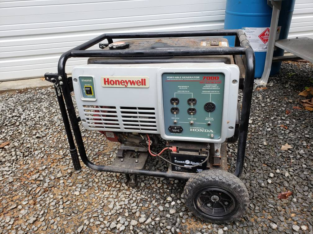

I picked up an nice Honeywell/Honda generator a few months ago since the new house doesn't have a standby yet. Had to clean pull the bowl and clean it but otherwise its a good runner.
Still need to change the oil and make up a cord to connect to the gen panel.
My plan is to try to do a monthly run for about 15min.
