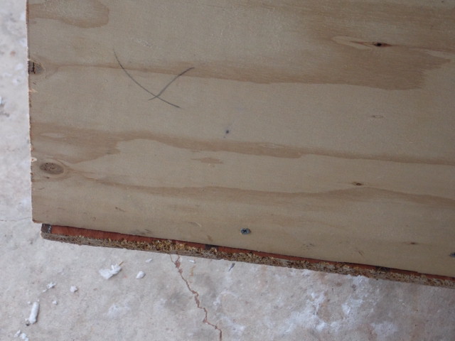

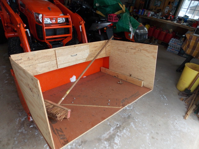

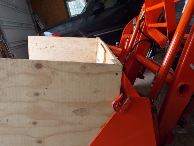

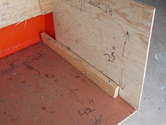

Oldballs,
I know that the leaf scoop looks Mickey Mouse. I made it out of scrap lumber. I level it to the ground and rake leaves into it for easy dumping. Then when I move firewood, it gives me probably 3-x's the capacity of my bucket. I posted some pics before with the dimensions. If you make one, leave about 1/2" clearance on the ends. The sides tend to swell out and the whole thing gets stuck in the bucket.

Thank You so much AStanton....I'm going to copy your work for now and try and get the box built before next fall.

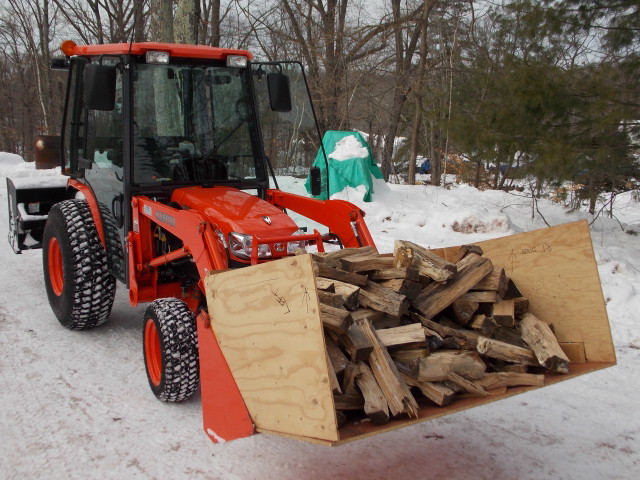

Oldballs,
There's no right or wrong way to make one, just have at it. In calculating the amount of firewood mine can move, I figure it moves about 1/6 of a cord modestly filled.

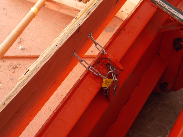

Is the only thing that holds it in the chain wrapped around the bucket hook? That's pretty nifty.
   / Time to Chain Up the Kubota
#29
Yes, that's correct. I had to beef up the mid section of the cross brace twice because it had cracked. I could always add a fastener to each end. But I prefer the KISS motto: keep it simple stupid.
