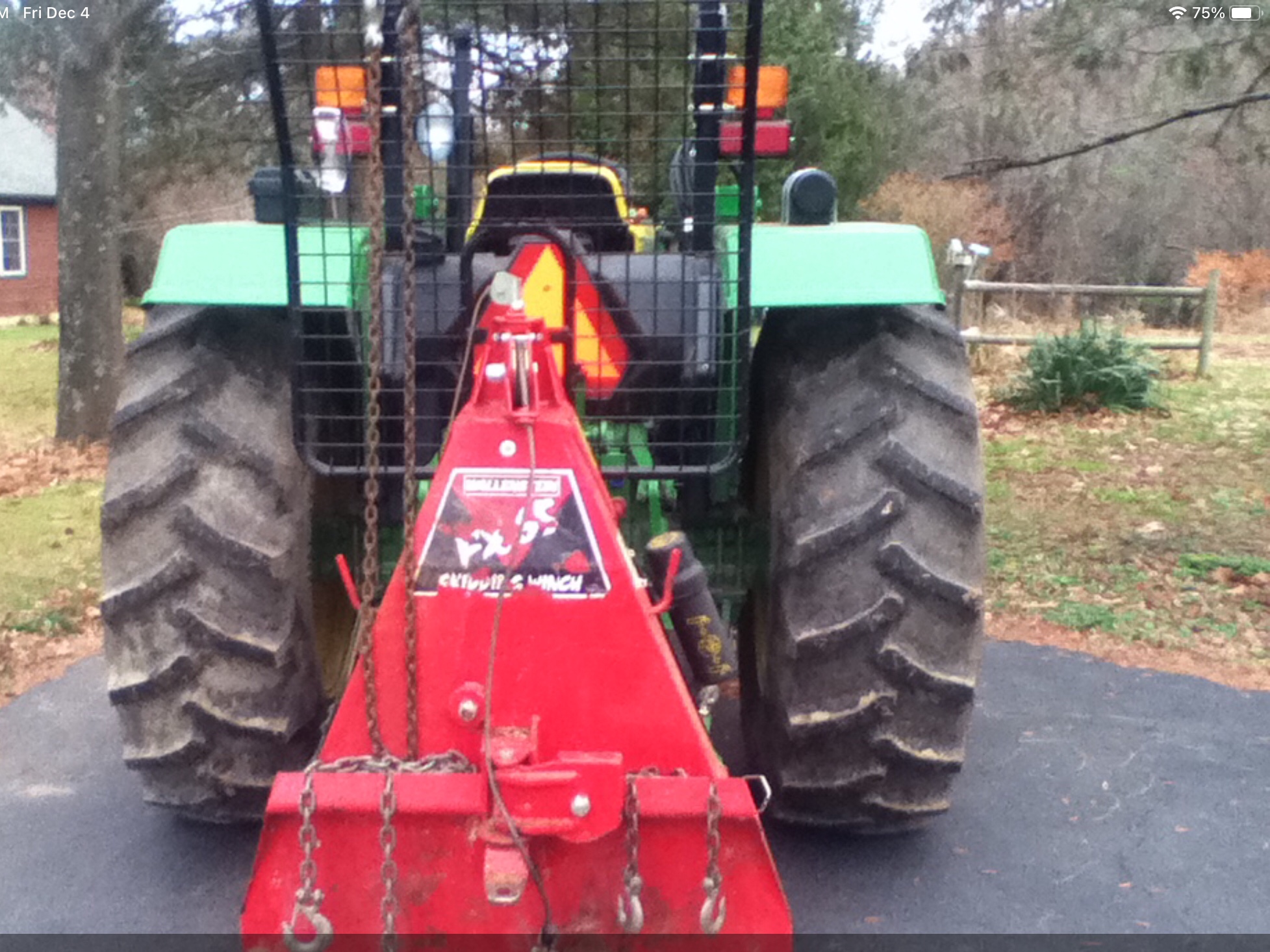

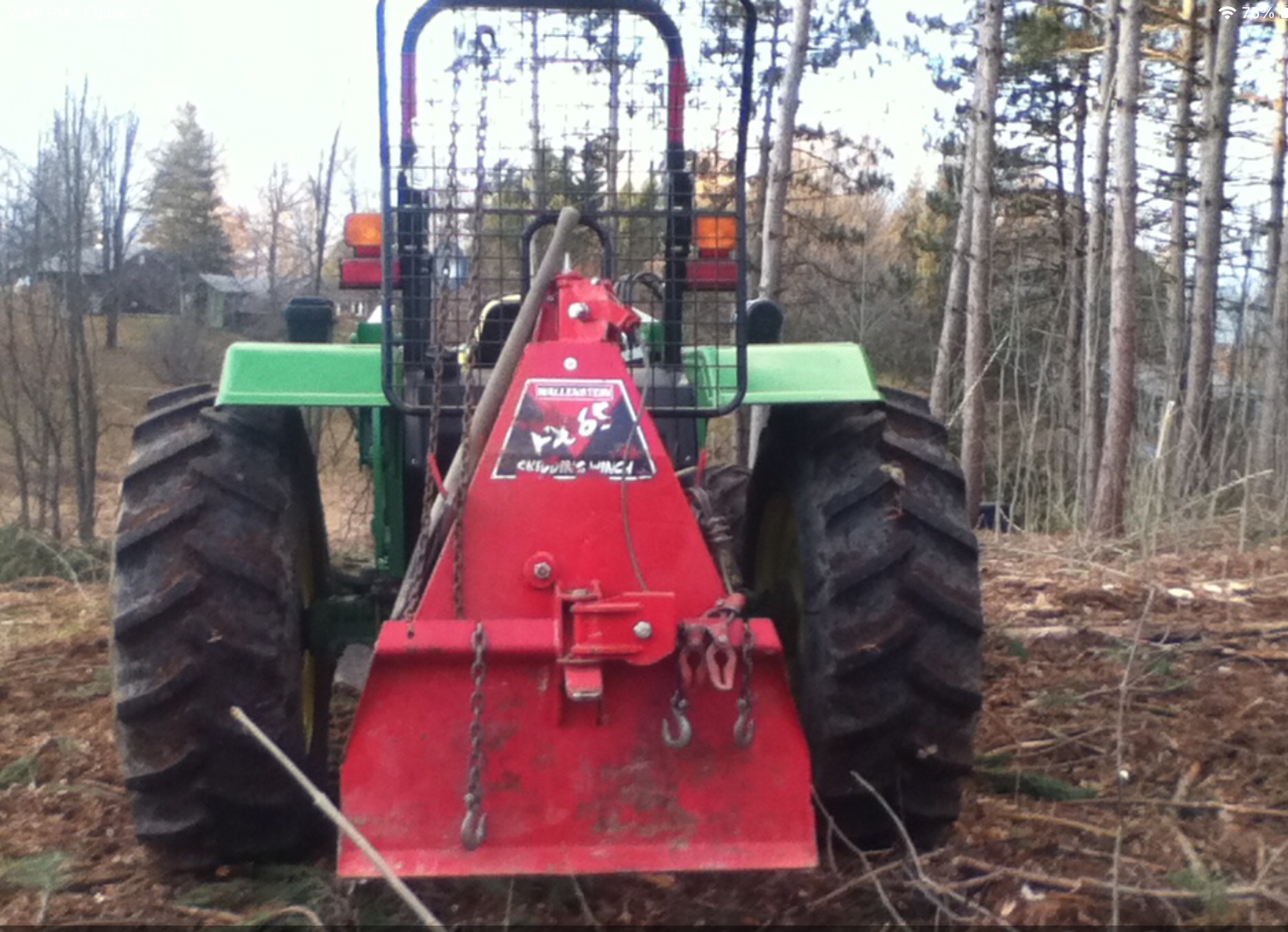

Go as wide as you can and load tires. Your center of gravity is probably 10” above the height of your rear axle, in the center of your tractor. Standing behind the tractor, you can imagine what angle of tip it takes before this spot passes over the outside edge of your downhill tire and you roll (Not counting dynamic forces).
I have a utility tractor with adjustable rims. When I first got it, it had loaded tires, but I would still feel really queasy and I’d often chicken out on slopes. Can’t remember exactly, but I widened it an additional 7.5” or 10.5”.
Night and day!
Now I feel I could go almost near verticals before it would roll. I know I’ll either chicken out, will get uncomfortable trying to hang on, or it will slide (which can be its own danger) before it’s in any real danger. Of course as one gets more accustomed to that feeling, that can be bad too.
