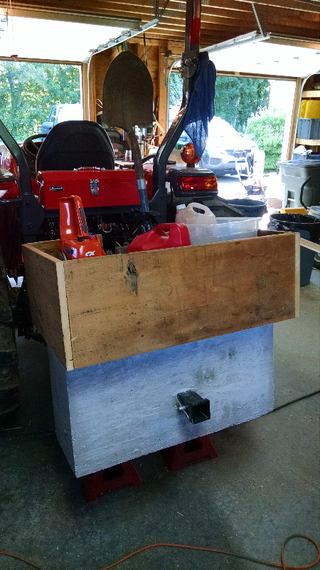

Can we get a closeup of the break? Looks almost like its been broken on one side for a while and it got enough force on it to bend...

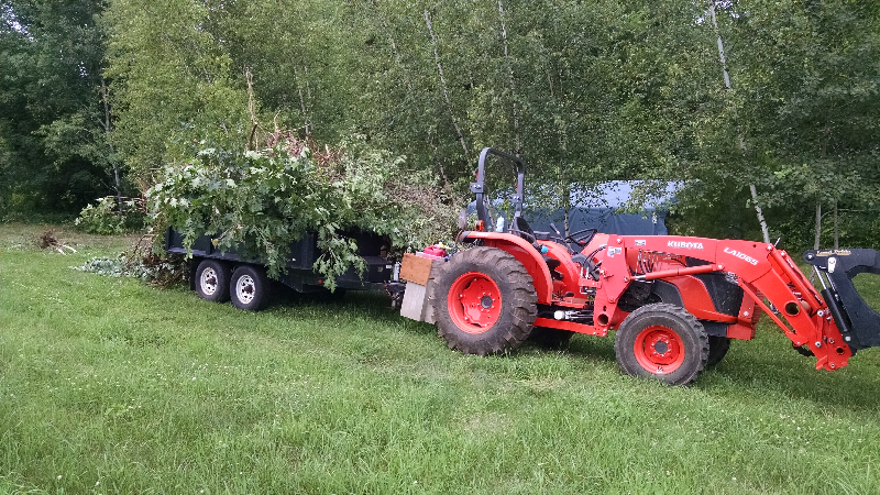

You are correct that it most certainly not with that load. Just some old pictures.

#29
Aaron Z
When back and looked at my origional post and see what you're looking at but it's actually not cracked, only bent.

#30
I suspect part of the problem isn't so much being overloaded, but rather picking it up too high with the 3ph. The trailer is far too small to hold enough weight to bend that hitch, if it was used as it was designed to be. When lifted too high, it changes the angle that the force is being applied. Get a new, decent quality hitch and don't pick it up so high. Pintle hitches are made for hauling loads like dozers and such, not an 8'x12' farm trailer.
